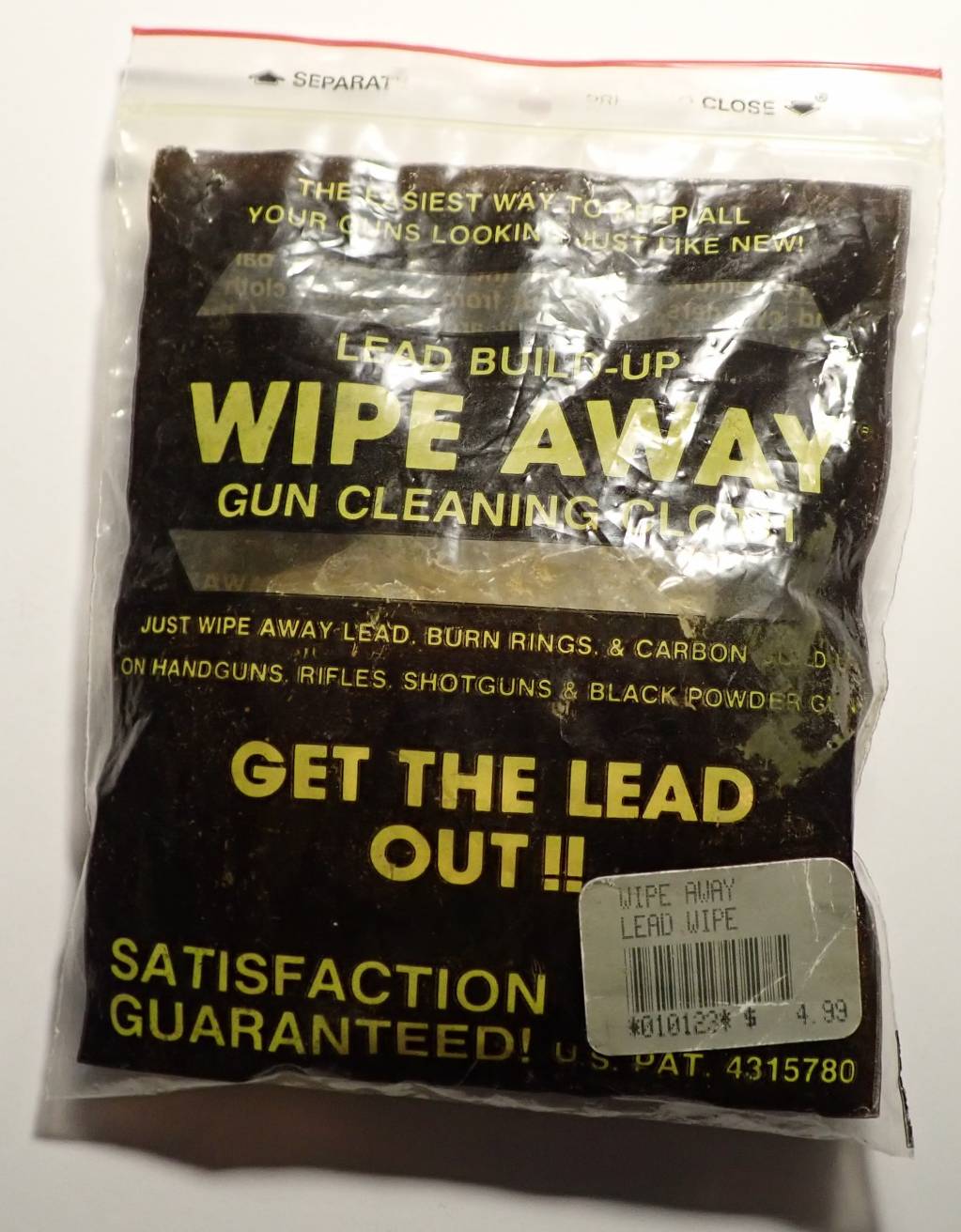

Okay, I went back and cleaned it again. I don't have any JB, so I used Wipe Away. If you're not familiar with it, it is a yellow cloth impregnated with a very fine abrasive that is very good at removing lead. I especially like it to clean the front of the cylinders of revolvers. After pulling the Wipe Away patches through, I pulled patches with Goo Gone on them and then dry patches. The probe's o-ring was dirty, but in great shape. I cleaned it up along with the moderators o-ring. With the gun in a vise I shot 50 pellets through it to season the barrel. Unfortunately, the kids behind us are in their pool so I can't test it outside today.
