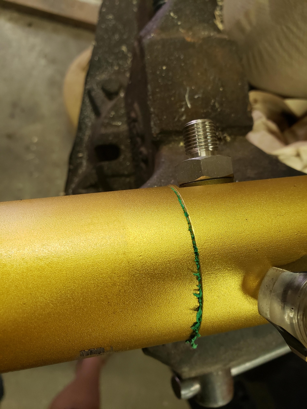

Tonight when I went to fill my tank my compressor would only go to 580 psi. After looking it over I saw this green oring seal blown out of the filter body and leaking air. .
Do these two bodies just unscrew. Because if they do they are extremely tight. I figured this would be an easy fix but maybe not. I will contact hatsan on monday but for now I would like to get it going. It is under warranty but I do not want to send it back for something like this.
Any help is appreciated.
It seems that you have clamped the right side on a vise. May be you can try using two strap wrenches on the other side ?

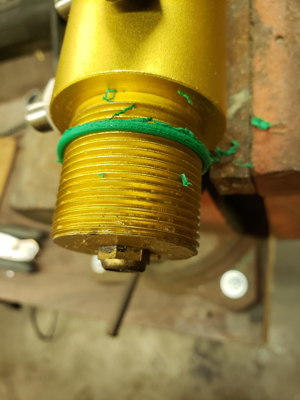

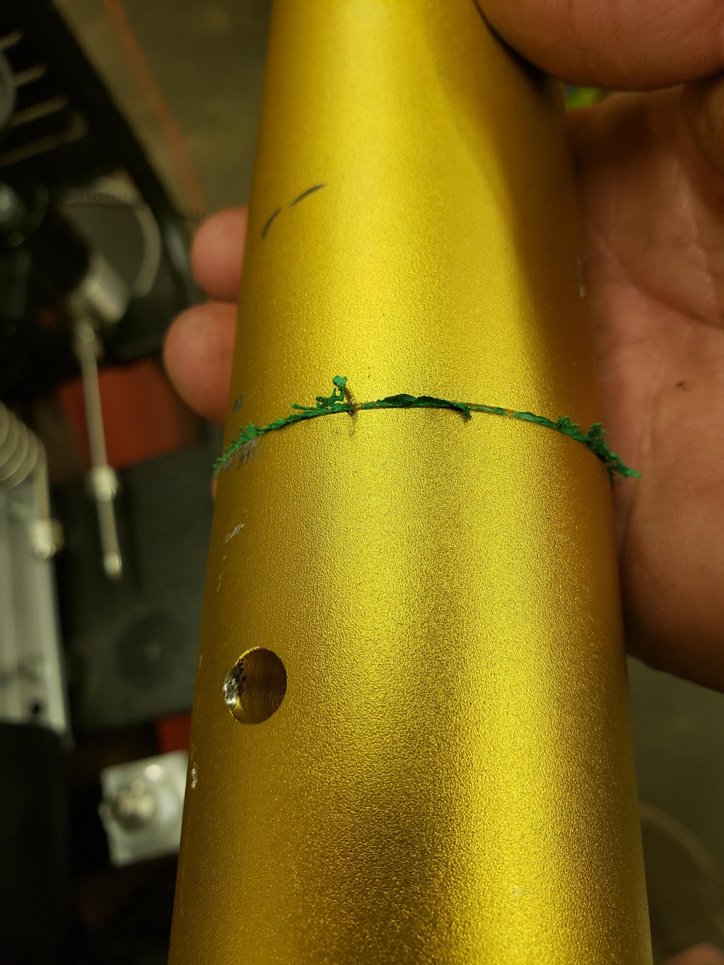

O ring being squeezed out like this is abnormal. The photo is showing a significant gap at the joint . I bet it's already there when the compressor came. It's likely due to part of the O ring not fully rested into the seat . I have seen that happening on my gold filter when I tighten the end cap. Checking for this before tightening should prevent the reoccurence of the problem.
Hi Bigragu,

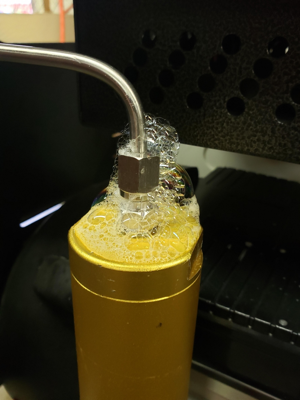

There wasn't any sort of lube present on the orings as you can tell from the pic. I also believe it was cut when it was installed at the factory. However, after all that it still wasn't building pressure. I did not look for the leak with soapy water before I tore it down as I just ASSUMED that was the problem area since the oring was sticking out.. Well I found the fitting on top of the filter is leaking and after several attempts to get it to seal I just gave up. The ferrule is distorted and has a ring in it as it looks like the line was a little crooked when it was originally tightened down. I contacted Hatsan this morning and am waiting for a reply. I would like to get both new fittings and a line with ferrule, plus I want to get more orings and filters for future use.
Funny thing is this worked fine last week and now it just goes to 580 psi before and after I tore it apart.
Randy, I’m not there so I don’t know how distorted that ferrule/fitting is, but try this, and when you do get the new parts from Hatsan, do the same:
connect the fittings onto the filter first(a tad loose just to allow swivel movement) before you bolt down the filter canister, then tighten down the fittings after.
These hard lines are like brake line fittings on cars, and they have to be installed perfectly with no tilt whatsoever on the hard line as it connects. It’s the nature of the beast with pre bent lines. Might be less than 90 degrees on one line and the next may be a tad over.
