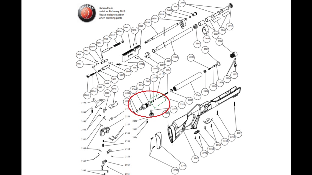

the Poppet O-rings are in the gun end of the Cylinder, so you don't need to take the gun completely apart, (Flash diagram but same air cylinder as AT-44 design)
AT-44 air Cylinder has the main Valve at the end of the air cylinder, the brass part houses Poppet, gun should have came with spare O-rings and Poppet Nylon seal that is in the plastic baggie. Steel poppet.

AT-44 Diagram, not hard to do just make sure you have Silicone Grease or Silicone oil to lube the O-rings, the Poppet is made from stainless steel and the Poppet seal is Nylon, there should be a baggie of spare parts that came with your gun, these parts should be in there.
