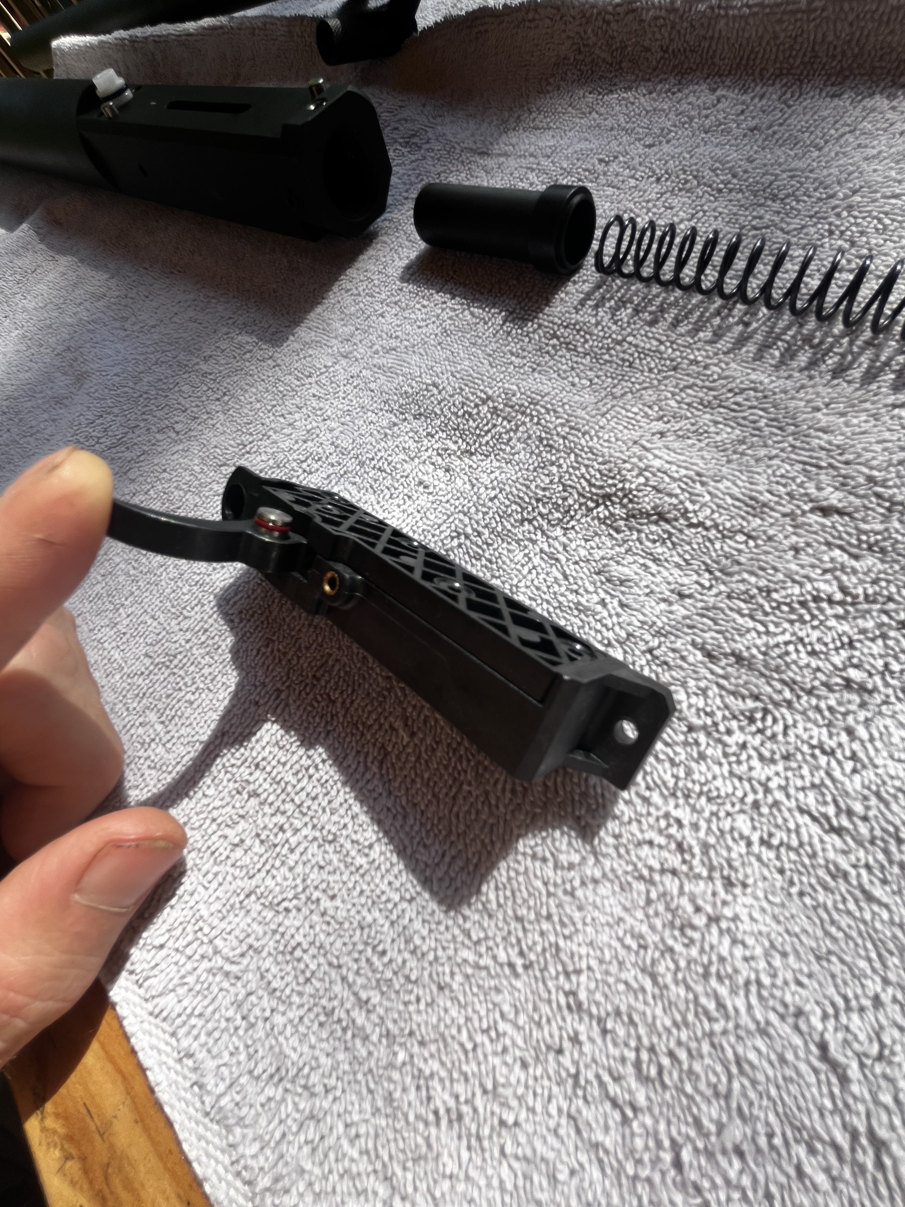

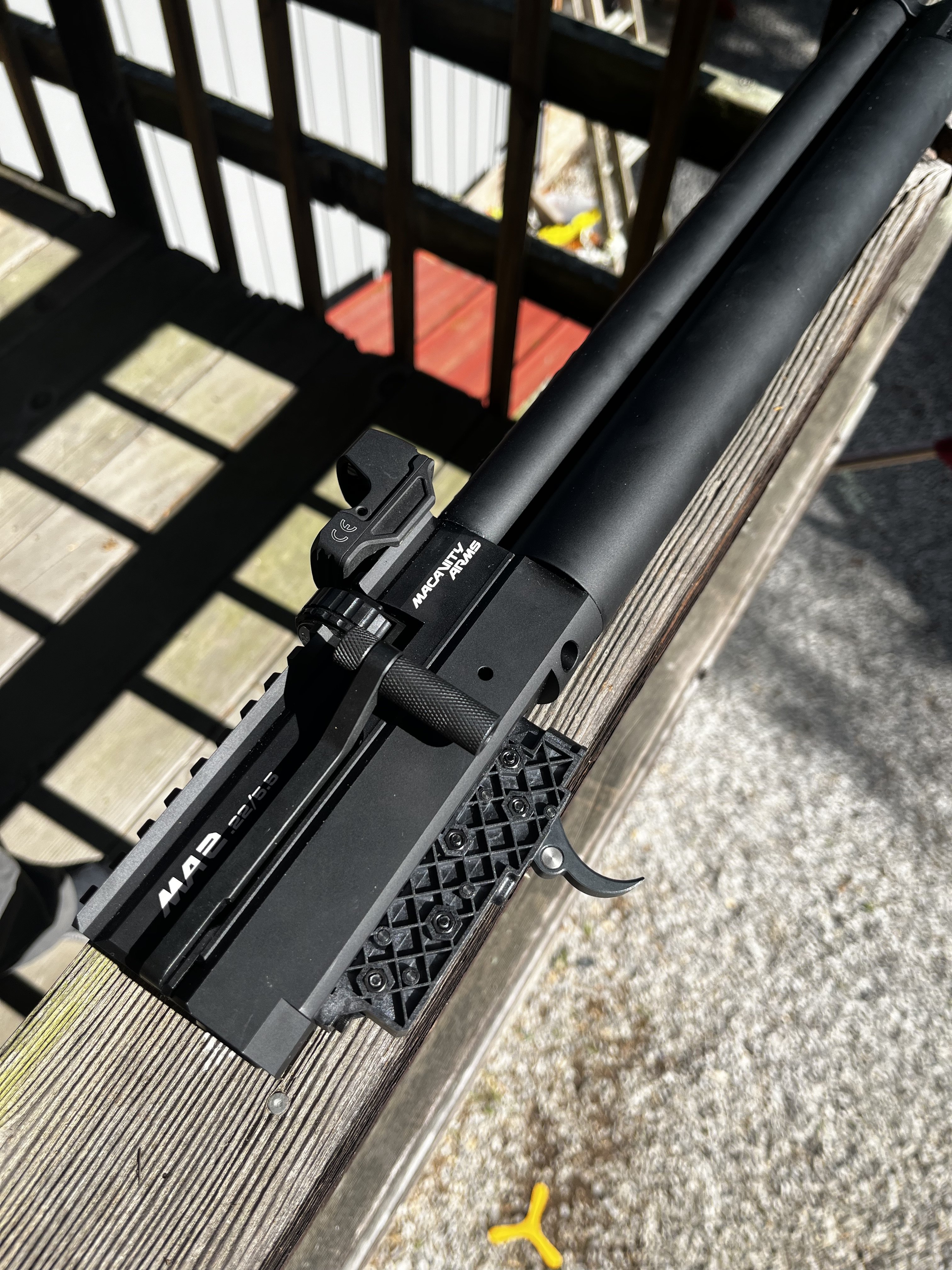

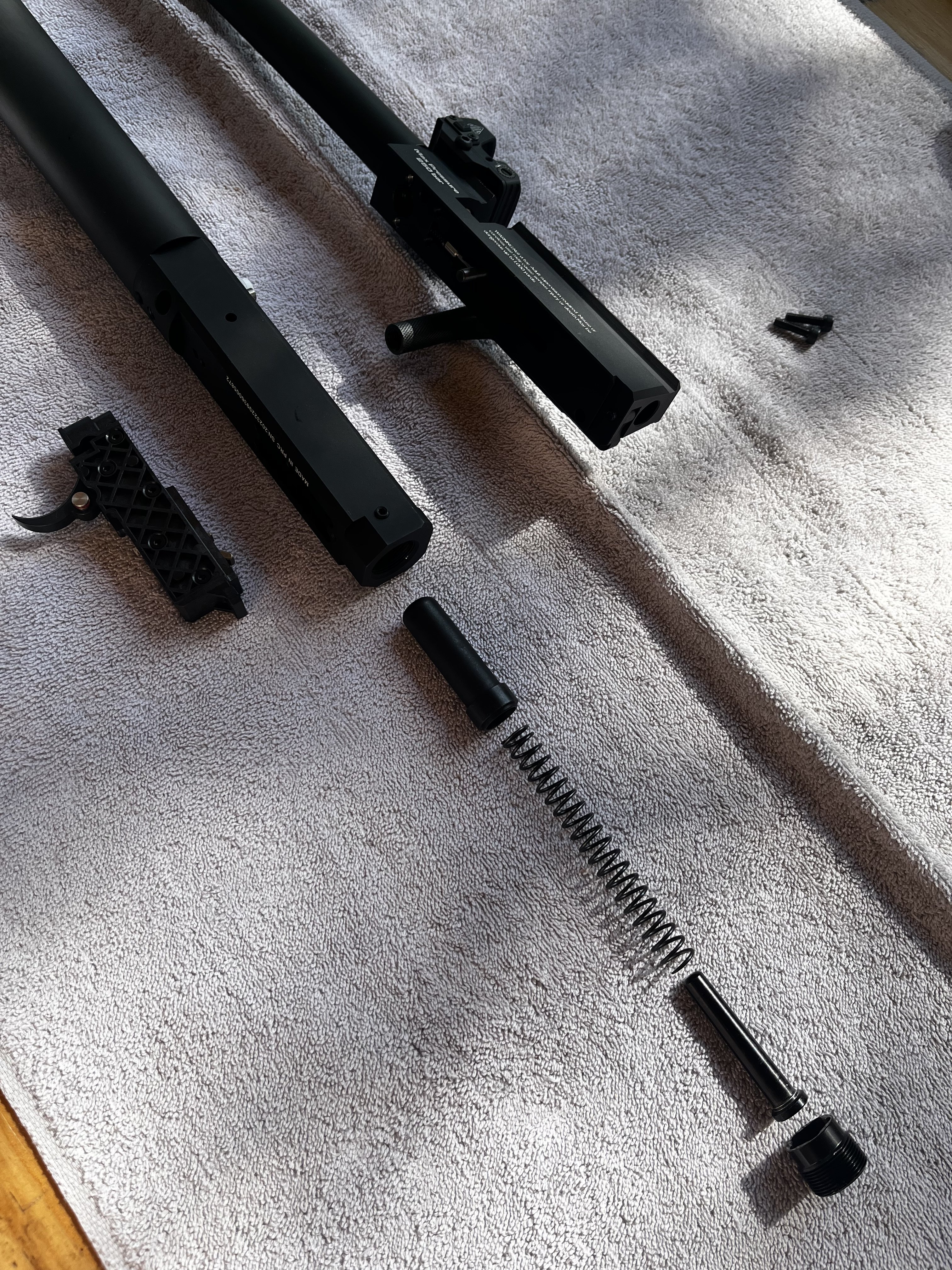

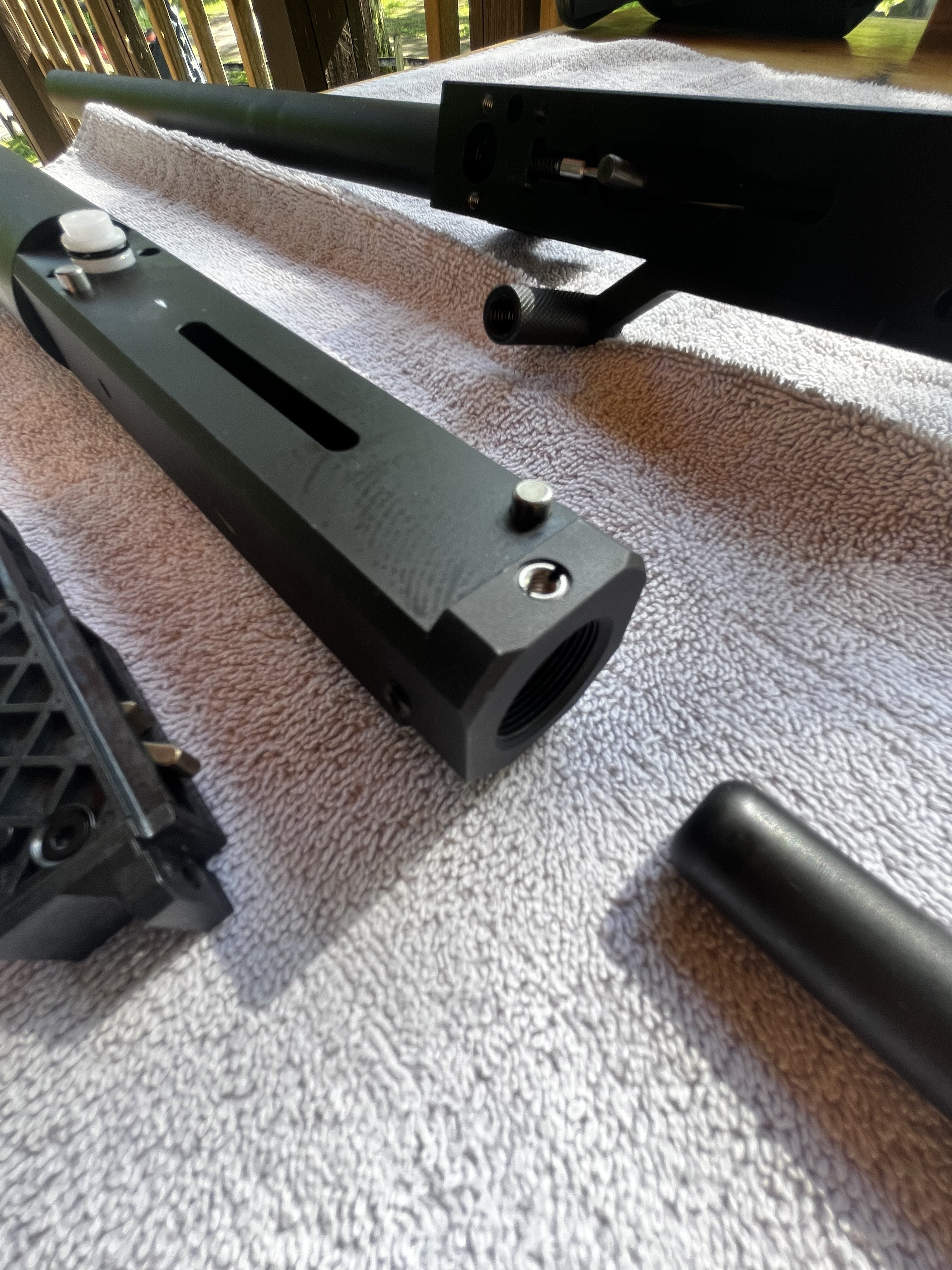

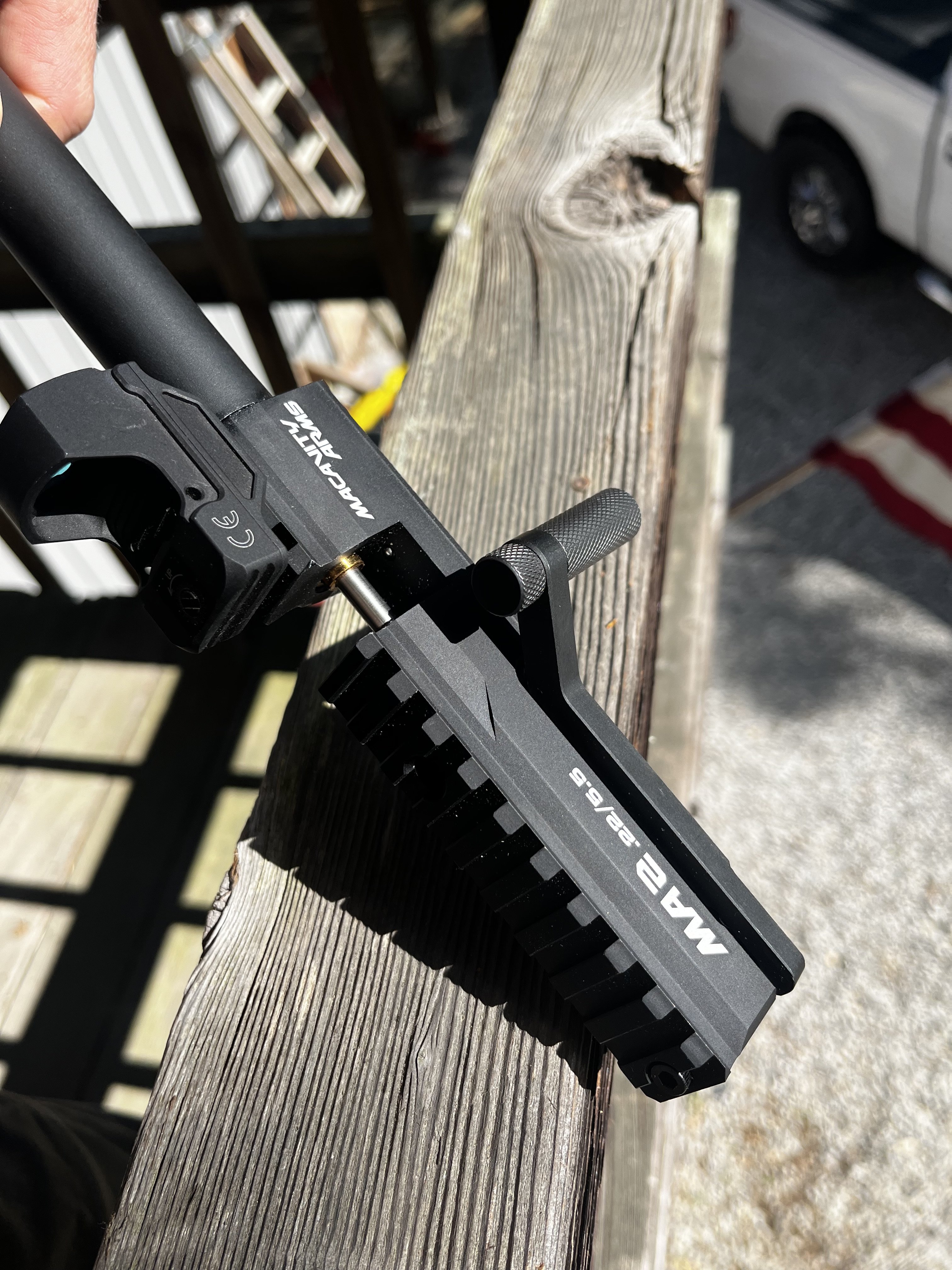

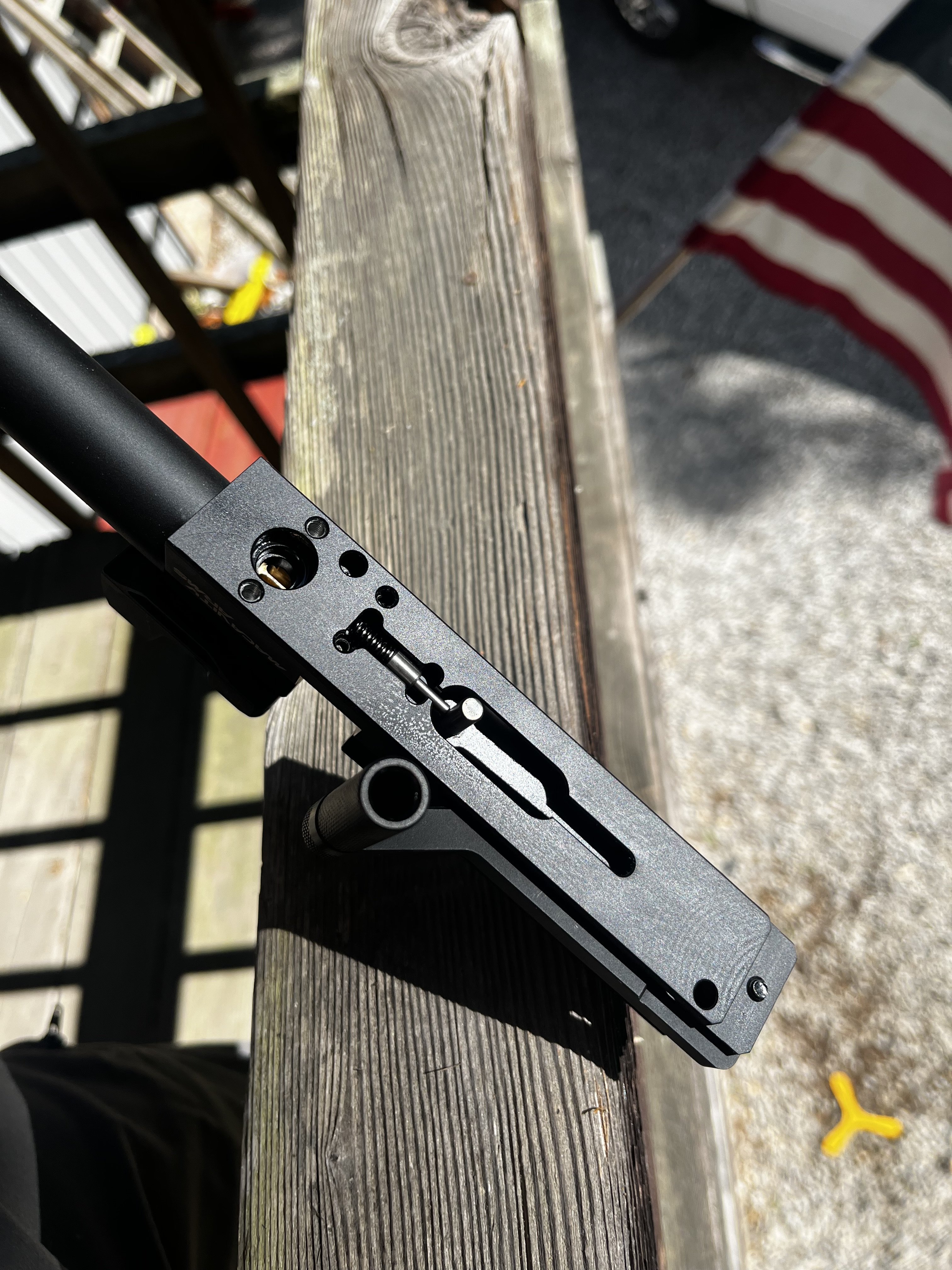

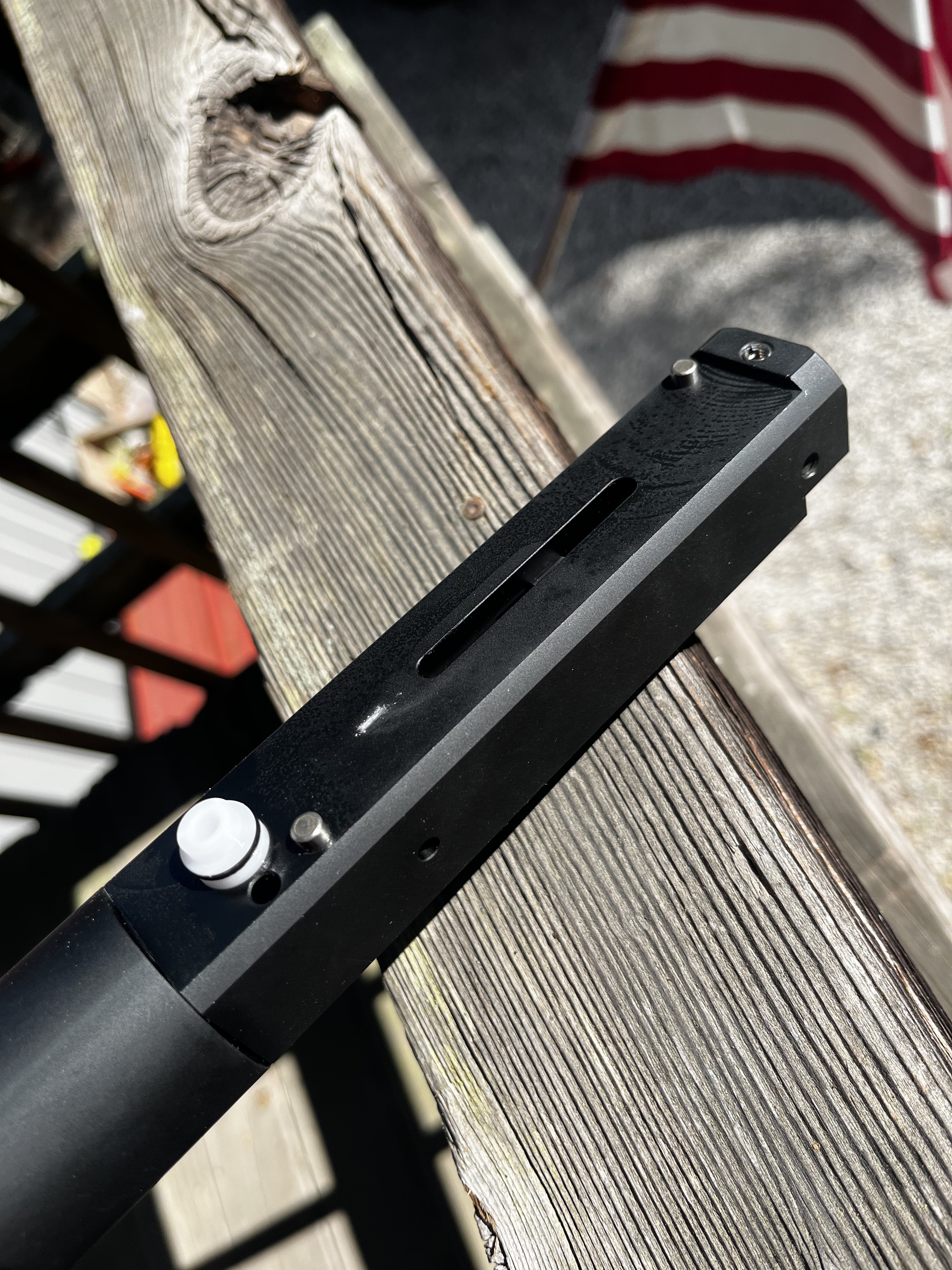

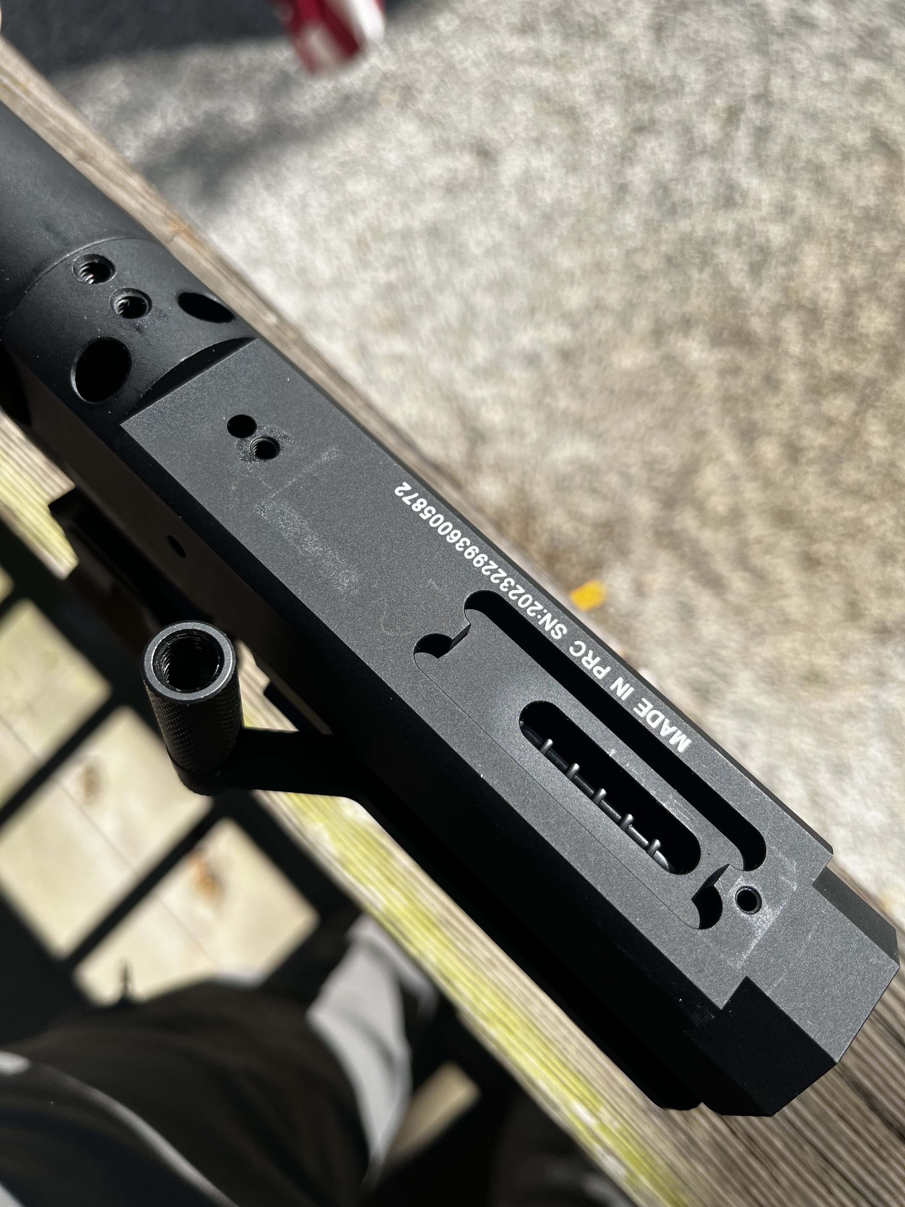

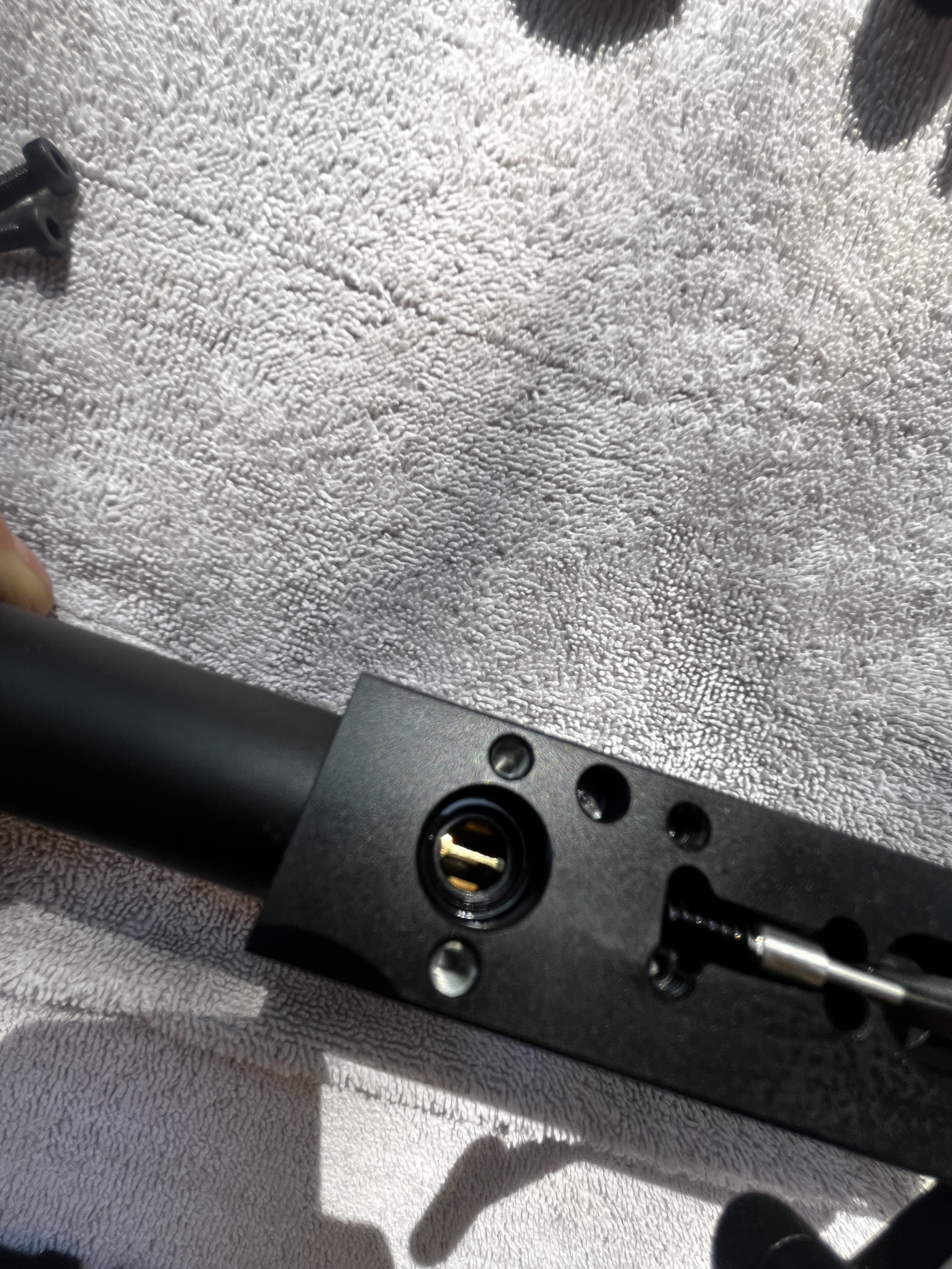

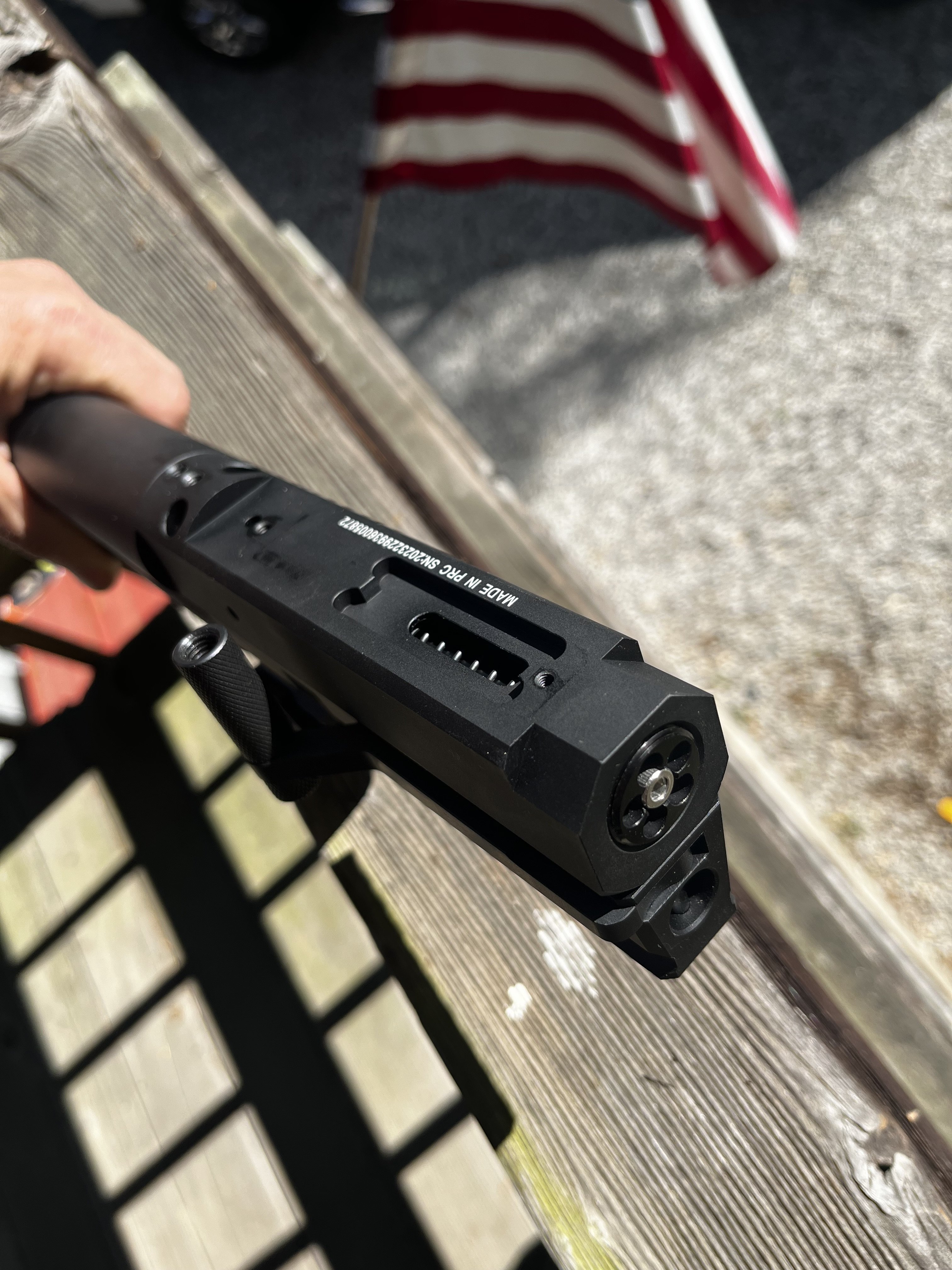

Ok here ya go…

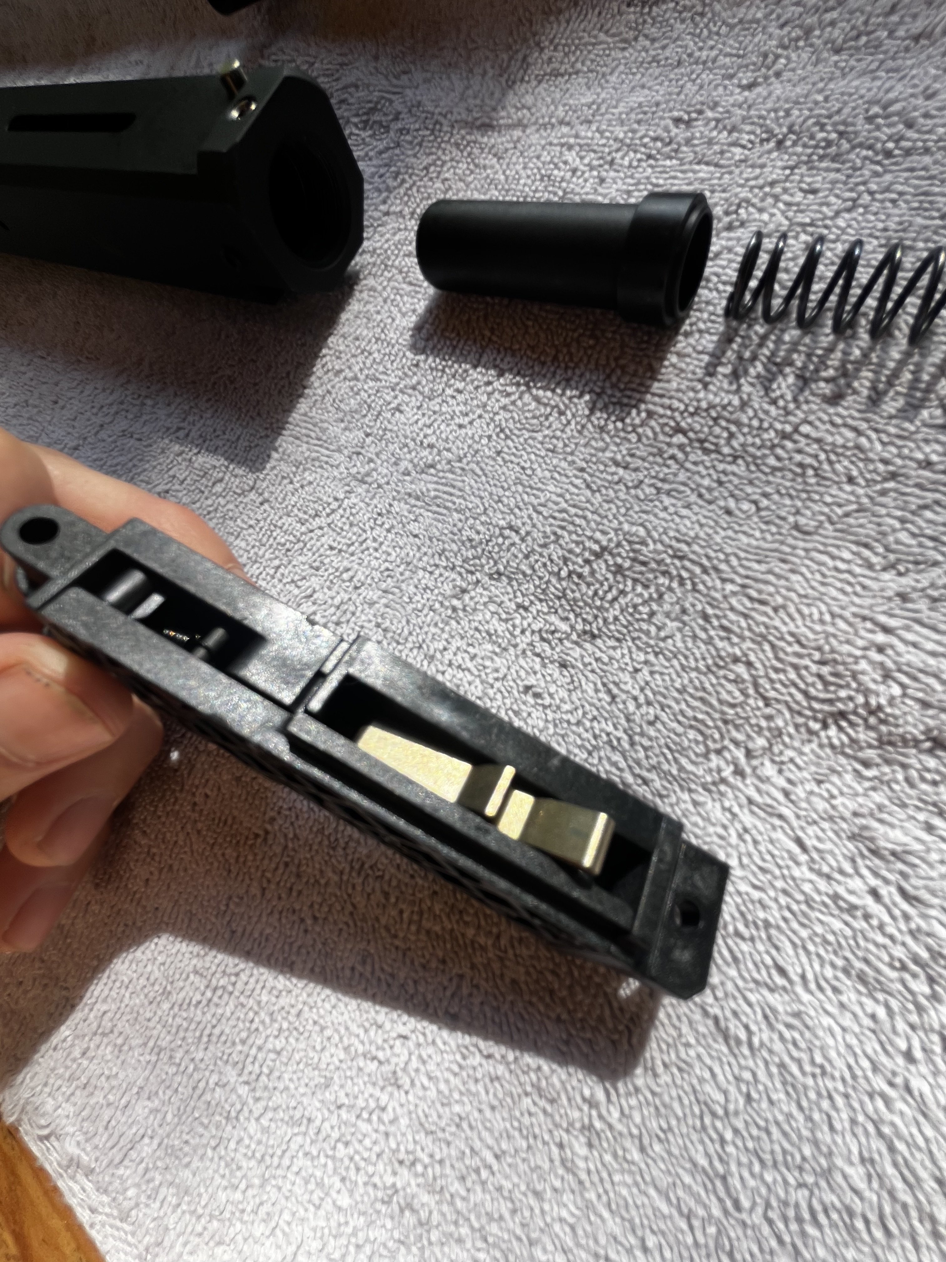

Things I like - all aluminum, well thought out design and construction.
The only plastic is the stock “ which is cheap and somewhat flimsy but serves its intended purpose “
The trigger group housing and the transfer port itself are plastic also, none of which I see an issue with imo.
The barrel threads into the breech and then is tensioned by the shroud. On top of that it has a robust “aluminum “ barrel band and is threaded 1/2-20 for a moderator.
I don’t see wandering POI being an issue if the barrel can shoot!
I really like the alignment pins in the lower hammer housing that help with re-installing the breach.
Side lever is easy and smooth to operate outa the box but it has a long throw to it.
Some might take issue with but it doesn’t bother me at all.
Trigger is not bad, I do plan on adjusting it later on.
Mags function when firing without any issues so far “probably a hundred rounds in”
They are not the best design to load as some pellets need to be seated with an Allen wrench and some fall through the mag.. hopefully CARM can resolve that issue.
Light weight and short makes for a handy rifle in the field.
Shot cycle is a loud unmoderated. Therefore it leads me to believe the rifle is most likely wasting air and shot count may suffer as a result.
Although this may just be typical for 30fpe with a 17” barrel.
Super easy to disassemble and reassemble, only need 3 Allen wrenches to do so.
Here’s a few pics of the rifle partially disassembled… enjoy

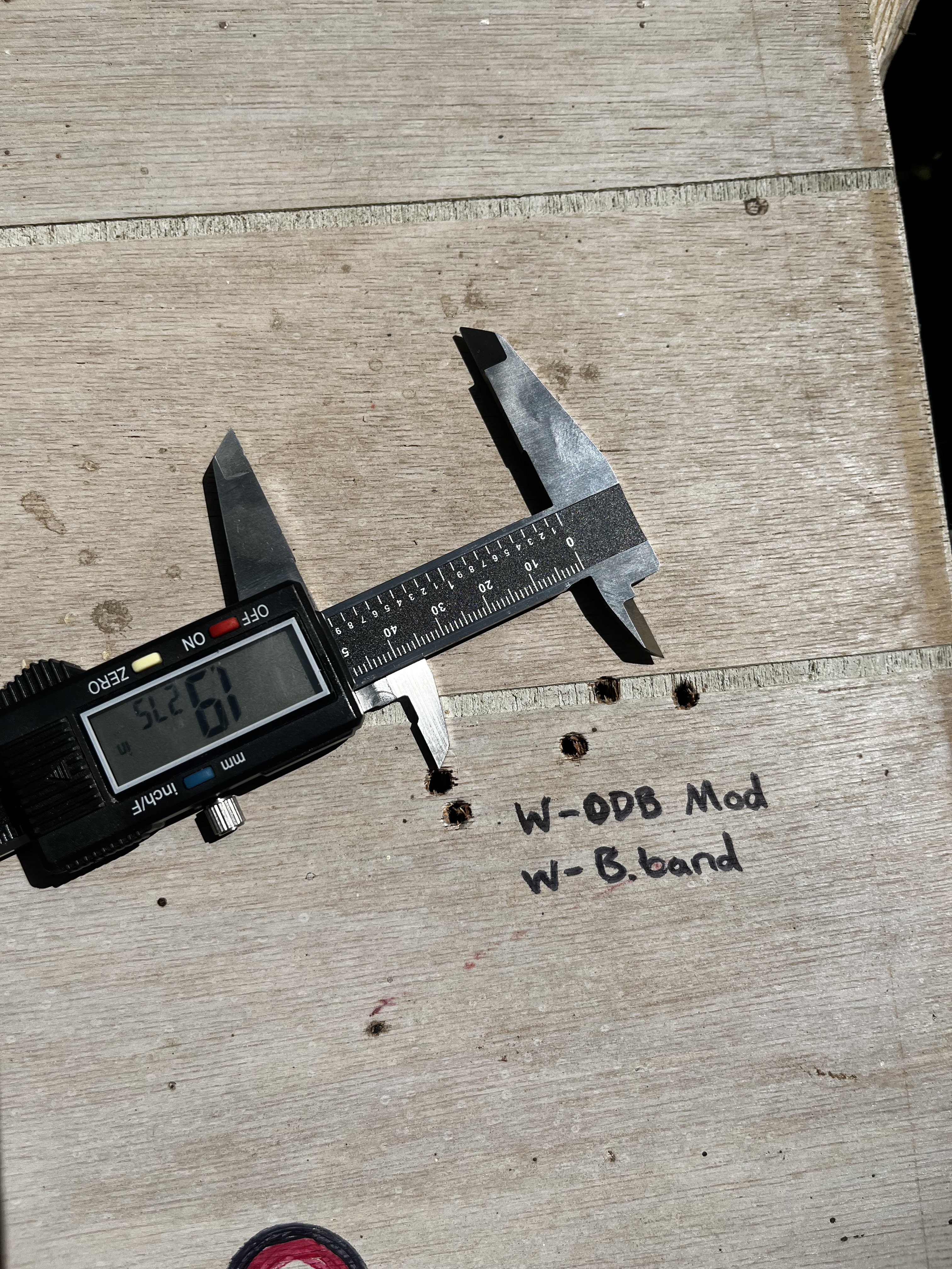

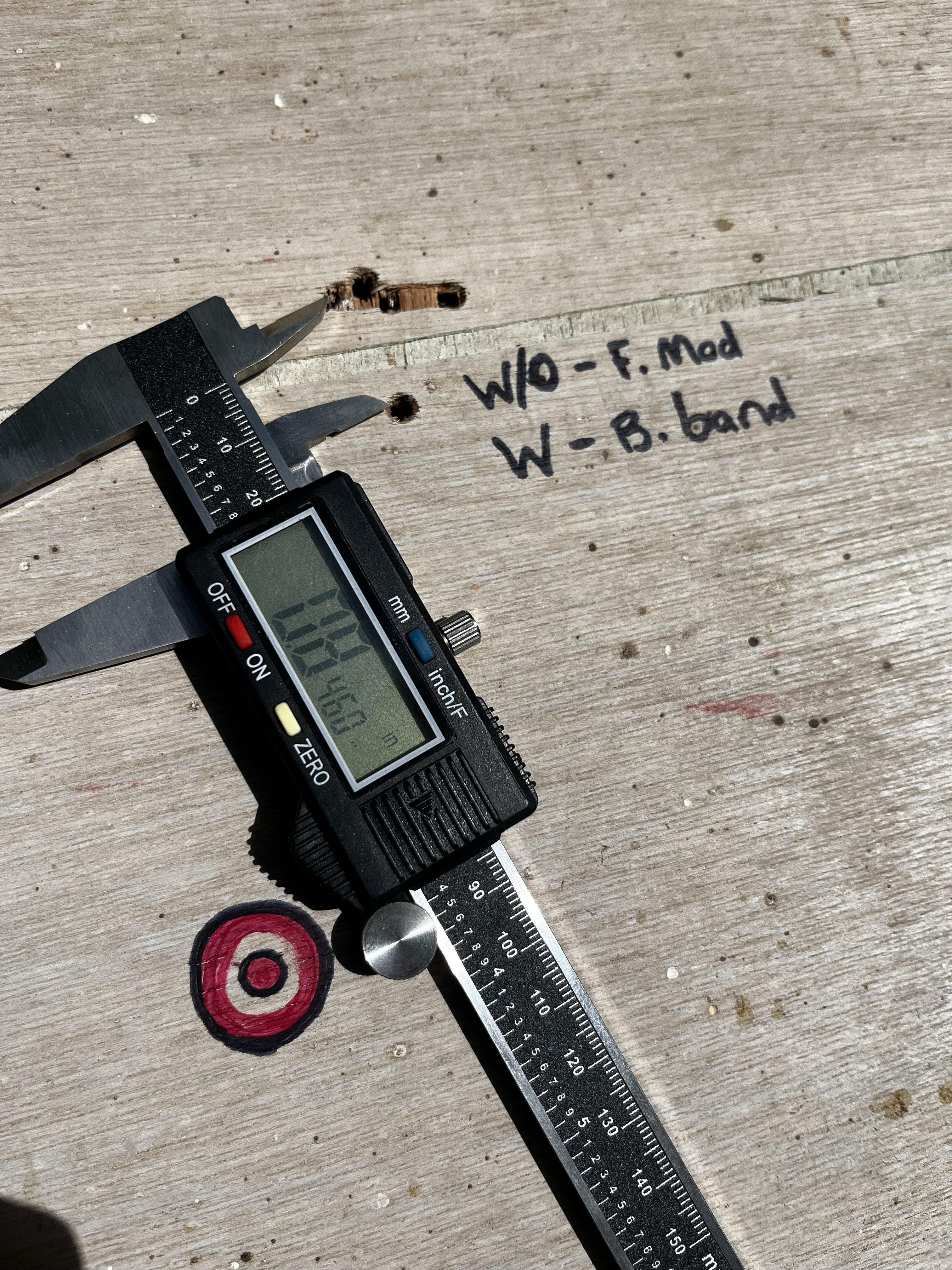

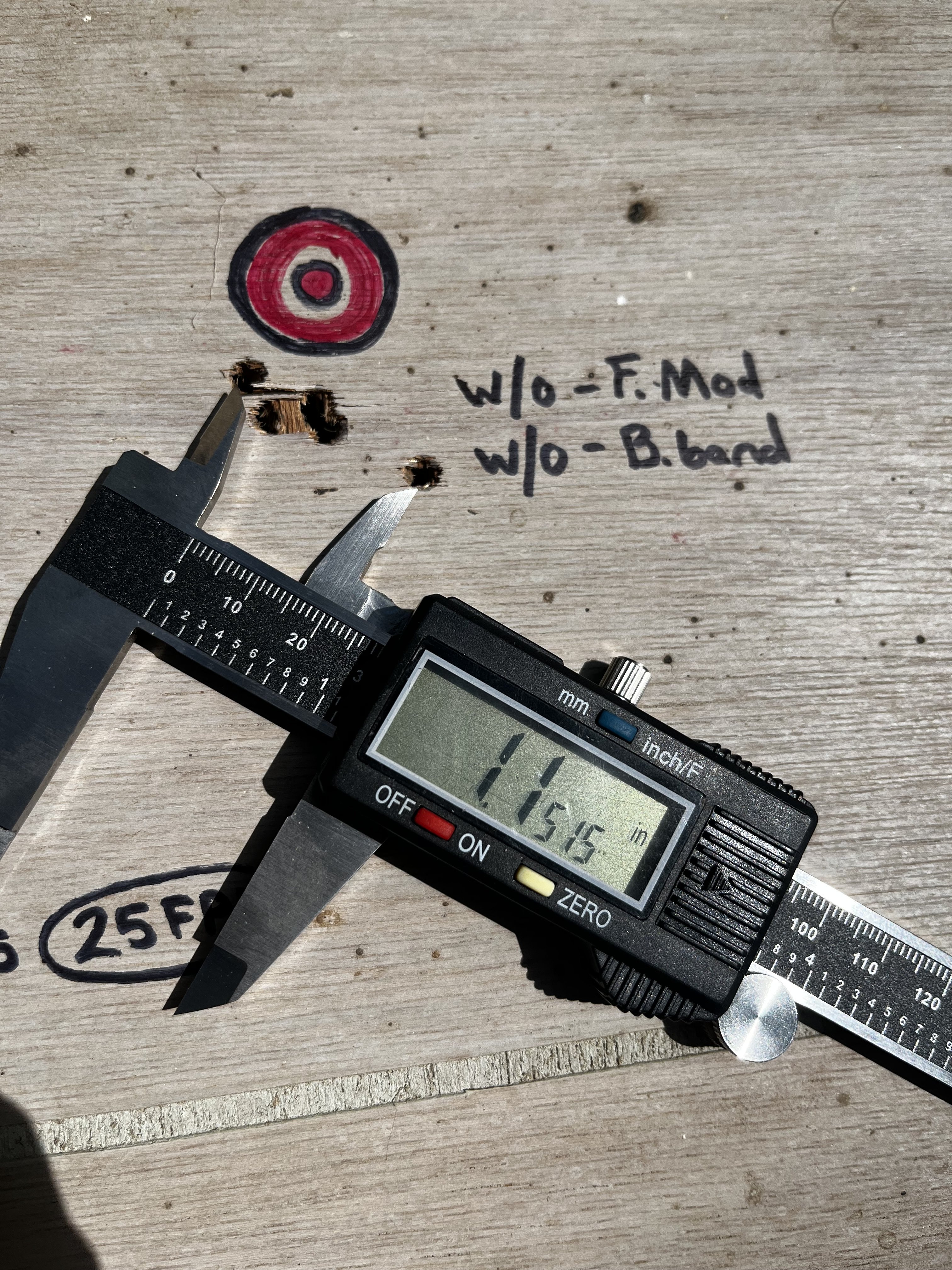

I had a little free time to test my rifle a bit the other day.. however, I’ll preface by saying that I performed the tests using only one pellet (JSB 15.9 grains) at one fps setup ( 825 FPS/ 25ish FPE )
This is a good baseline I feel since it’s a generally good performing pellet.
All groups were shot at 50yds off of bags.
I did have to back off the hammer spring a good bit from out of the box settings for these pellets.
I do believe I’ve discovered some of the issues with this rifles poor accuracy that others have experienced in their reviews of this rifle..
My conclusion is that the rifle can be accurate without a moderator or without the barrel band but accuracy goes to hell in a hand basket real quick when both are in place!
I didn’t achieve the 1 MOA standard that the manufacturer claims however we all know that accuracy can be greatly improved when you find the projectile and fps that best suits the rifle.
For my little experiments I shot 5shot groups in each of the following configurations @ 50yds.
- w/o the moderator & w/o the barrel band
- with the mod & w/o the barrel band
- w/o the mod & with the barrel band
- with mod & with barrel band
- with 0db mod & with barrel band
