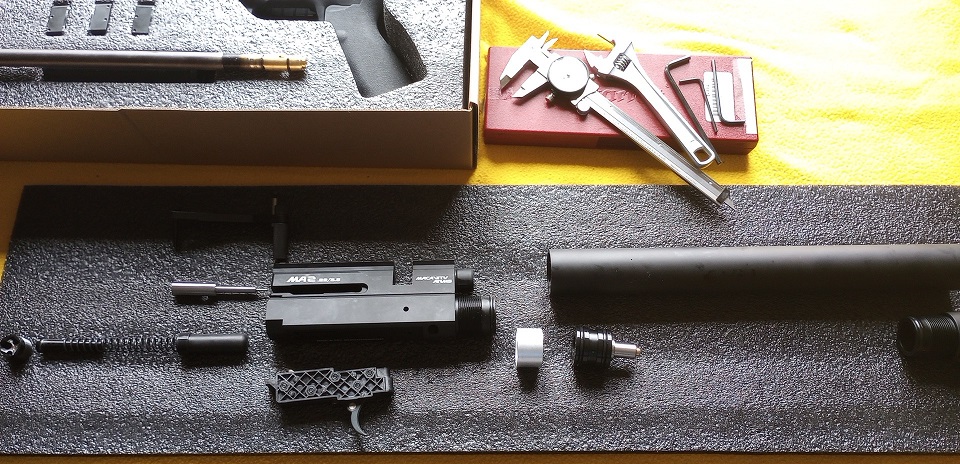

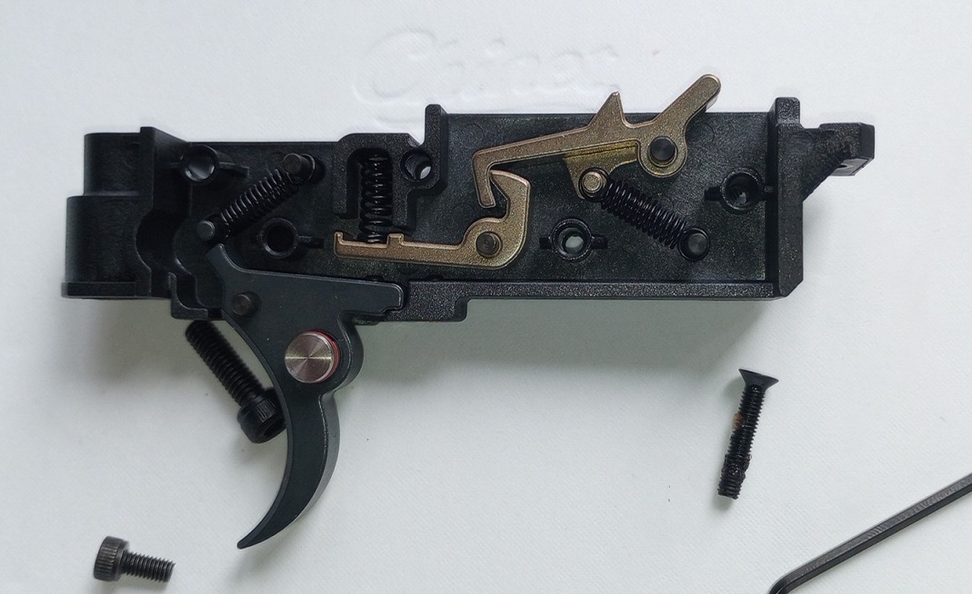

I shot mine down, and would say that the reg was at 1600psi and by the shots I got using 500psi of air, it was on track to get 60 shots. It's still to loud though. I am looking to make a SSS for it, take the trigger group apart and replace that first stage (Lawyer) spring, and turn up the reg. The only thing that concerns me is the barrel retention system. There is no way you can run this gun without that front barrel band in place for any length of time. I wouldn't attempt it at all, having just taken it apart. Iam shocked that you managed the groups that you did. A real project piece.

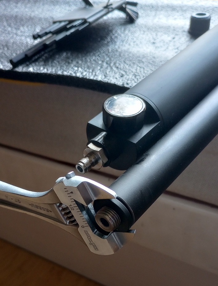

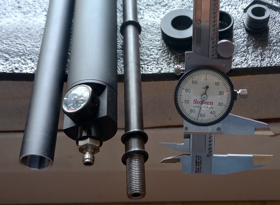

To your point on the barrel retention system, I believe I know what caused your concern because the first time I had mine apart and was re-threading the barrel in by hand I got it snugged up as far as I could by hand and noticed there was a huge amount of slop up and down with the barrel.
That had me concerned as well!
But after I thought about for a sec I figured out the correct method for reinstalling the barrel.
So 1st thread the barrel in til its snug and with the grub screw removed, peer thru the hole for grub and line up divot for grub screw.. then install grub and tighten it.
Next … take the threaded end piece that tensions the shroud and install it on muzzle of barrel til it bottoms out on threads.
Now you can use an adjustable wrench on the tension nut to snug the barrel up the rest of the way in the breech
You will then notice that all play has been removed and barrel is plenty secure enough to run un-shrouded or un-banded.. whichever you prefer.
Hope this helps!
Yeah, I understand it just fine. I am still leary of it. Before tightening up the shroud, just the barrel in the threads moves quite a bit. That's asking alot of the shroud to me. I know the grub is just holding the spin and the threads are doing the work, but still. We shall see. The tension is going to have an effect on accuracy, how big, we'll see. It will be interesting to see what happens in the hot sun with thermal expansion. I am use to the beautifully over-built AAA barrel system, everything else seems (is) less, but for the money, I am super impressed with the build of this gun; especially considering it is a first attempt.
The barrel is certainly stiff enough, no soda straw, that's for sure. This gun is no SPA either, everything was tight and in place, my P15 receiver block and trigger were nicely machined too, it's just that the gun was assembled loose. I decided against changing springs in the trigger. I adjusted out the play, it is at 24oz so what's the point. It feels lighter than it actually is. The SPA trigger in my P15 is far superior to this setup and that gun is very close in price.
You turned your reg up a quarter turn (3 hours on the clock) I turned mine 4 hours. The actual starting length was 2.048" doing 1600psi, and I changed it to 2.060". I have yet to figure out the change in setting. I will say, that unlike everybody else, I wish they had put the pressure guage on the end and used a probe. That way adjusting the reg would have been super easy to do with just undoing the grub screws on the barrel band and unscrewing the tube. Of course, they didn't care because they always planned for the final version to be externally adjustable anyway.

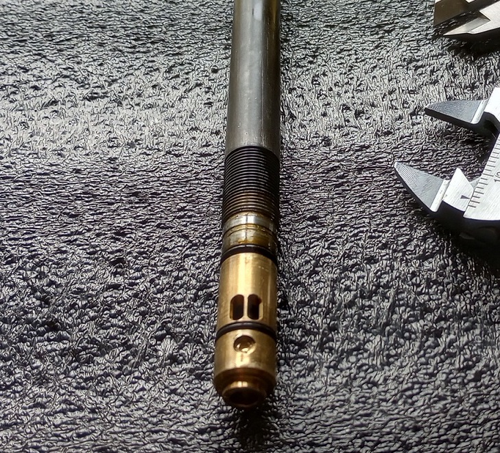

The one feature that I am sure that I absolutely hate is the o-ring in the barrel, and it's deep, like 3/16" in, and tiny. It will be a real pain to replace I'm sure. They should have put the o-ring on the probe.
I am waiting on a scope and different stock and grip to show up, and then I will get to accuracy testing. I did fire off some shots to check the speed and set it to 880fps. It isn't any louder, might even be a little quieter.
My regulator adjustment, which I thought was pretty big, didn't seem to do much. Shooting it down, it looked like it is now at 1700-1750psi, about a 10bar difference, and the psi used per shot is still 33.3. That still works out to about 60 shots per fill, so no efficency was lost. I am running twin springs on the hammer so I don't know if that's helping these efficiencies, or if just upping the pressure didn't effect them. I am going to take my magazines apart and plug the first hole with JB Weld so that I know when I am empty, and stop shooting on an empty chamber.

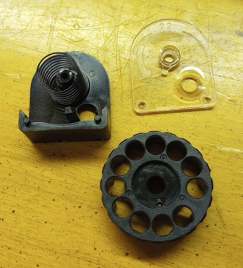

A couple more points I have found along the way. On spring loaded magazines, like the Marauder, there is three holes for you to choose the right tension, or to re-tension, your magazine; this magazine only has one hole in the body. I was hoping to back off the tension a small amount, but no dice. I also don't think that I can plug the first chamber with JB Weld in a reliable enough fasion that I would trust doing so. The chambers are very open and thin and I would think that it would have to be designed in, maybe CARM will drop a round and do that when he he makes magazines for this gun.

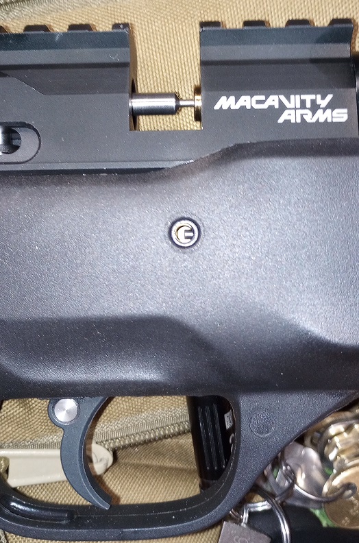

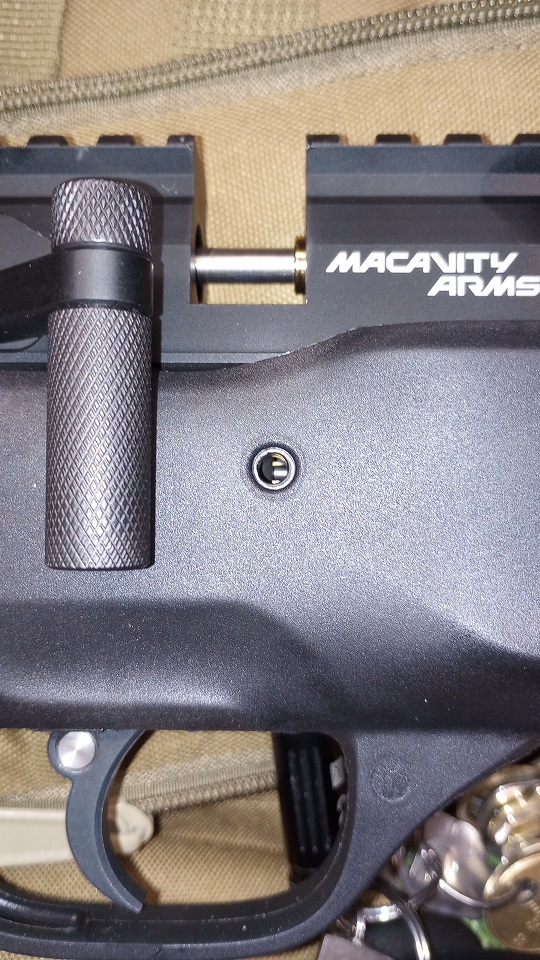

I had not originally noticed but the hole in the stock, beneath the magazine on both sides, is a window to view if your gun is cocked and the hammer back, or not. Clever, but i will probably get some plugs to keep debris out.

I disagree with your analysis about the barrel simply because that is not what I’ve experienced with my gun.
I attempted to explain to you in an earlier thread that if the barrel isn’t snugged up with a wrench before the shroud goes on and isn’t installed using the correct process it will not be secure and like you said it would have to rely on the shroud and band..
So either it’s like I said and you didn’t “understand it just fine” or your rifle is defective and should be replaced..
Mine has zero play where it threads into the breach once tightened completely..
I can and have shot mine without the shroud or barrel band and the barrel by itself is rock solid.
I just like to give credit where credit is due & with this rifle I think the company went the extra mile to thread the barrel in the receiver and they executed it well imo.
I will say that I’m struggling to get the accuracy out of the gun that I expected, but I’m not certain at this point if it’s the barrel or some other part of the equation like the scope I put on it.
The gun and your barrel is designed so that you can not screw the barrel in tight. It has ports and a set screw dimple on both sides because you have to screw it in to the point that it will acceptably retain your magazine and either back off, or turn in more to get to the dimple for the set screw that fits best. If you are not in the right one you either won't be able to put in your magazine, or it won't be held in tightly at all. If you got lucky and it just ended up being snug, than good for you, but I had to choose. There is no way I can run this gun reliably without the barrel band, it's too long of a moment arm for the shroud system to deal with without it. That being said, with the barrel band in place, it is indeed strong enough.
I understand how you see it that way but it is not.. because the barrel and the thimble
“ if you will” are two separate pieces..
The set screw goes in the dimple as you say and retains the “ thimble with the transfer port “ in it precise location then the barrel which is a completely separate piece threads into the receiver and also the thimble… so when you “snug” it up you will not be moving the thimble and mis-aligning the ports or affecting mag fitment.
Of course that’s only if you don’t overtighten it.
Call it luck if you want, somehow I must’ve gotten lucky all 3 times I’ve removed and reinstalled the barrel so far.
Thankyou! Now I am learning something that I never would have guessed. My assembly feels like one part to me. I don't know what's holding it together but it seems solid. Now I completely get what you are saying. Maybe, some prototypes are solid, others are not. The picture on their website shows it as one piece too, so I didn't think it could come apart. I wish Macavity would chime in on this thread. I am not going to check if I can get it apart until after I accuracy check it this weekend. If it shoots great, then I'm certainly not going to touch it! Thanks for the info.

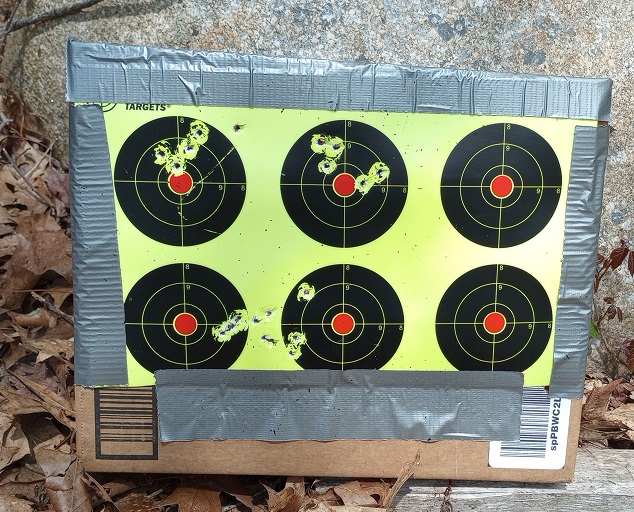

First groups from 53 yards shooting JSB 18.13gr @892fps using a Bushnell Red dot. The dot covered most of these targets, and my eyes are going down hill, so I thought that this was actually very good. The black is three inches across. The actual group size was way smaller than the dot, and I didn't know what I shot until after because of the no magnification sight. All shots were fired with the factory moderator on, and I was moving zero between the bottom groups. I can work with this, can't wait for what this will do with a scope.
View attachment 463641View attachment 463642
That’ ain’t bad at all.
