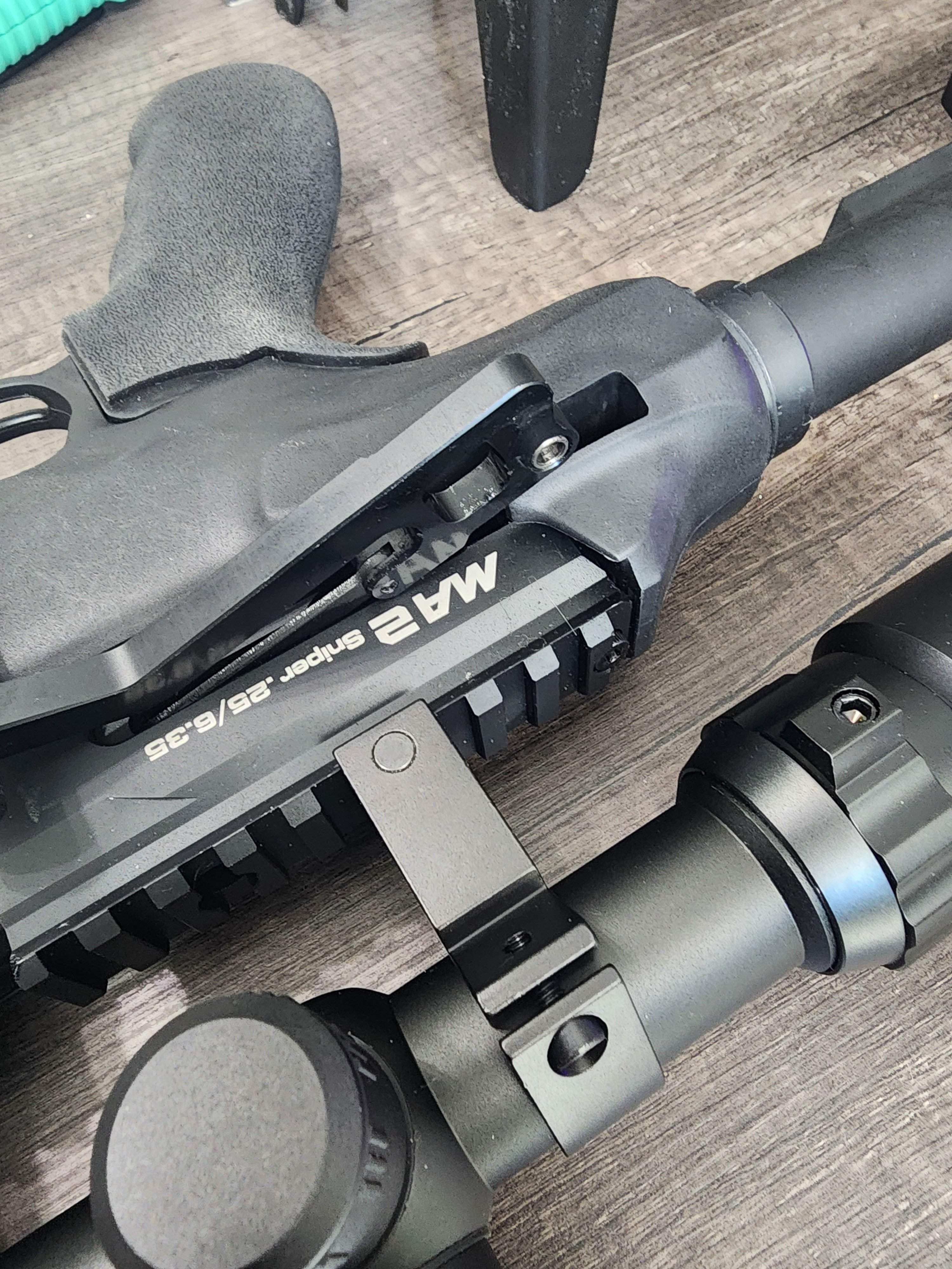

A tiny bit of blue or purple loc-tite will keep your screw where it belongs.day was going pretty good. out early, shooting fairly decent groups and then my side lever basically just fell out. found bolt that holds it in on the ground. Had to remove scope line it back up and reinstall retaining bolt. wasn't quite ready to start having to take apart the gun quite yet. luckily it was something simple and easy to fix.View attachment 469131
none. lever is smooth and easy all the time. no pressure or friction from the bolt, it is just a pivot point. I had picked the rifle up from across a table I was filling it on and I probably held it upside down a few seconds and apparently the bolt just fell out. Had to remove the scope to get it back in correctly it goes through the picatinny rail. put everything back together and it is shooting great again.Did you get any warning signs? Like the Lever feeling sloppy or loose?
I want to get to know the gun a little better before I start locking things down. Still haven't worked up the courage to start taking it apart or trying to turn screws to change settings. I have a chronograph on order that should be here early next week. that will give me a true idea of what is going on with the rifle. I am pretty sure there is a setting off somewhere. I always thought a regulated PCP would shoot pretty consistent through many shots. I am getting 24-30 and then the shot groups start dropping to the lower right. Macavity says it should get almost 60, although short barrel is rated at 30. That is why I am thinking the internal regulator might be set at the higher setting for the short barrel. I am new to Airguns and PCPs especially so not sure what the curve on shots and behaviour should be.A tiny bit of blue or purple loc-tite will keep your screw where it belongs.

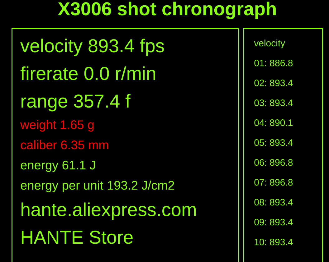

I just tested 10 shots and they ranged from 795fps to 800fps. factory says the .25 MA2 is set to 890fps. I haven't changed any setting and am using their recommended pellet. any suggestions as to whether I should do an adjustment to one of the settings to see if I can get it to 890fps? I do not know anyone around my area with a Chrono that I could match it to.
after removing cover, found set screw very loose. went ahead and adjusted hammer spring while testing. tightened set screw, 9 shots after tightening. seemed pretty stable. I'll have some time over next few days to see if it improves groups and holds settingI doubt that your chrono would be off more than 15fps, mine have all been within 3fps of each other. Another way to check your velocity is by using Strelok and checking the drop between distances. If you input all the data correctly for the app this should be very close.
Let's just assume your chronograph is accurate and you you are shooting 800fps, by all means turn it up. Loosen the set screw on the side of the hammerspring adjuster and crank it in a full turn and check the speed again and again until you see the number near where you want. When you get near your goal you will need to go down to 1/4 turns. Don't forget to retighten the set screw after, and don't reef on it, just snug. You don't seem to be trying for crazy numbers, or use heavy ammo, so adjusting your hammerspring is most likely all you will have to do. Good luck!
