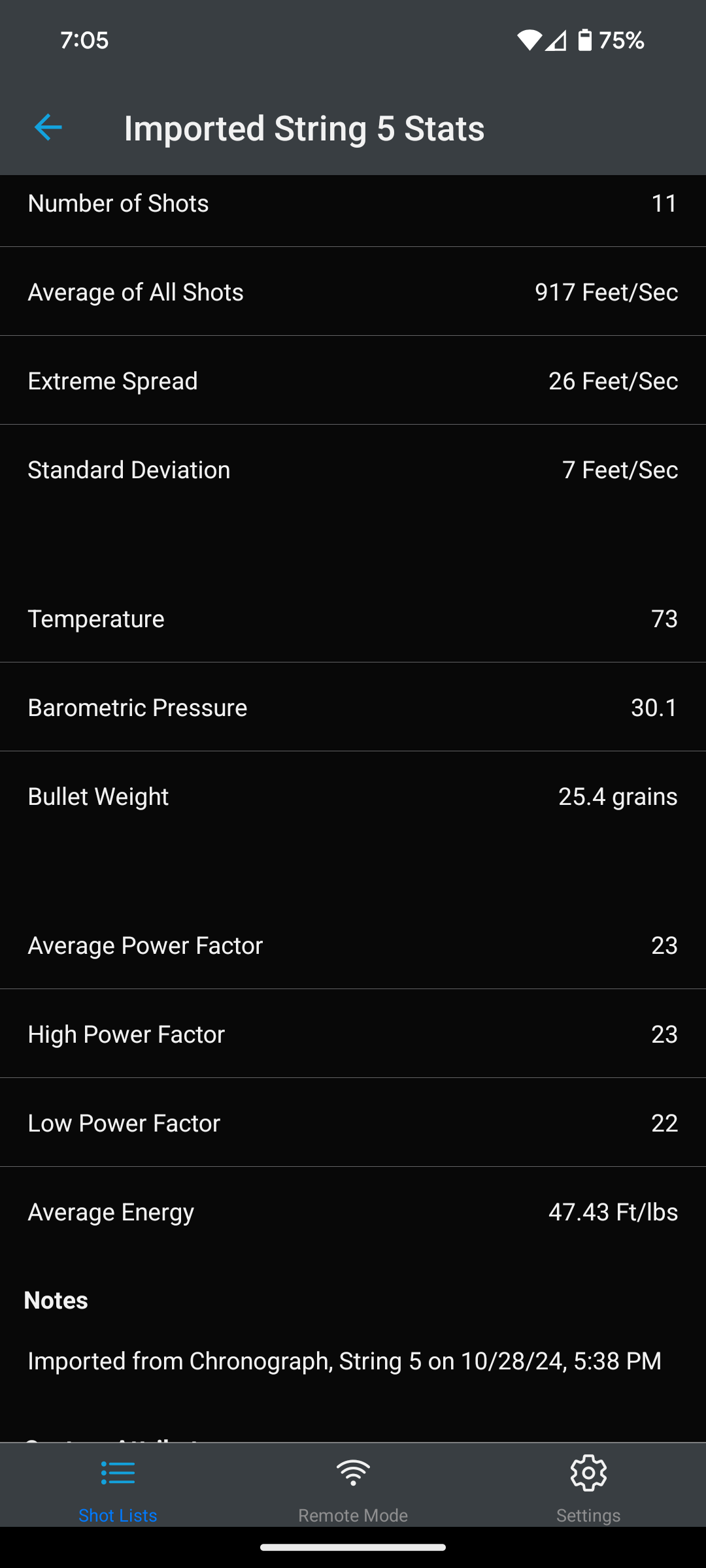

They set the regulator higher on the short models to make the power. You can turn up the reg on the longer version and indeed make more power. My .22 short version has a lot of breathing room, I have been waiting to hear what others have tried, especially on the long versions. I had mine doing 45fpe w/o breaking a sweat. I turned it down to 35fpe because that is what worked out the best for my horde of 18gr JSB's.

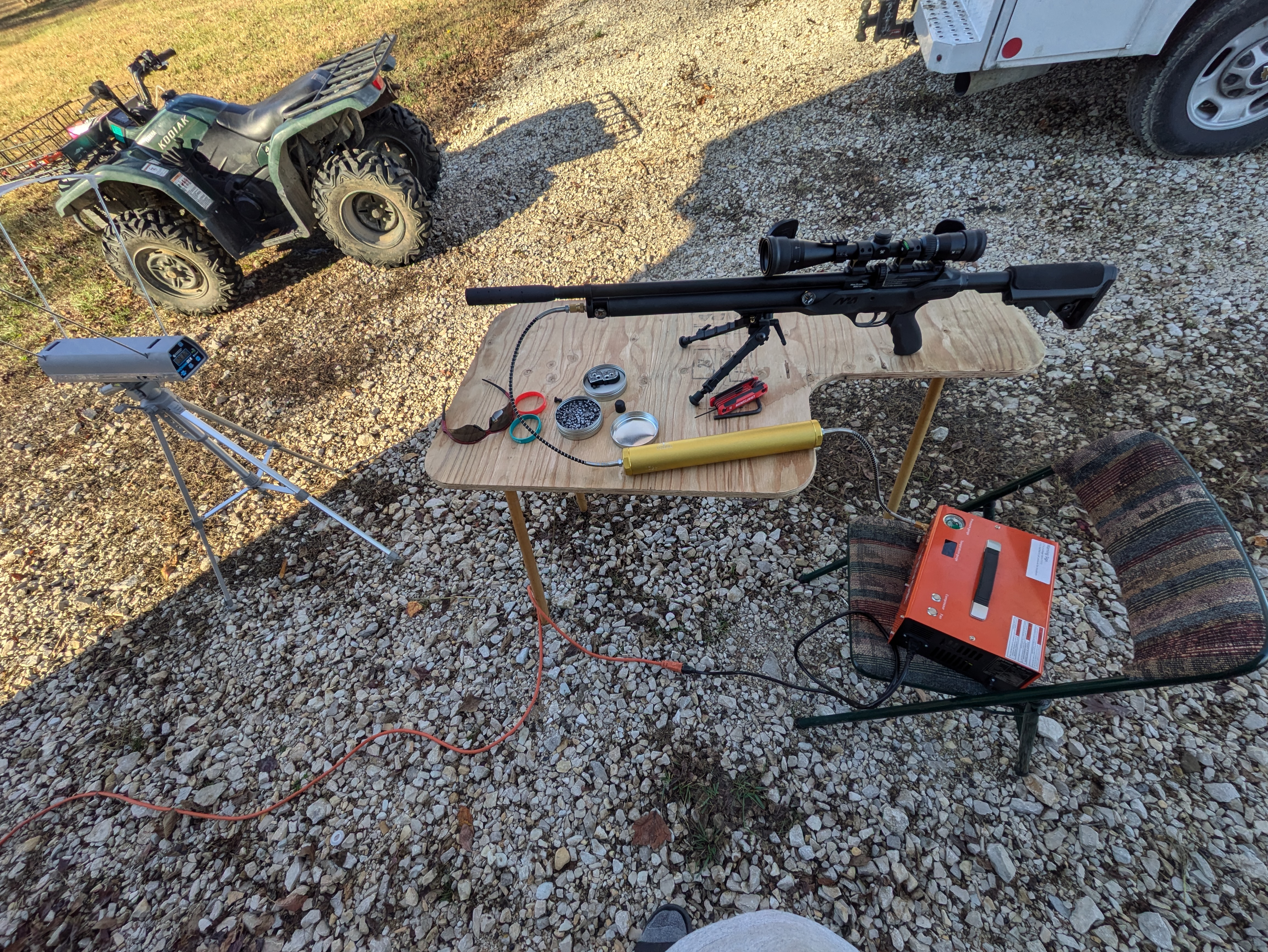

Finally got my Chrono, reg set at just below 2000. Can't seem to get it adjusted between 1800-2000. Had it apart atleast 6 times. FX pellets 25.39. .25 Cal long

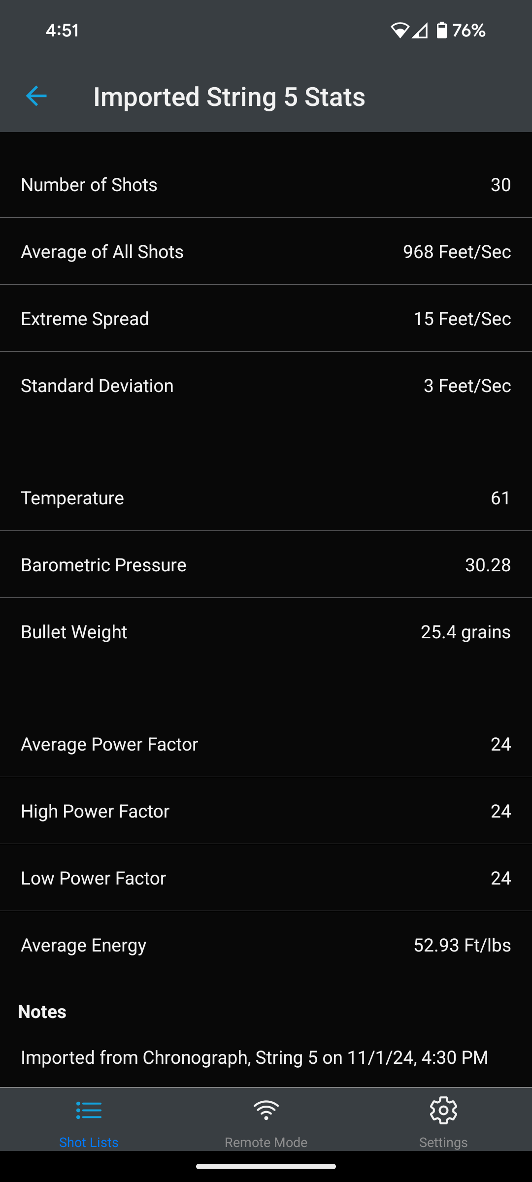

Reg creep has been resolved for 1000 rounds now 😁.. With reg at 2100 I played with the hammer a lot, and was still getting better consistency at middle tank pressure. Getting the same now that I've got reg at 1900. Guess I'll go back to the hammer tomorrow and see what I get. No matter what I still just enjoy shooting almost every night. Love this hobby.
