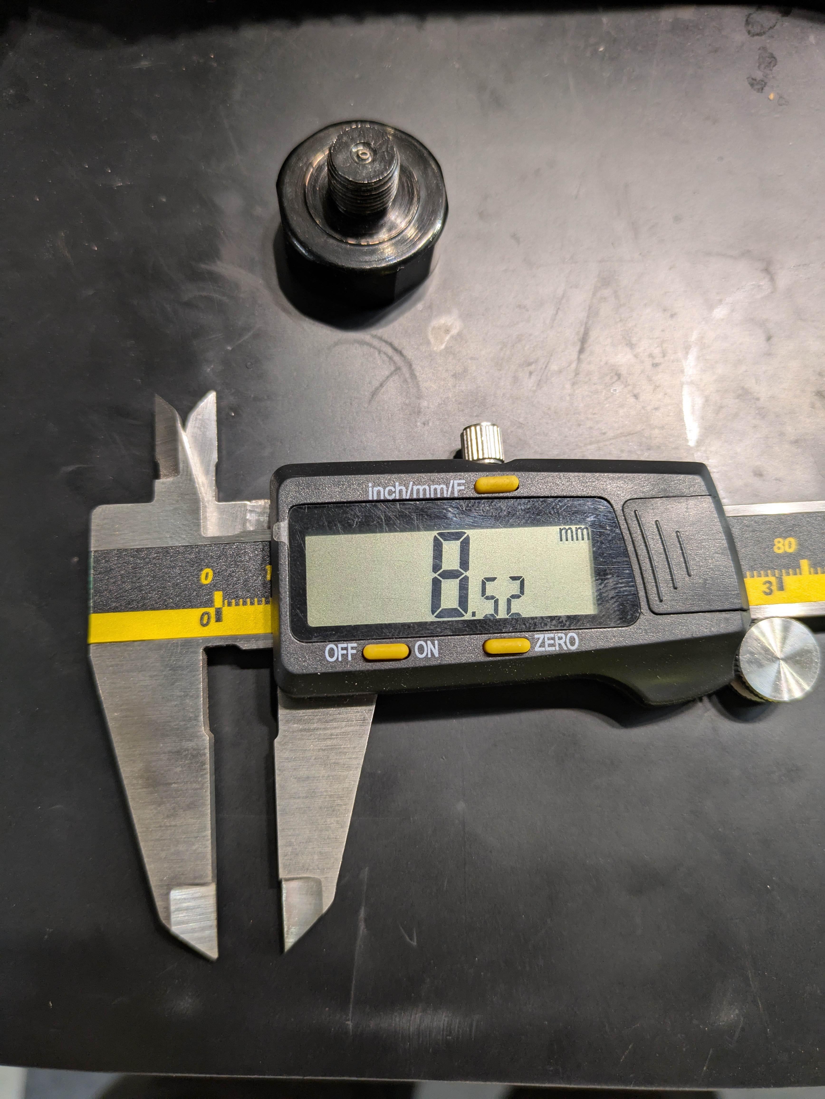

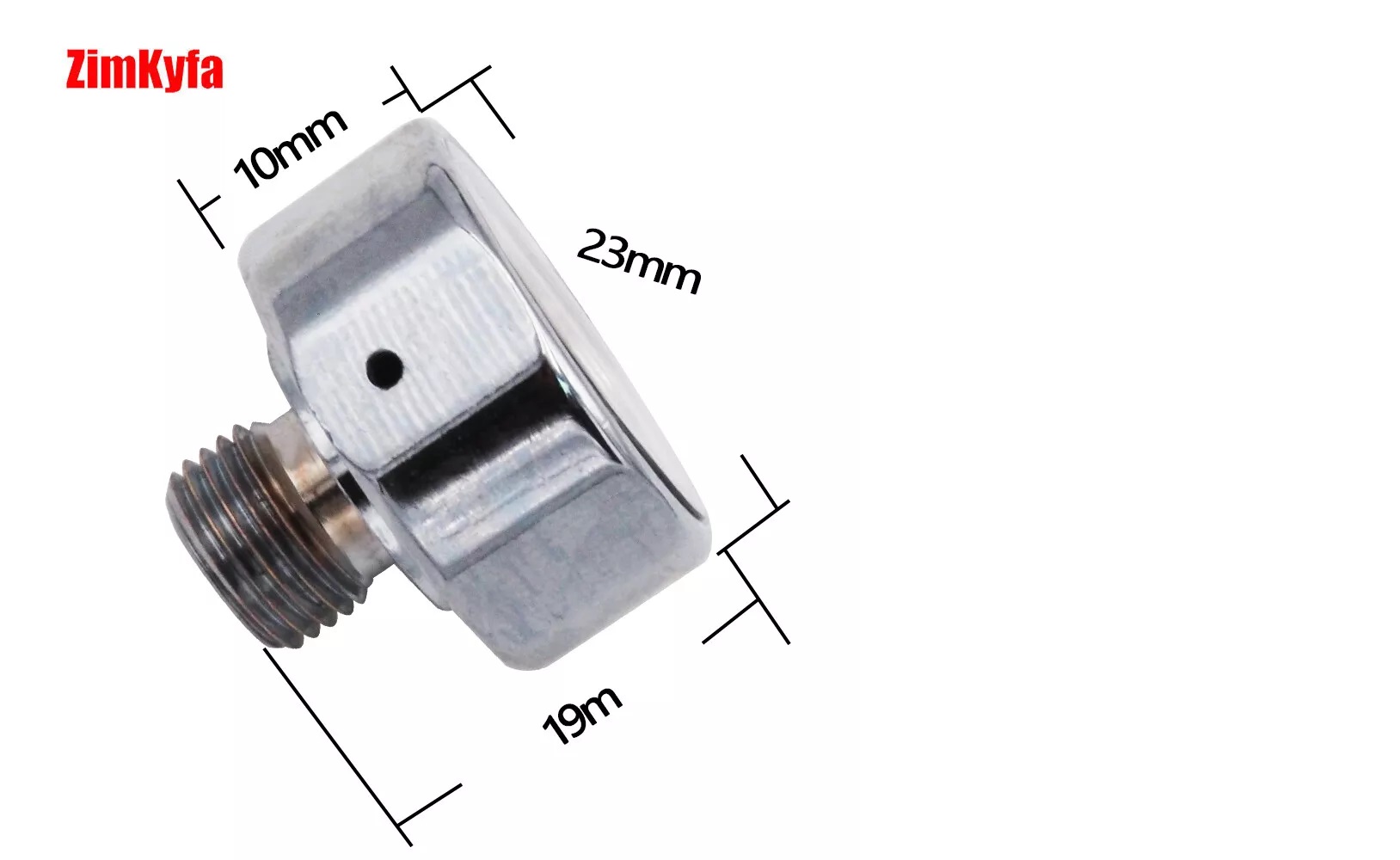

i emailed macavty but spread lead has ancered my question thanks so much only thing i proble need to cheak is the o/d of the guage on the ma2 the frount tube has a off set where the guage seting down ward the o/d if same will work but if i buy a gauage larger than stock it may not fit on frount of tube the back has clearencer
Factory is 25mm on the tank gauge, clearance is so tight, I'm not sure you could get away with 25.5. Safe bet would be 23mm up front. Regulator gauge you could go 28mm if the size difference didn't bother you. Happy to help Gizmo!
