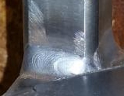

My MIG spray arc on 1/8" wall tubing. Clean and almost silent.
What welder are you using?
Everlast 250P inverter based pulse MIG. It's about 10 years old now and the toughest welder I've ever used. I won it and a 60 amp plasma cutter in a welding contest.

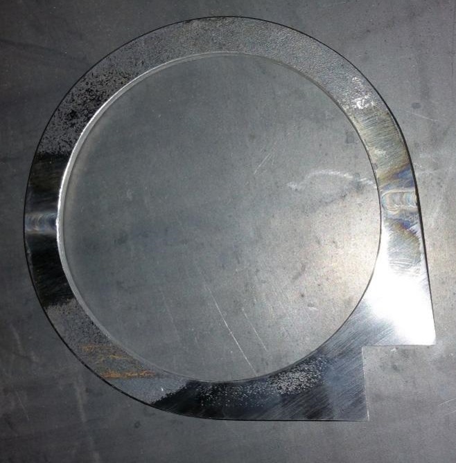

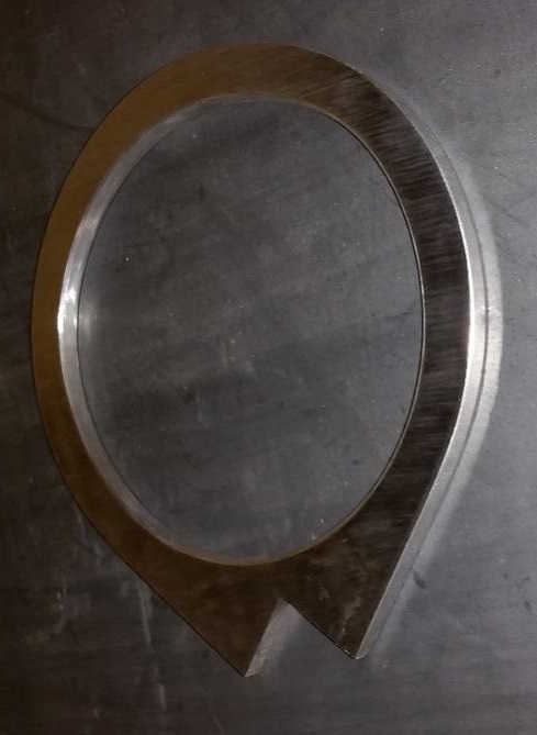

I also have an Everlast 250 amp AC/DC pulse TIG. Here's a pic of an air dryer mount I made from two pieces of 1/4"x3" flat bar. I put the two pieces together with an autogenous TIG weld (no filler) from both sides and then plasma cut it to shape.
