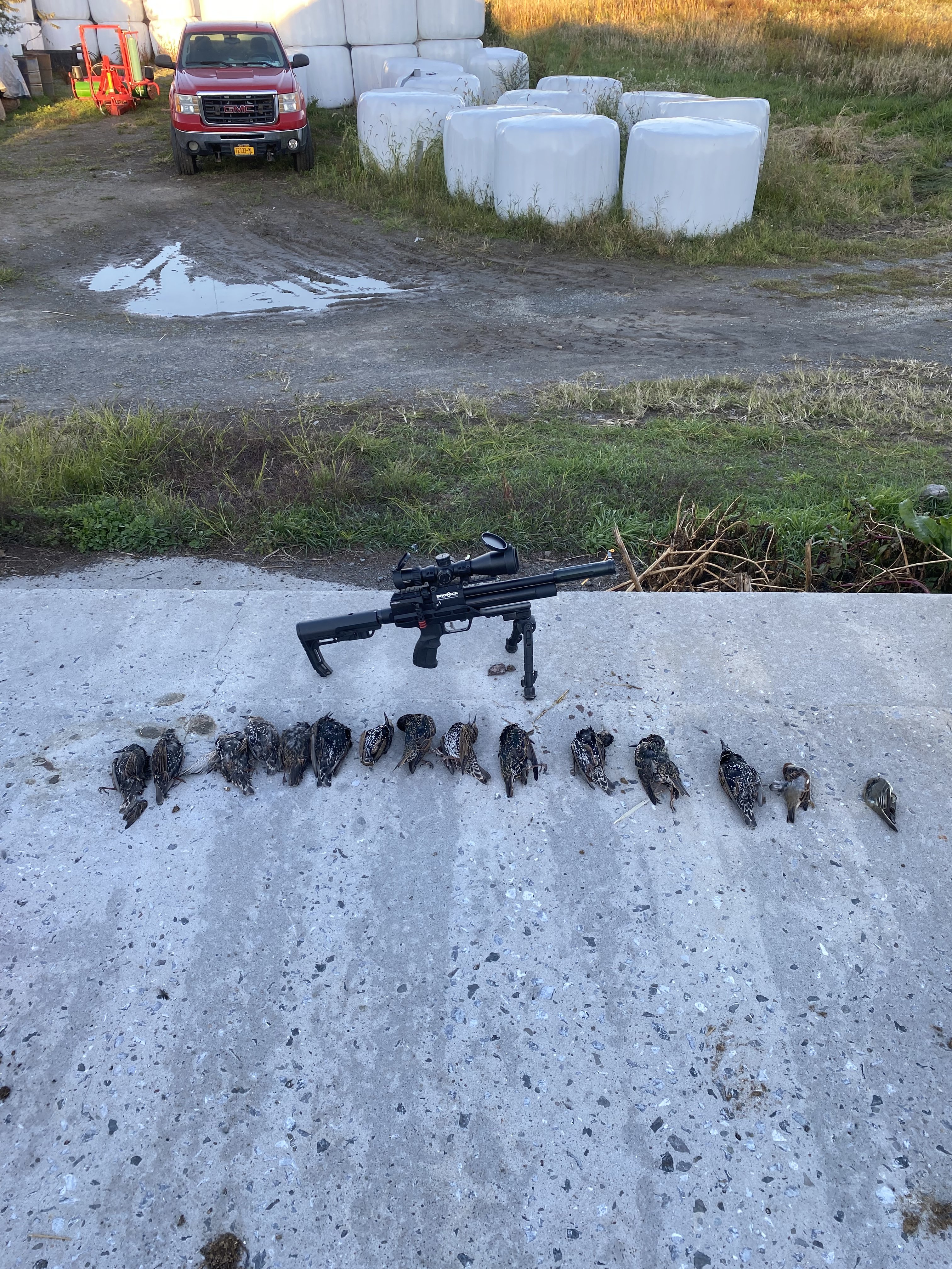

I had a gen 1 wildcat in 177 and hated it….I bought a huntsman and loved this rifle, but the wife stole it for FT…I am currently shooting a crown MKII in 177 for FT and it shoots great 500mm barrel. It has been to the dairy and it will take down collar doves with no issues…I did have a Uragan compact in 22 and sold it like a dumb A$$🤬🤬🤬If the 177 Uragan is anything like the 22 it would be great…..There is a Taipan veteran in 177 on air gun warriors for sale.
