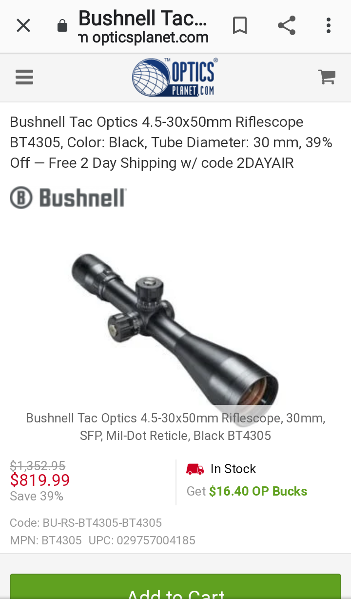

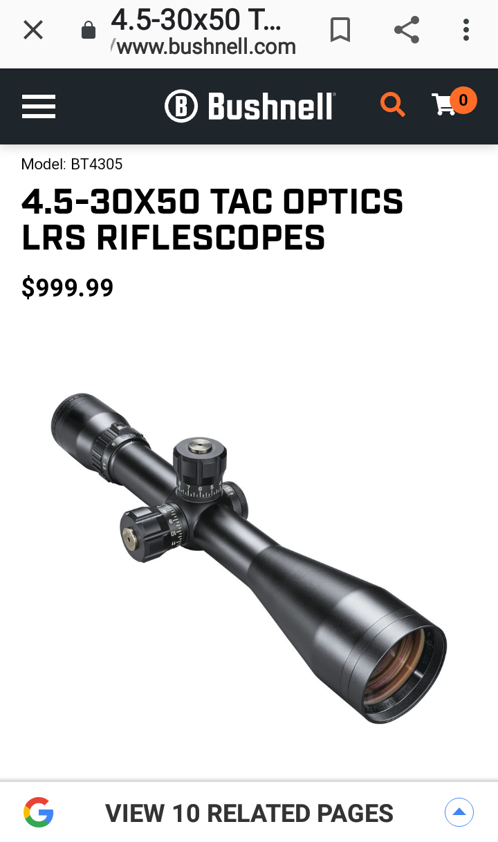

You may opt to buy the $819.99 JAPAN Bushnell TAC 4.5-30x50 from Optics Planet instead. It's more expensive than the $599 SWFA version so that may give you added piece of mind as well. I would take a JAPAN SCOPE over any Chinese scope any day except for the Alpha6. I just don't use the Alpha6 to click just because it's a Chinese scope with fantastic glass that is comparable to much much much higher dollar well known and popular Chinese scopes branded by many different US companies which has superlative illumination that focus down to 10 yards which carries a Lifetime Warranty. I click with only JAPAN and European made scopes. Only reason I bought more Alpha6s as compared to the Bushnell TACs is because the Alpha6 is illuminated.
You may feel free to buy whatever Chinese scope You wish since its your own hard earned money. You have the right to spend it on whatever you wish.i People have the right to experience life themselves and not take anyone's suggestion and see for themselves. Just don't ever look through an Alpha6 after you buy any other brand Chinese scope ALSO including that JAPAN BUSHNELL TAC then you won't know any better and feel as stupid as I did spending a hell of a lot more for popular brand Chinese made scopes that weren't nearly as clear especially at maximum power.
