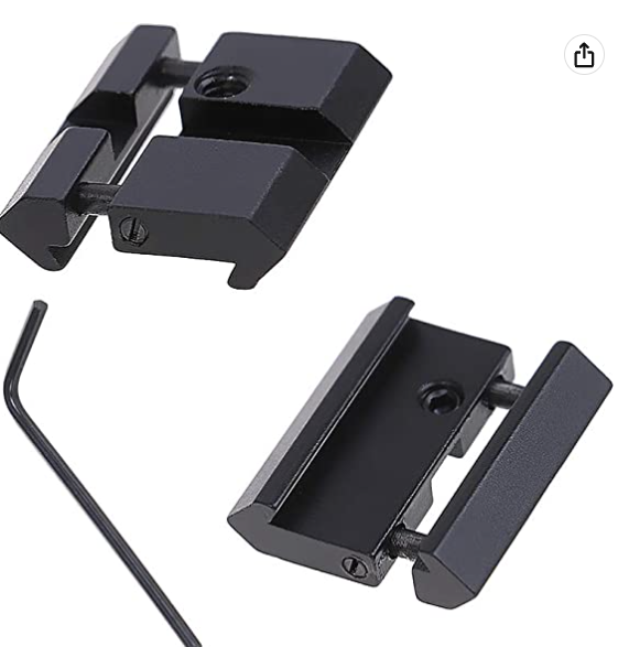

Easy peazy - all the Holuson have a pic rail connector. Just get one of these from anywhere available:

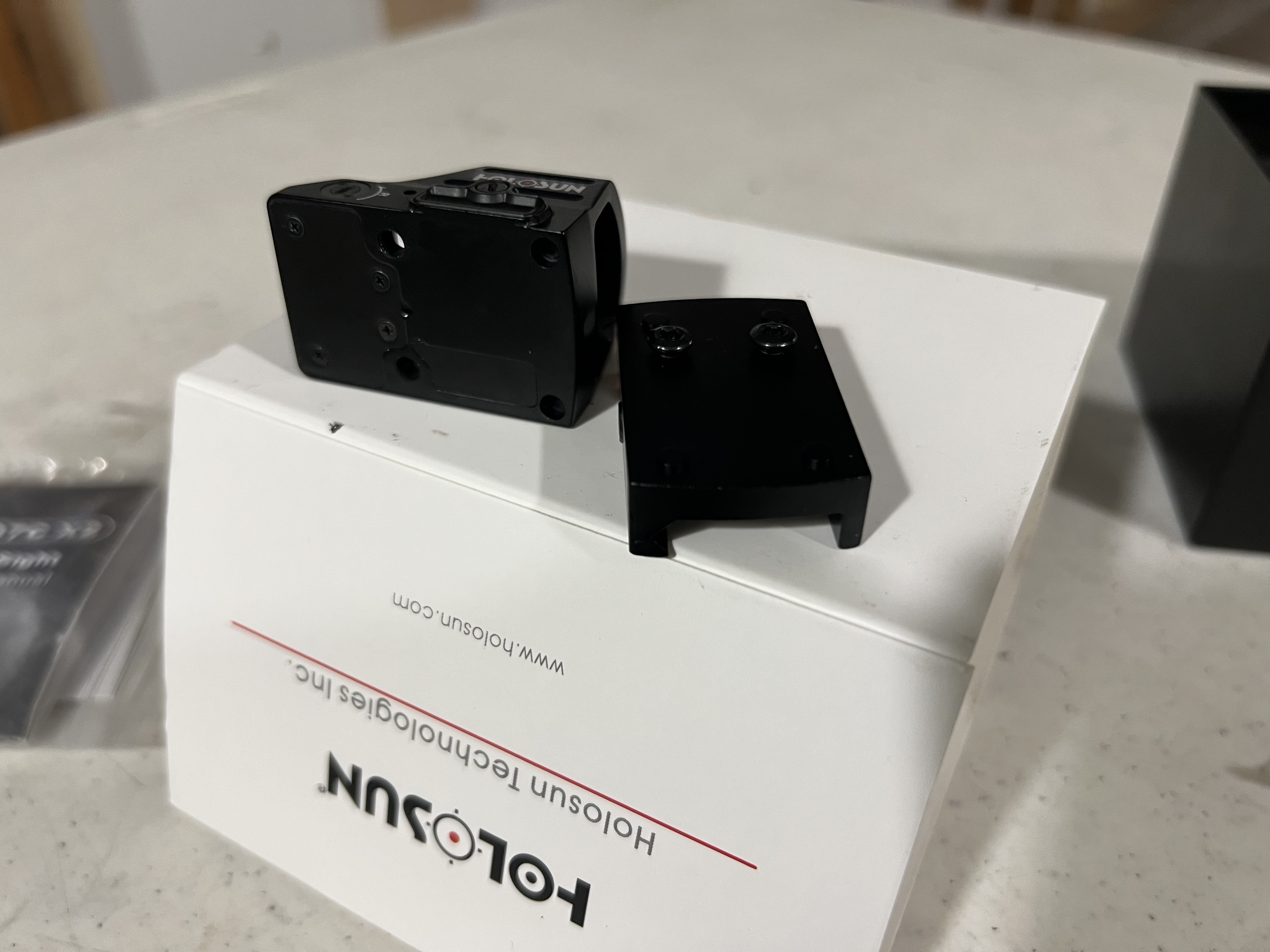

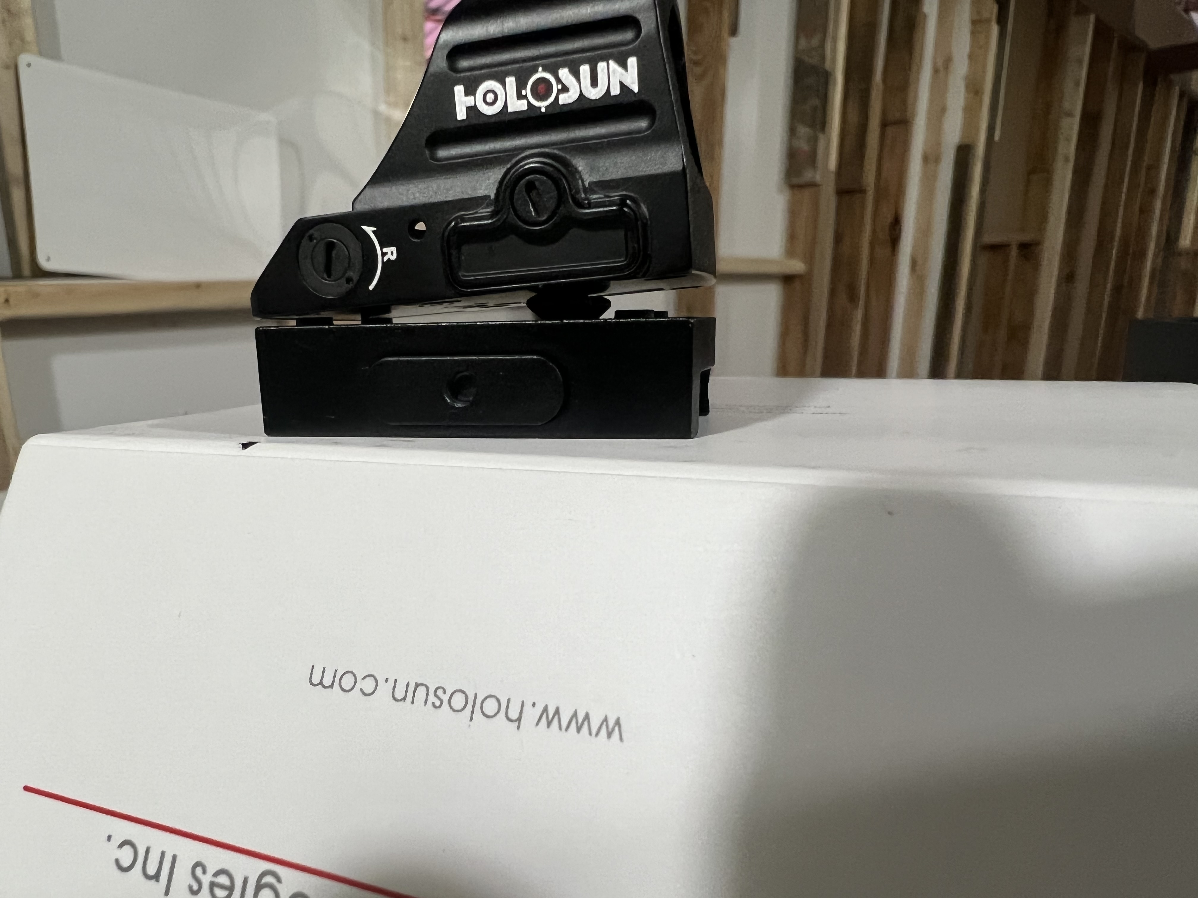

Correction on my earlier post:It does NOT come with mounts.The bottom is completely flat with four holes.Two for the posts up front and two for the screws in the middle.This is it with the picatinny bottom from a Bushnell mini red dot
As you can see the screws or posts doesn’t line up.You can take the screws out and file down the posts and use glue or alien tape.(I bet it hold on a pcp).

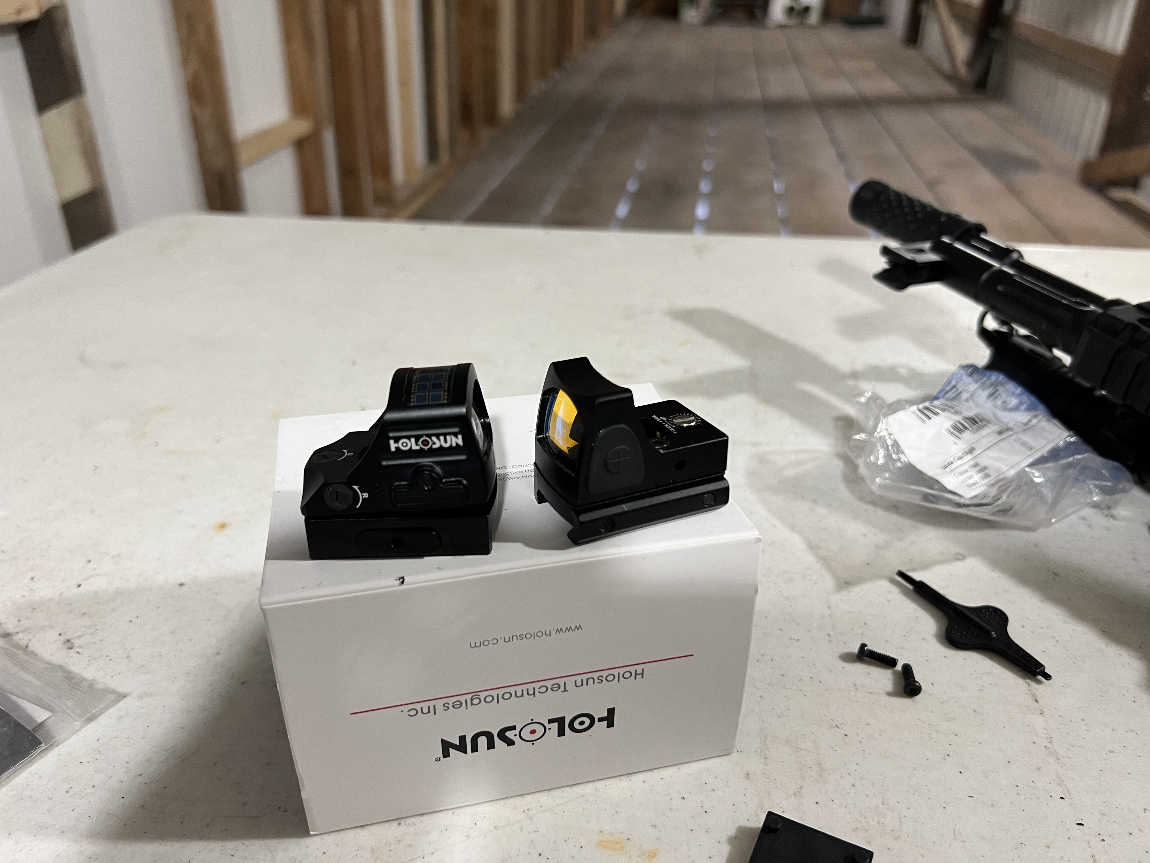

Or you can go with a cheaper one that comes with a picatinny already like this Amazon cheapo.

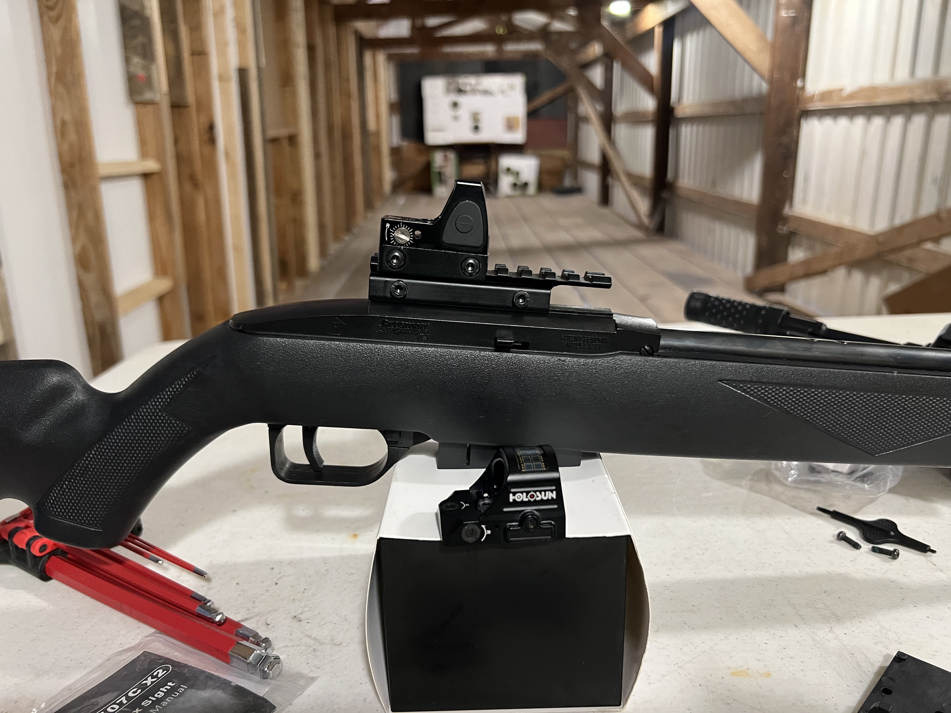

But either way you need a dovetail to picatinny still you can get a low profile one,here’s an example of both together on a Crosman 1077 with dovetail to picatinny with mini red dot.
Hope this helps..cheers

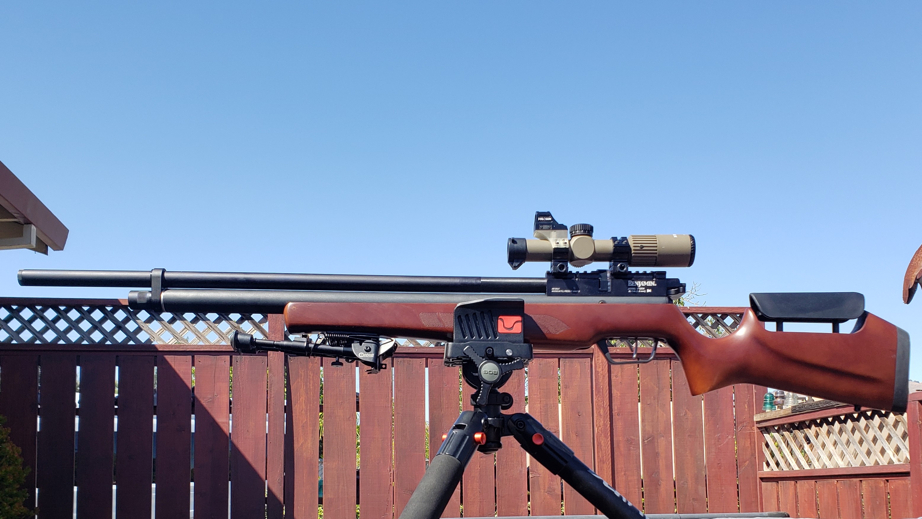

So as I've done, you'll need an RMR (Trijicon)/Holosun to Picatinny mount. You also need an adapter to go from the Picatinny to the 11/12mm Dovetail rail.
If you look closely below, you'll notice some white writing below the sight. That is a Picatinny to 11/12mm Dovetail adapter.
The one shown, I bought from a shop in the UK. The shipping to the US is horrendous ! Or, as the answers on your post, you can buy the small sections of adapter to use. Just be awair, you'll need two. Try to find the long versions if you can. MUCH more stable.
Click on the picture to expand.
