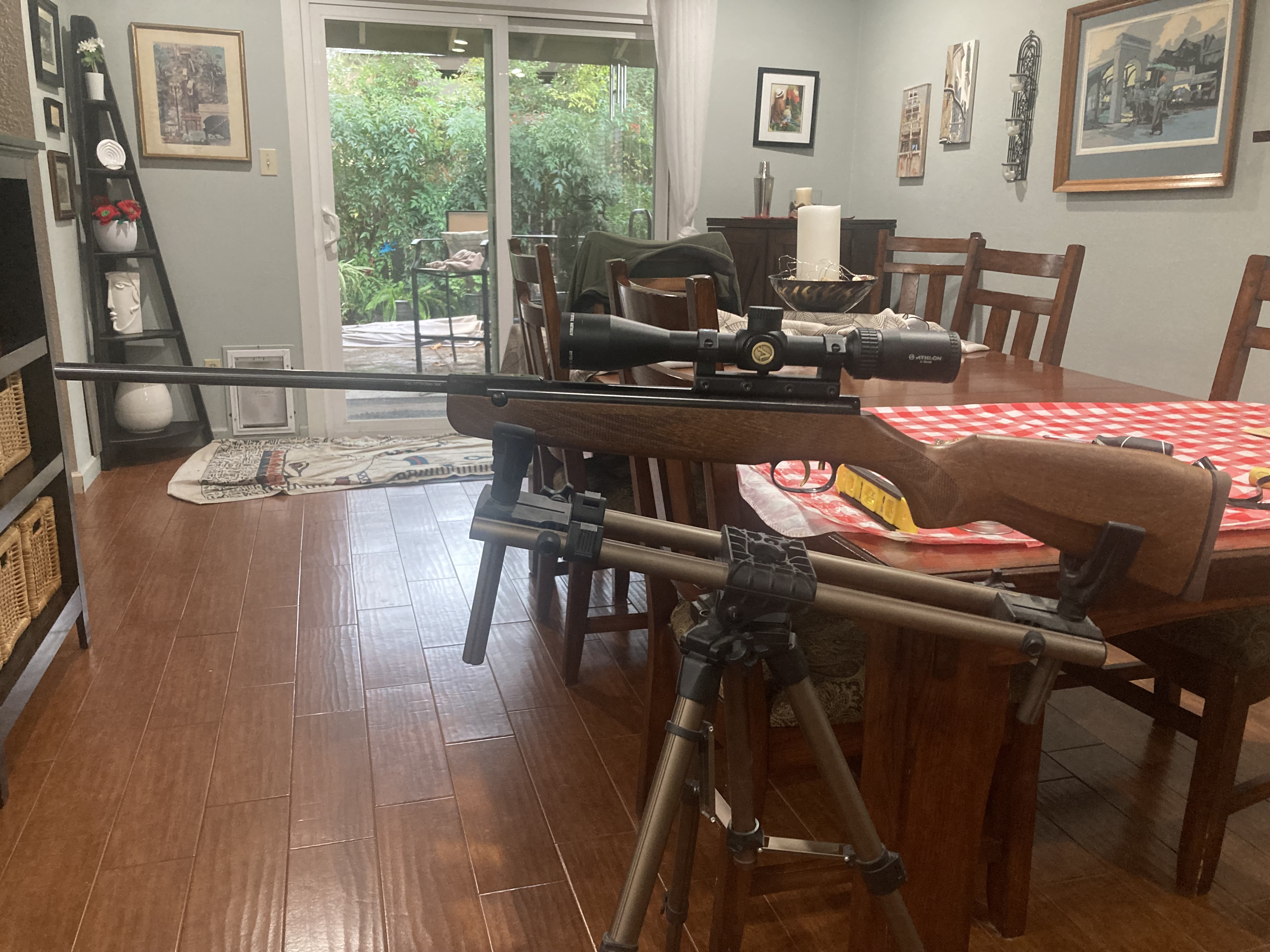

I bought a Beeman R7 recently, and have been breaking it in. The JSB Exact RS Diabolo 7.33 grain pellet does the best, but others work out well. Question: Is it worth the money and effort to replace the original spring, or go with a tune using the Vortek Pro-Guide 4 Tuning Kit? And is that the best, or maybe the ARH Maccari kit? I am going for max smooth, not a harder-hitting gun.

I have decided just remain stock until I shoot it more. At 25 yards, a perfect hole dead center is very possible if I do my part. My HW97K has only a slight edge if any. Stuckat is right IMO, the AA Falcons 7.33 are amazing. First rifle or last, every spring gunner should have a Beeman R7.
