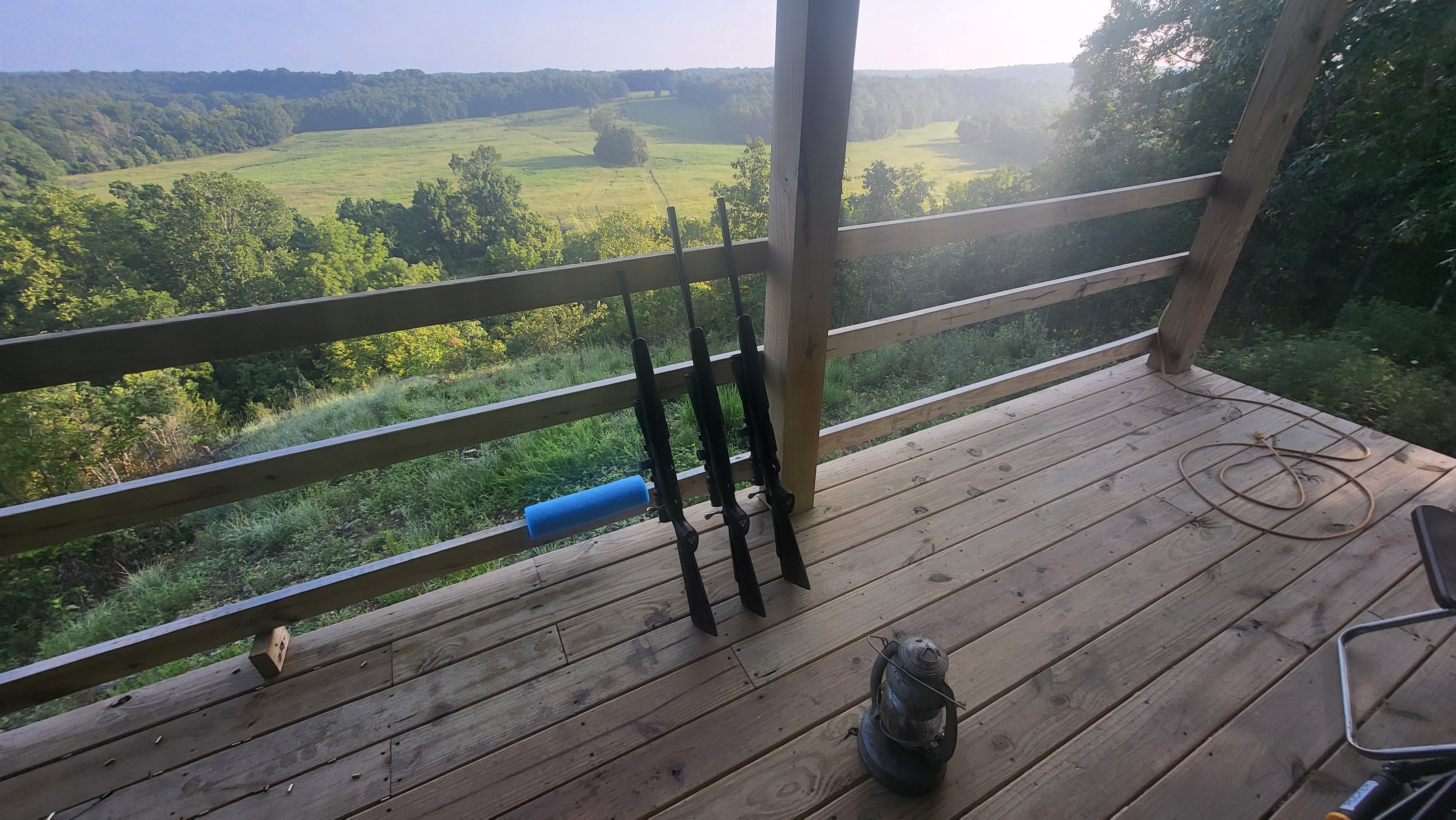

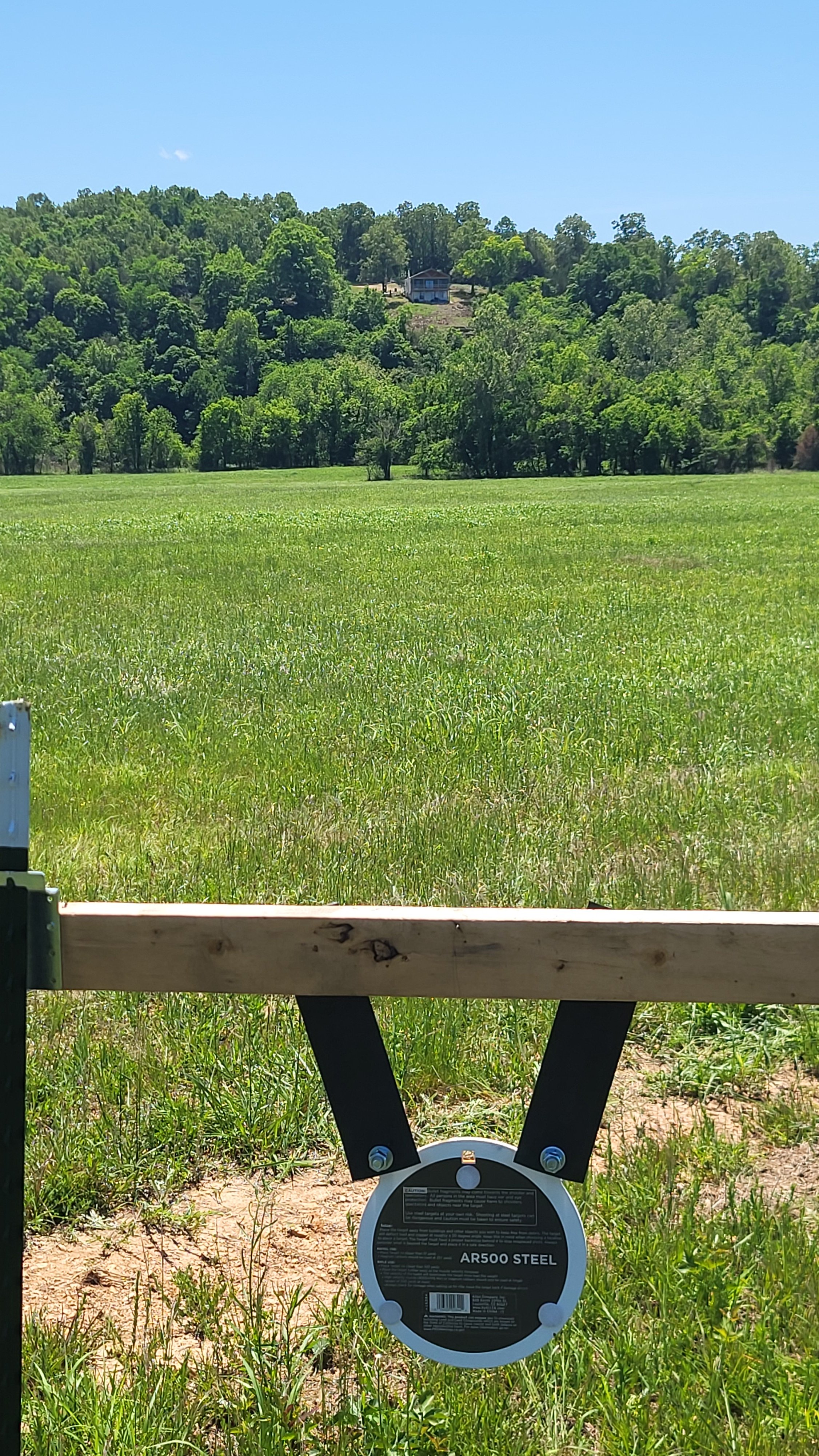

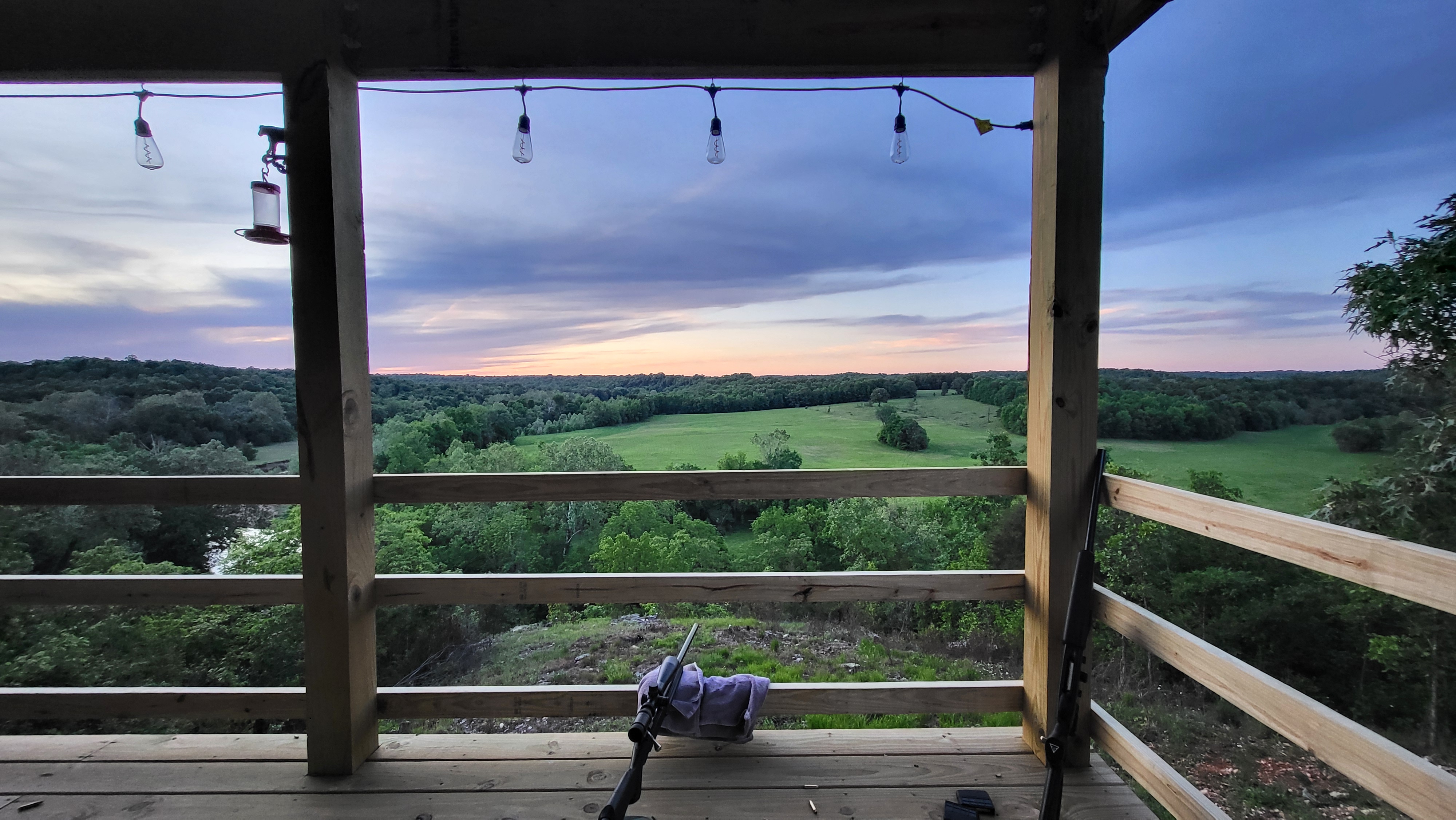

Cultural differences or not. I'd never worry if people consider a 30 a junior gun. I have 113 acres in Arkansas and shoot anything I want shoot off my back deck to 625 yards. I shoot my 22LR out to 320 yards almost daily. My 223s and my 6.5 creedmore go the rest of the way several times a week. I have nothing to prove to anyone. I don't care how anyone might perceive me shooting my little 30s. That's saying alot here in Arkansas where there's no gun restrictions and kids usually skip air rifles entirely.
