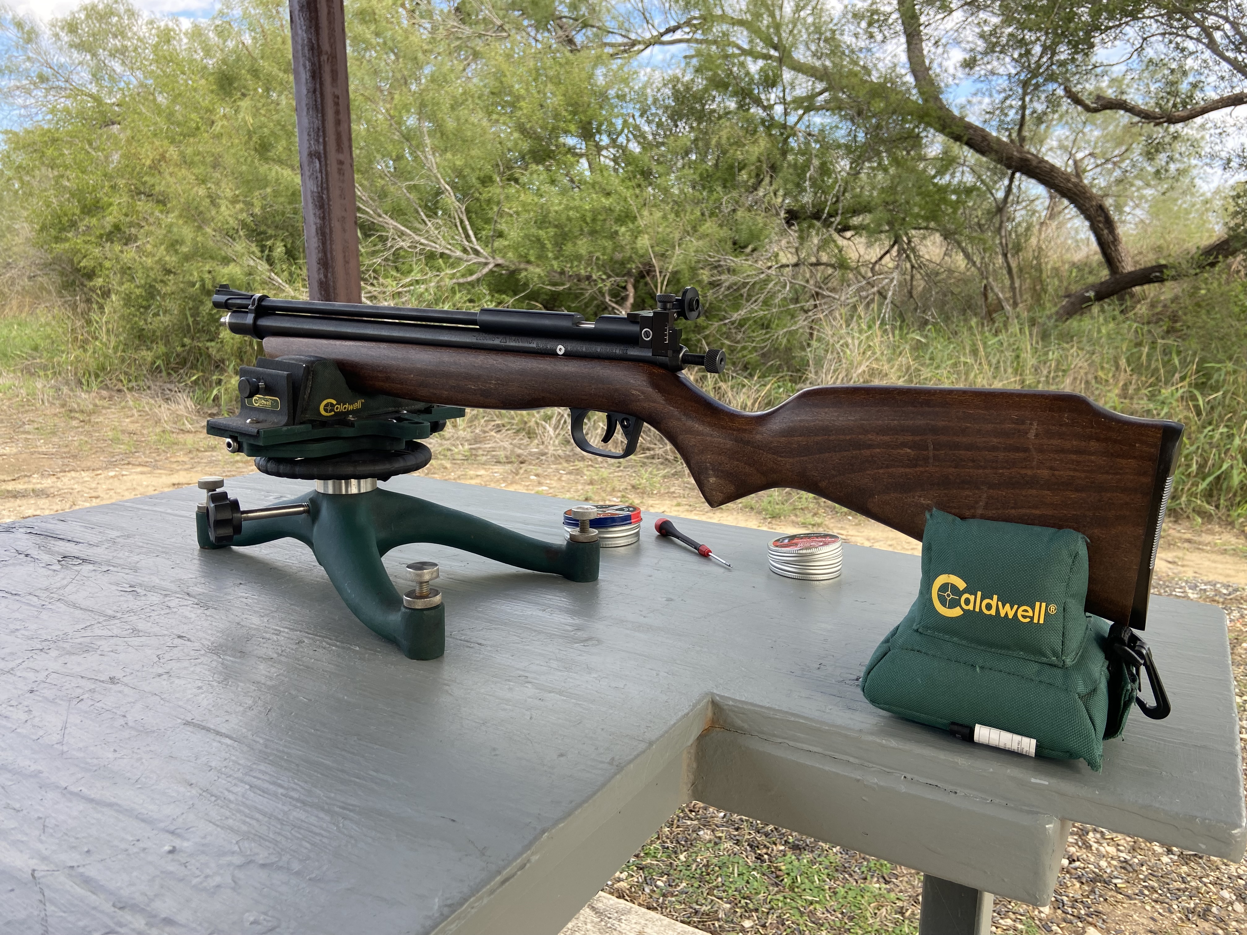

I purchased a Maximus a couple years ago for tinkering purposes and now I want to tune it for higher energy levels.
Currently shooting it stock with 24ftlbs and getting 15 great shots and 20 useable shots per fill from 2000-1200. Using 15.89 JSB pellets and getting excellent accuracy.
I actually have a hammer spring adjuster I got from magnum air power and a light spring I used to detune the gun to 13ftlbs. As I said I bought this to mess with a bit.
I’d love to get like 10+ shots a fill at 30ftlbs or more but I’m not willing to get less than 10 shots per fill. So my main question is can that be done easily or will I need to do more than just play with the hammer spring tension and fill pressures?
I don’t care if I shoot pellets or slugs but I just want to know from the people that have done this already what it’s capable of. Just looking for insight or what you might of done to get there!
