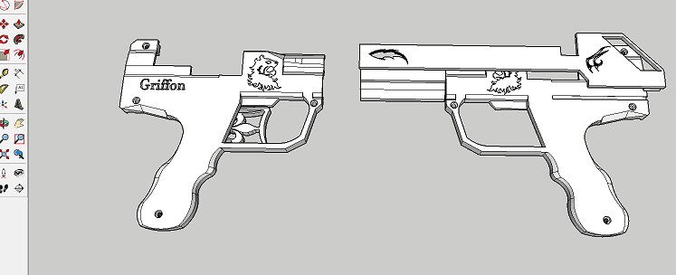

Due to the recent pandemic, I got a lot of time to work on the gun...
First, to hell with the ugly grips and balance point, I 3D design a new grips and a ''shotgunish'' pellet recharge system, it was hard to get the exact measurements, and also need to cut one screw or another and put a 2nd trigger (enourmous) in a more advanced position.
Second, I want POWER, don't mind if I get 10 or less shots per fill, I want that .177 to go supersonic and penetrate anything, cause I want a small game hunting gun apocalypse ready.
I open all the ports to 4mm with a mini dremmel, upper one in more larger shape to not affect the pellet, also grind the valve rod at the part that pops to allow more air flow trough the valve, and grind the back end of the valve rear that is striked with the hammer to open it more time. Don't have any idea of what fpe to expect... didnt have a chrony either...
Working on the ''Griffon'' freakish remodel of the PP800, I will upload pictures when it's done, and results when I can test it out.
