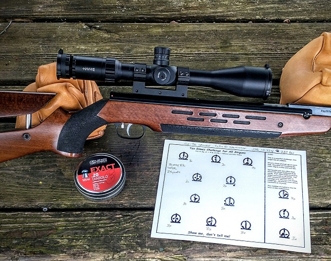

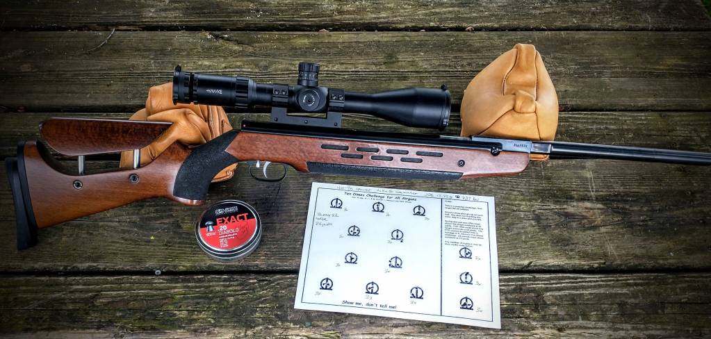

She is easy on the eyes. Notice the nice screw cups and other touches that a professional tuner adds to his work.

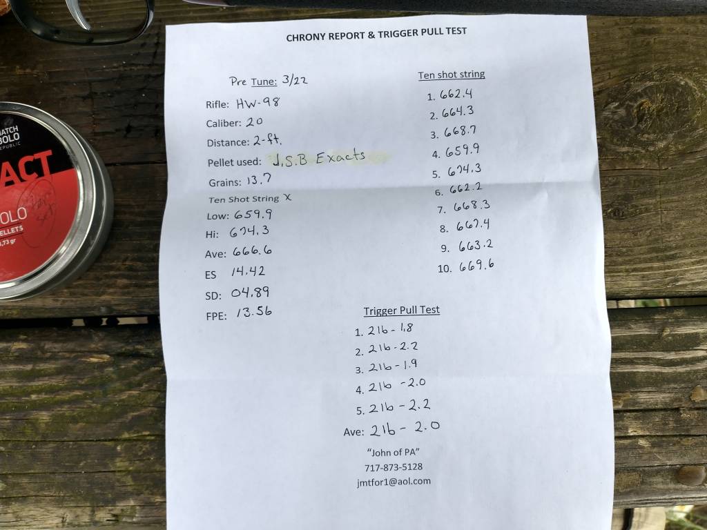

The ES and SD above are as good as it gets. ES is 1 percent of average velocity and SD is less than half a percent of muzzle velocity! There are a whole lot of PCPs that can't do that.

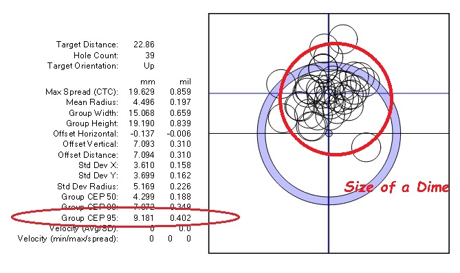

She shoots eighteen percent harder and somewhat better. ;) . In seven out of the 13 groups all three pellets are touching. There is no longer any spring buzz. The trigger was good already. It now breaks like glass. There is absolutely no sound while cocking other than the "snick" of the piston locking up. John does as good or better work than any other tuner in the business. That's a professional, right there folks. Just brilliant.
Did I mention easy on the eyes?

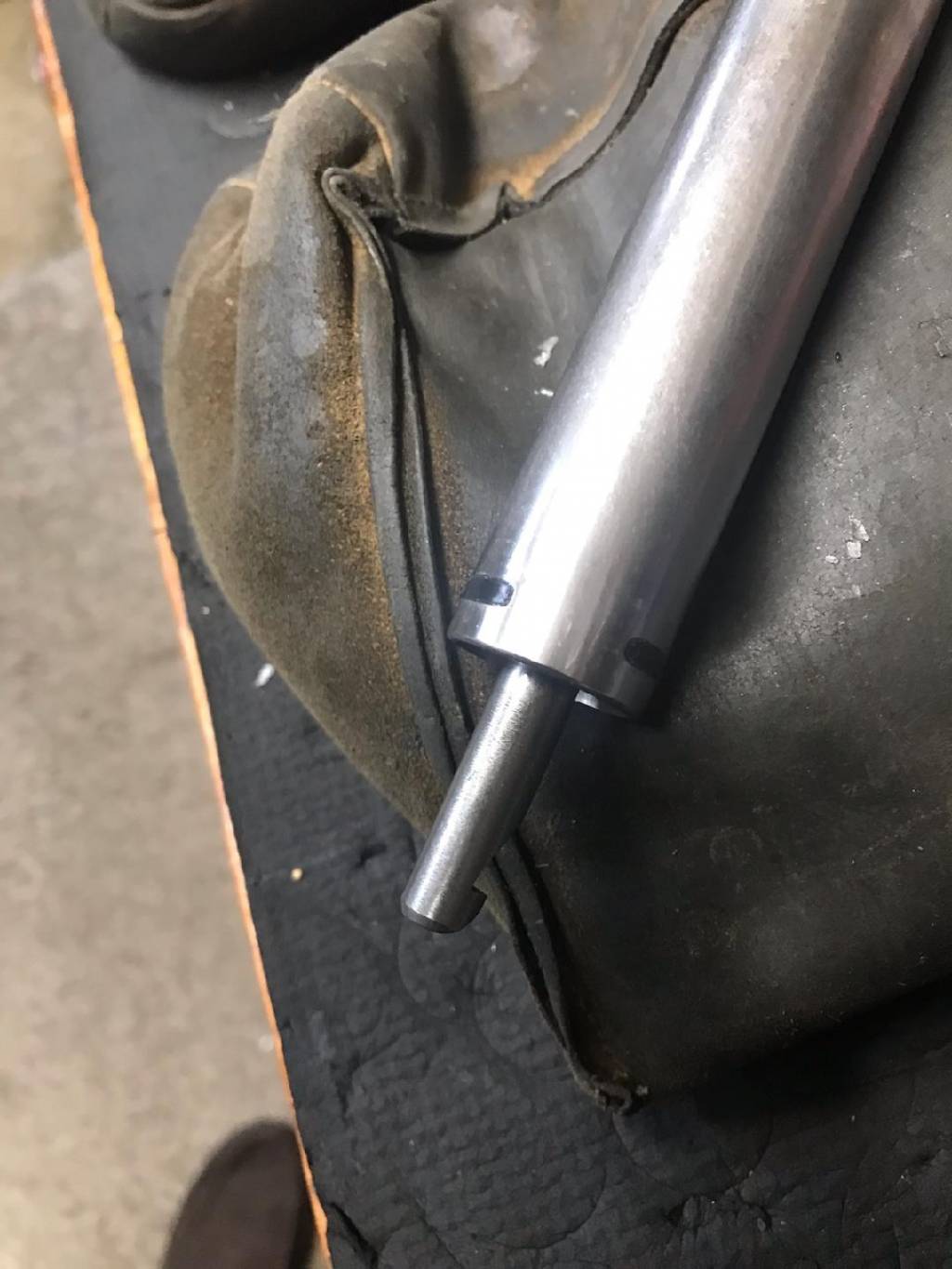

Is that a urethane insert or something he installed? Was this part of the tune or an additional charge?
You know I don't know if that was part of the tune or if there was an extra charge for it. When I send a gun to John I tell him to give it the "works". I have never gotten one back from him that I was not 110% satisfied. I have a d430 at his shop right now. He has done three Diana's and the 98 for me to date.
Those are delrin inserts in notches that he cut into the piston.

Oh my that’s the perfect springer right there, it is most definitely easy on the eyes! And the adjustable cheek piece is very nice. Plus it’s obviously an excellent shooter too. Are you using the lighter .20 pellet?
That’s just a perfect little rifle, and I can imagine how nice it cocks, John did my HW30 and it’s just so sweet! Thanks for sharing.
Reactions: OldSpook
Hi Dave, I don't believe I missed this. Yes I was shooting the lighter pellet. Hope this finds you well, sir.
