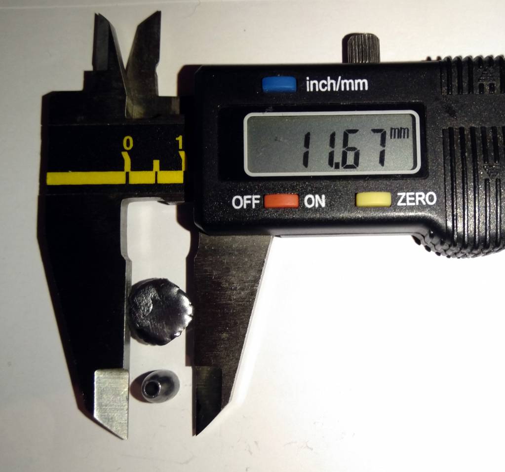

Shooting a slug into a barrel of water produced this .... ouch
