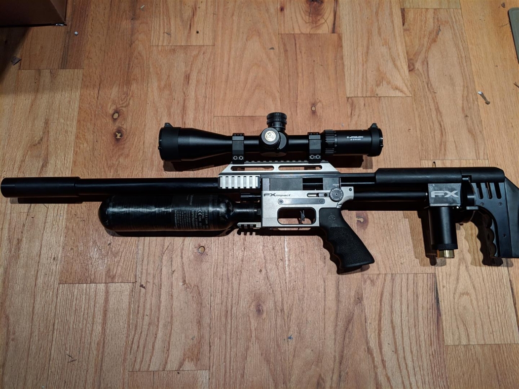

I just got my gen1 back from Ernest and it's rockin 100fpe! 148fps w/ a 50gr. Though the 44gr fly a little flatter so I may switch over. Really need some time at the field getting used to all the new power it has. All this w/ a reg setting below 140 bar.
Hope he doesn't mind my sharing the list of things he did, as you can see it's a pretty extensive list. What's not on there is the plenam extender shown in the pic. I do like the short barrel, but would love to try a 700mm STX barrel and see what it can do. $440...
