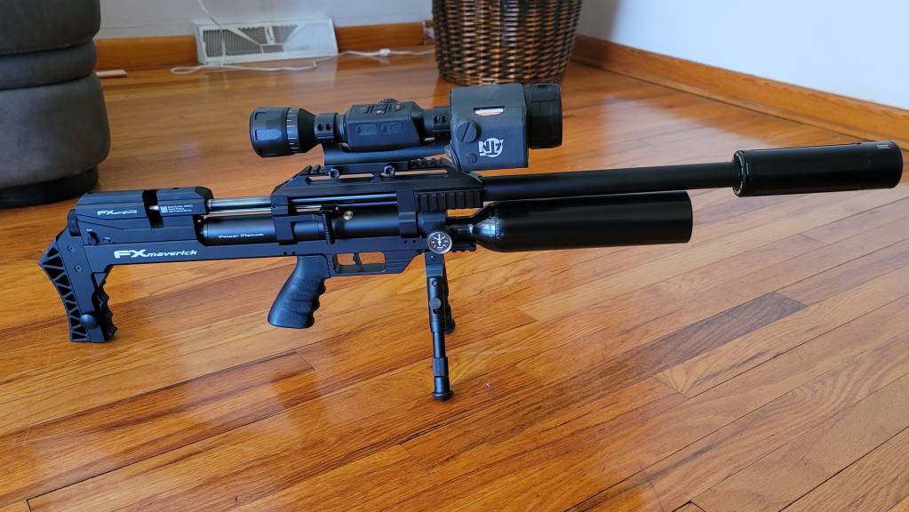

So I received my Maverick VP .30cal yesterday, thanks to PyramydAir's fast service and shipping. Doing initial sight in with JSB Exact 44.75gr had me quiet excited, as I never had an airgun with such accuracy before 😃! The only thing was lacking was the velocity was right around 850 fps, and although the accuracy was insane, I needed to tune for higher power levels.
Out of the box, the rear reg was at 100 bar, while the front reg was at 145 bar. So I raised the front reg to around 180 and the rear reg to 145 bar.
After that, with my hammer spring on 7, my velocity went down to 730 fps. At this point, I think one of the regs is set to high to overcome the hammer spring, but which one? Should I reduce the reg nearest the bottle or reduce the reg near the power plenum?
Thanks for any assistance in advance! 😃

Here is my answer (from my exact same experience) from receiving a .30 VP a few weeks ago and owning a .22 Maverick Sniper for a year. I also struggled with tuning at first, on both, but I have learned a lot about the platform in the last year, and quickly was able to get the .30 VP sorted out.
Anywho -The VPs are coming with a 12g hammer, confirmed on both mine and my friend's new .30 VPs we received in the last few weeks. Unfortunately this will not be enough hammer weight to smack that valve open at 150 bar. You need a 13g hammer weight. You do not need a dual transfer port. You do not need a stronger hammer spring. You don't even need the slug probe (I just used the stock probe for now).
Now, your two real options for getting a 13.25g hammer are either 1) buy the FX Maverick Slug Power kit solely for that hammer; or 2) buy the Huma hammer weight kit (13.25g & 14.5g), which I'd recommend as the better option. Myhighpressureair.com has them in stock.
To get the exact power you are looking for I simply set my regs to 175/150, PW7, HS 6mm out, 13.25g hammer weight. Seems 175/150 or 180/150 is the sweet spot for the 30's if you want to make pretty high power.
