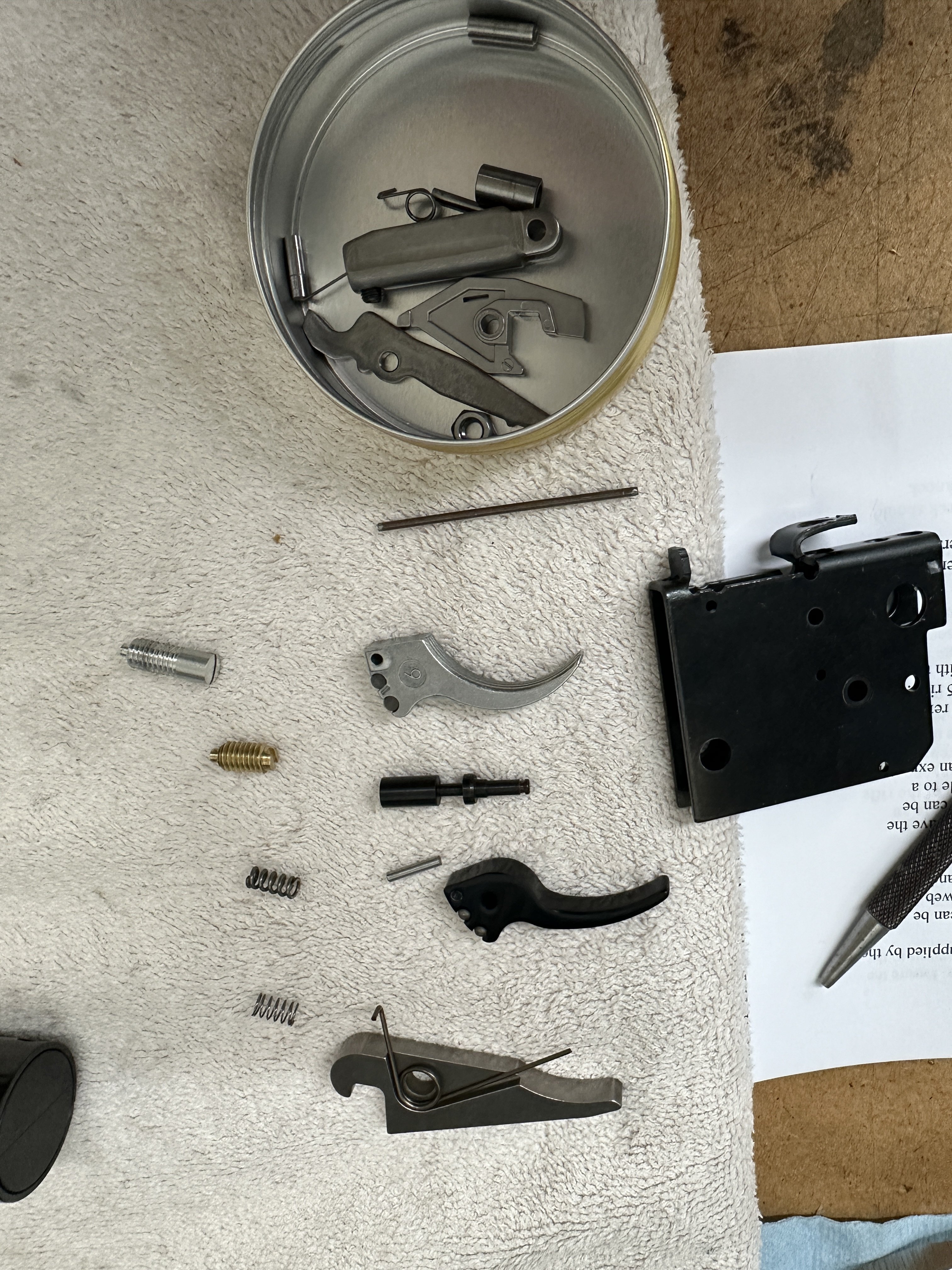

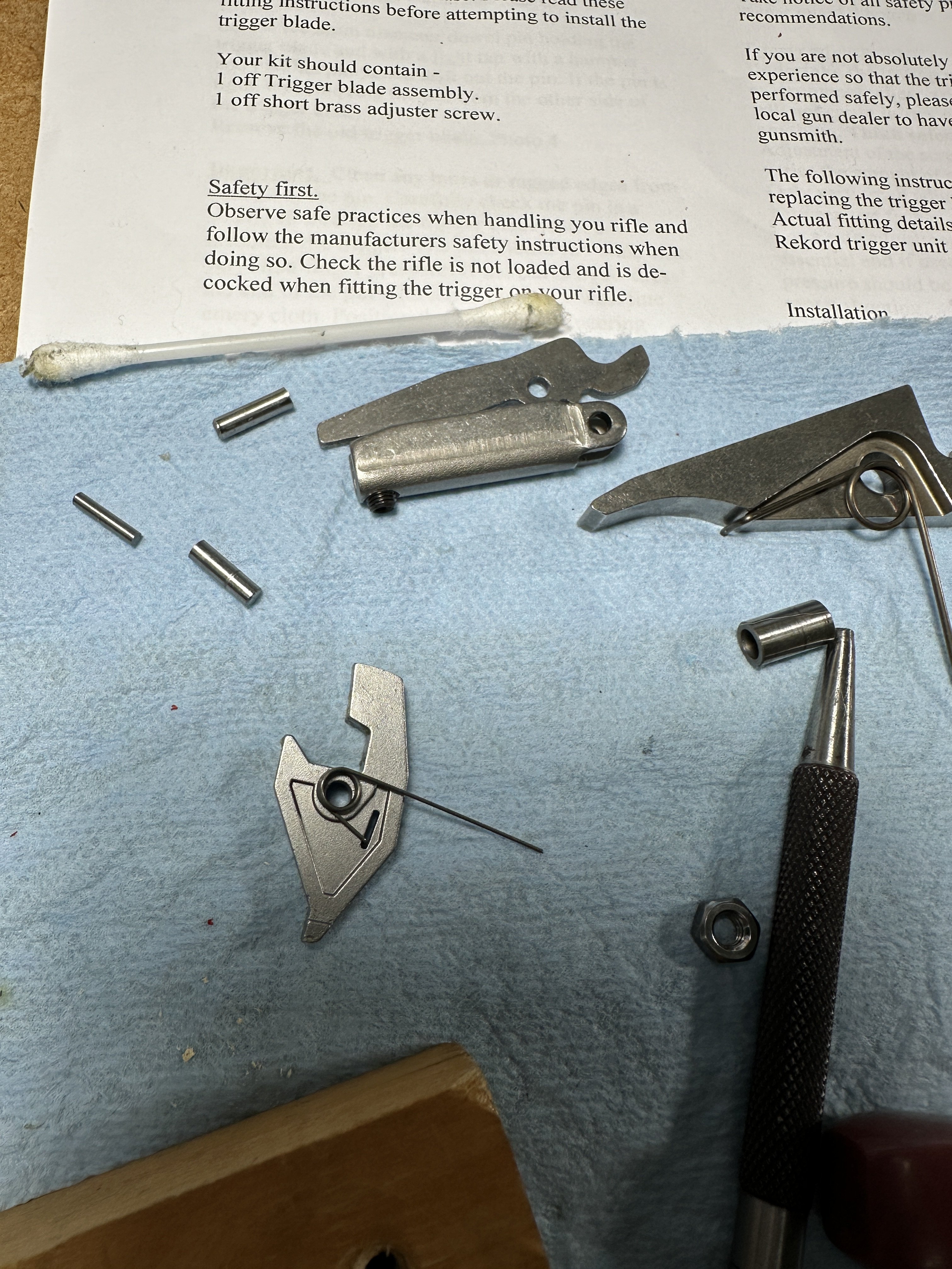

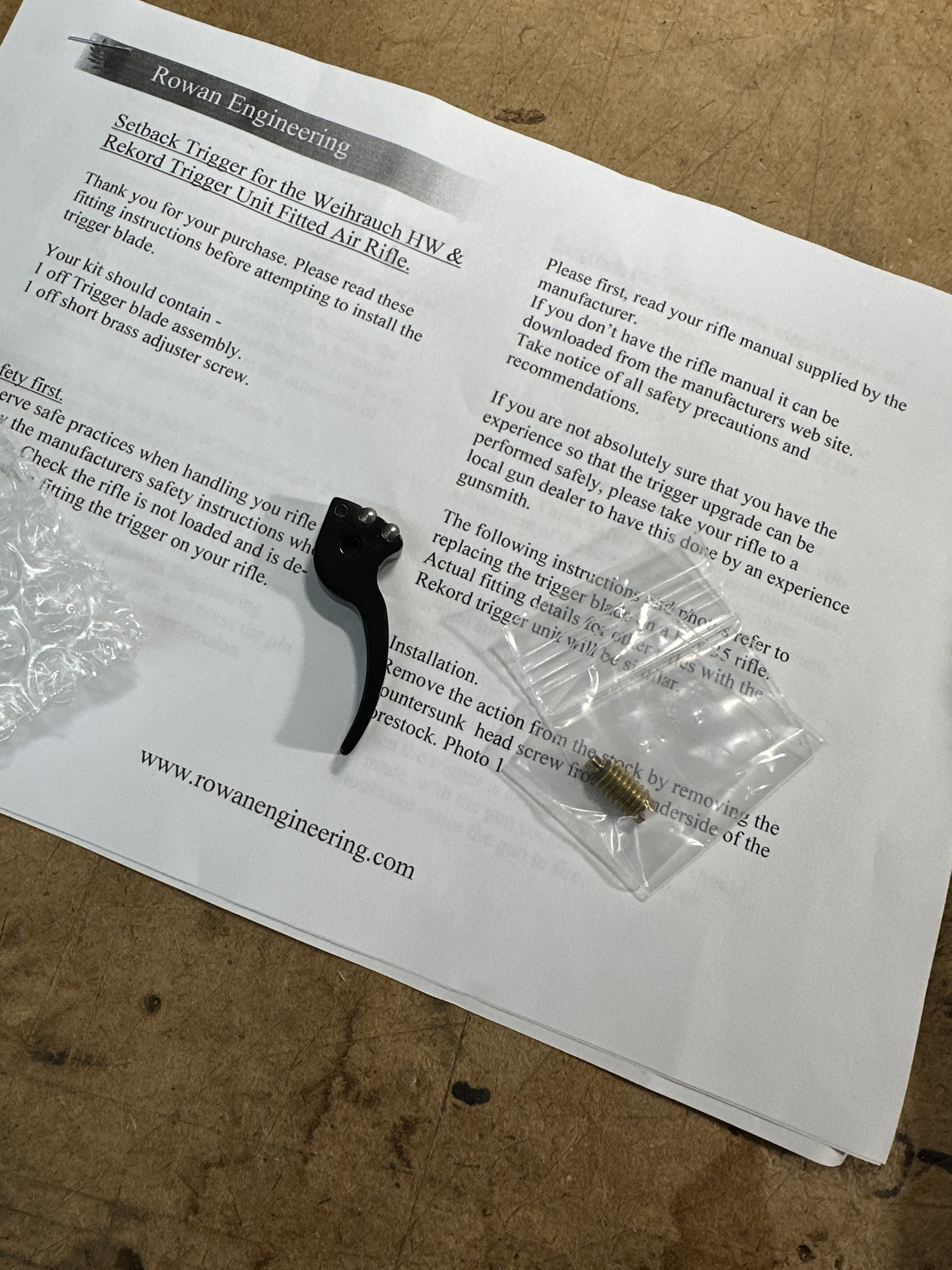

My nephews HW30 is done and all packed up. Now it's time to work on my 30. I'm starting off with the trigger, I'm installing a rowan set back trigger blade and it should be easy, but it wasn't.
I removed the factory trigger, then tried to fit the rowan. First the pin wouldn't fit, but that's expected because of the peened ends, so I polished the ends and got it to fit thru the rowan
blade. Then when fitted in the trigger housing it was way too sloppy side to side, so I measured it, and it's .030 narrower than the rekord blade width. In the past I've had to shim these up, but it's usually only about .005 to .008 per side.

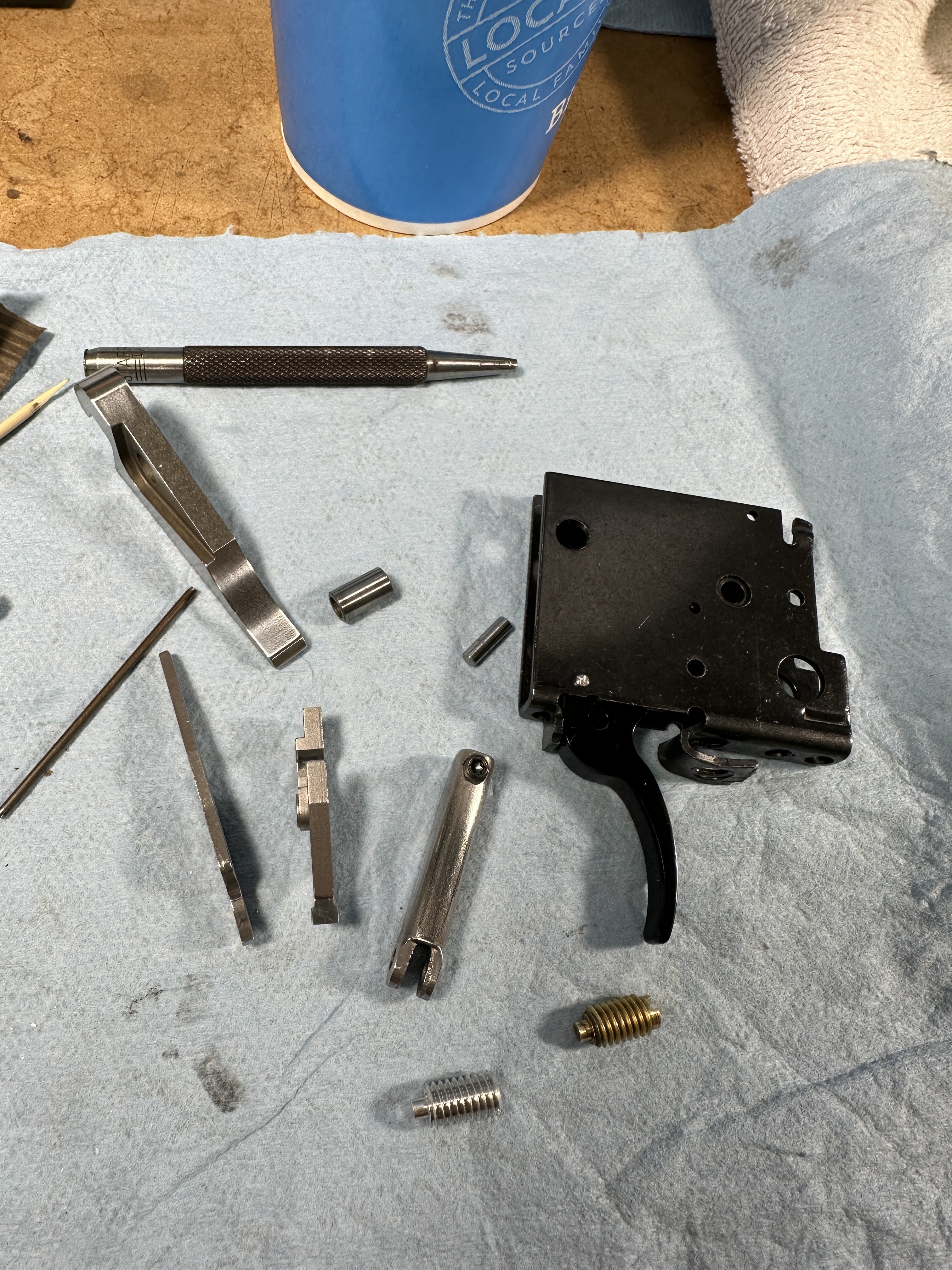

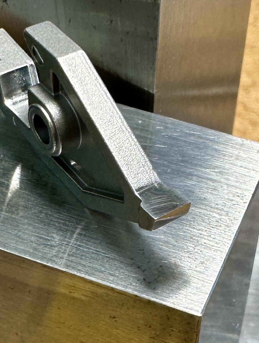

At this point I decided to just take the whole thing apart and polish the sears and do the whole thing.

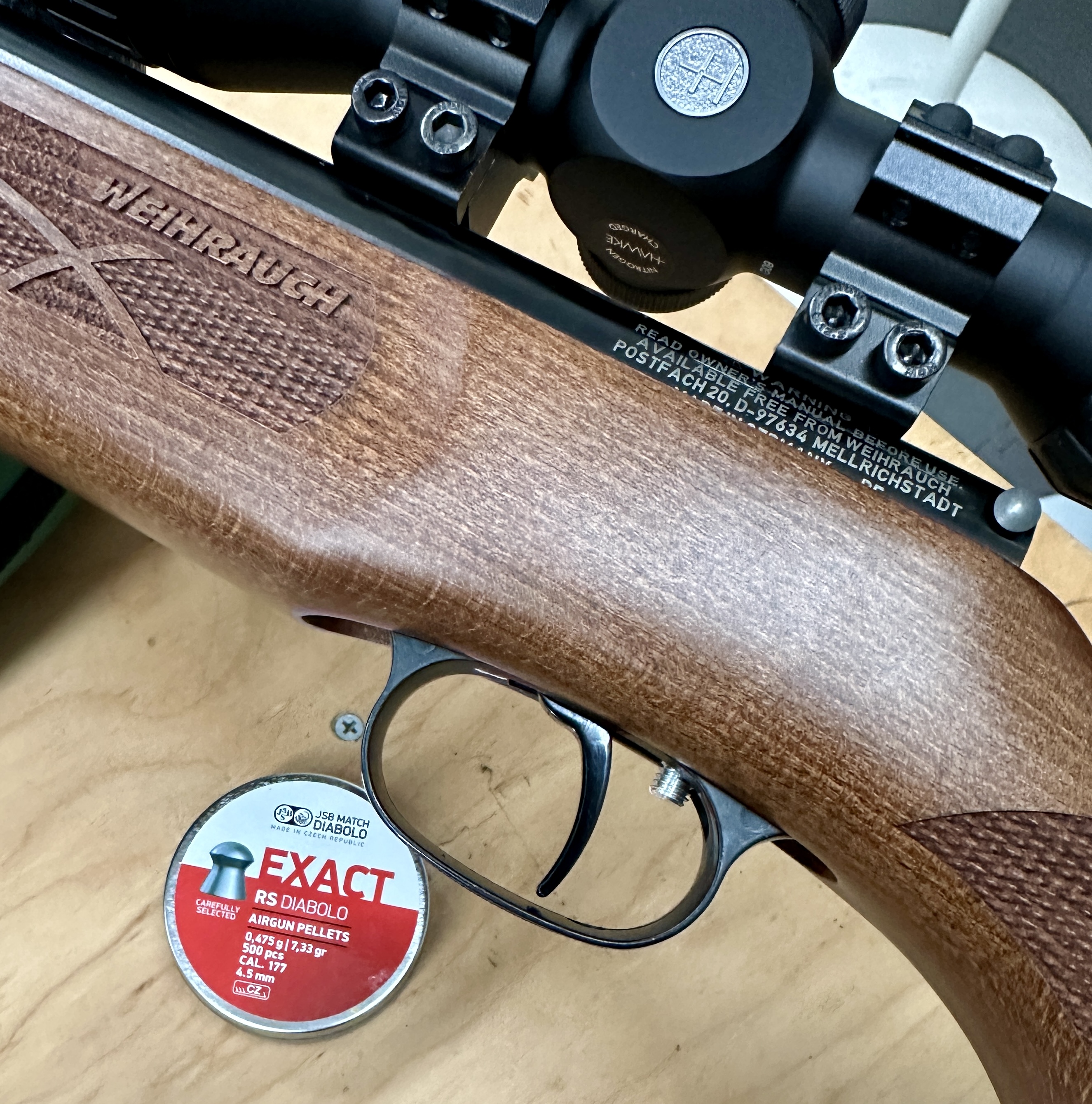

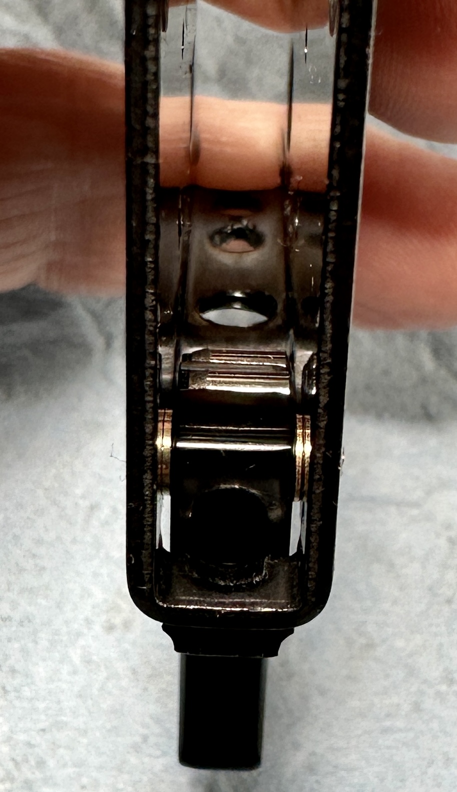

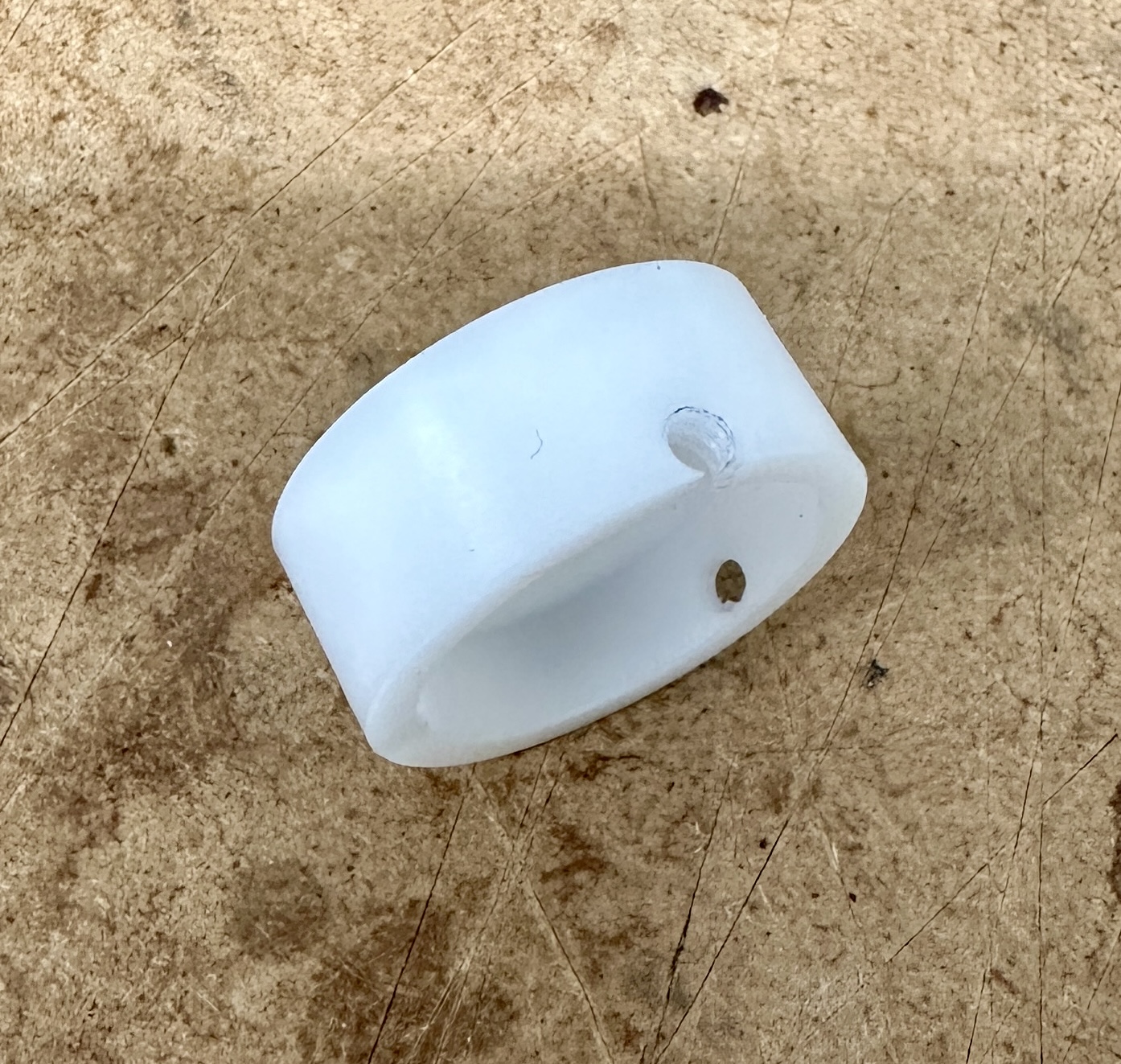

So I machined the small washers/shims out of bronze, I made them about .016 thick and lapped them to size for a snug fit. Here's a look from the front after installing the rowan blade and washers.
The fit is really nice. So then I started on the sears, I used 2000 grit wet and dry, and used alcohol for my wet. Spent most of the afternoon on and off finishing everything, then reassembled it. lubed with remoil and removed excess.

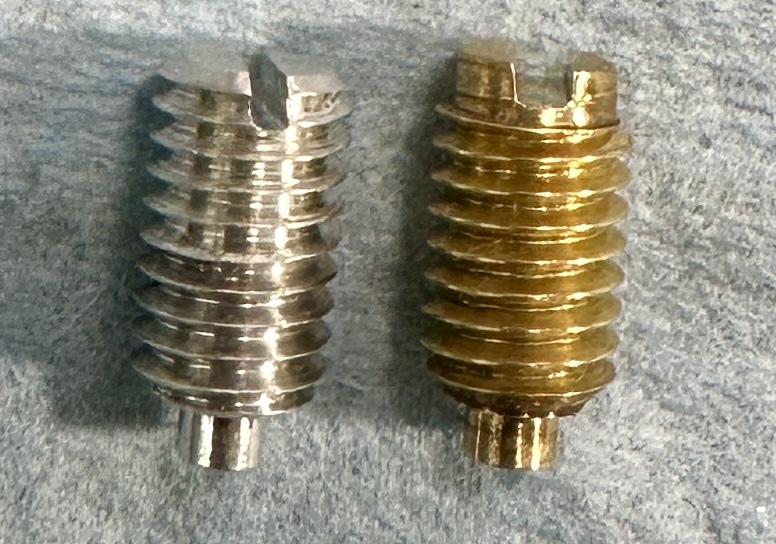

Oh, and the rowan brass screw was smaller in diam than the aluminum factory screw, and way too sloppy. So I just cut down the aluminum screw and re slotted it. Then adjusted the tab for a snug fit.
It turned out good though, and breaks clean averaging 13oz. Feels nice and closer to my finger after pulling thru the first stage.

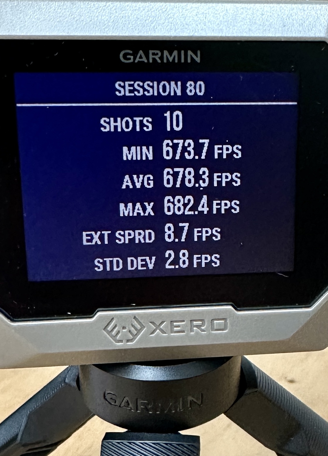

10 shot average with JSB 7.33's to compare later on.

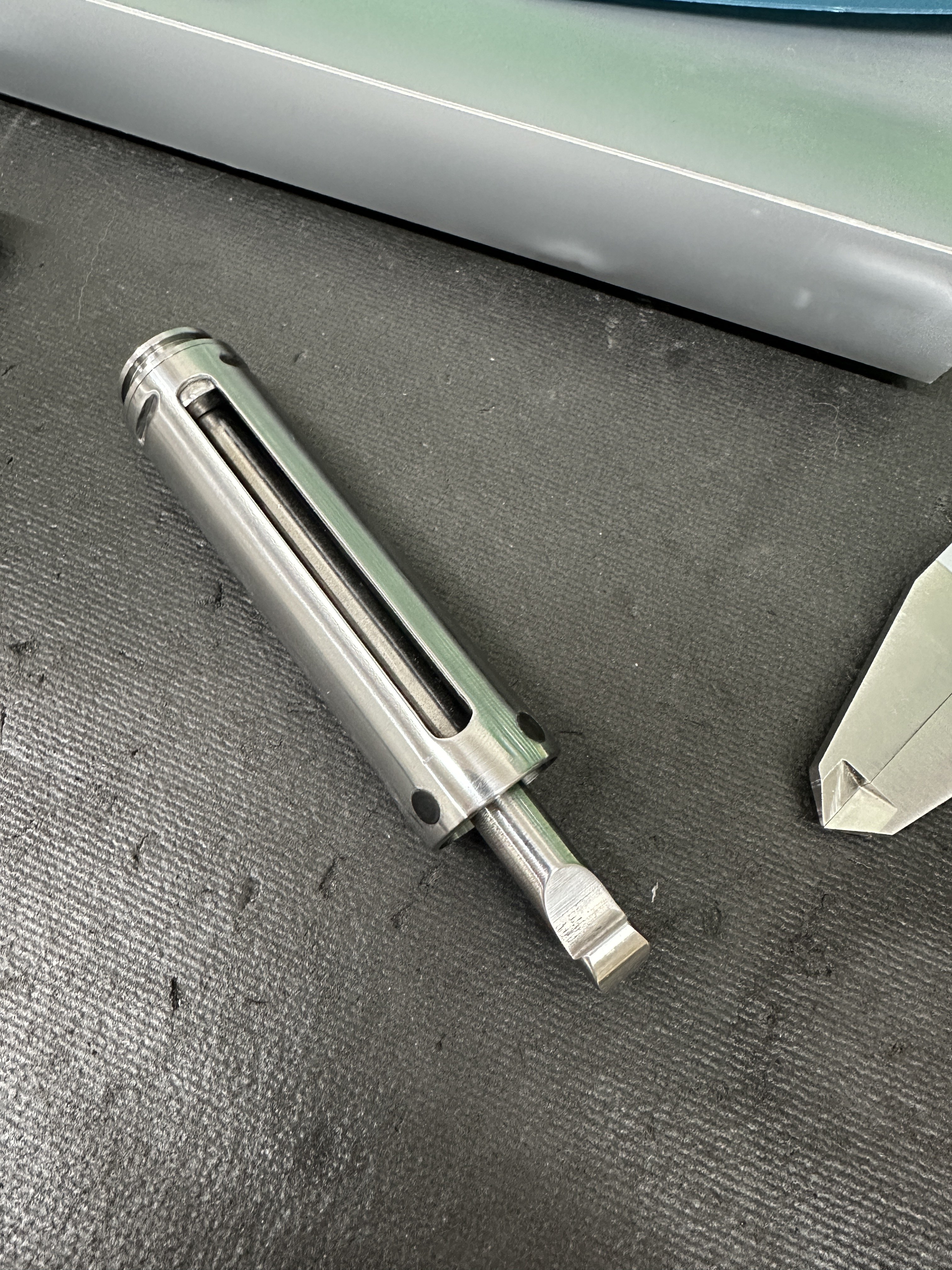

Failed 1st oring attempt, I think mainly due to, I used a lighter oring squeeze, because I was thinking this tube felt tighter using my feeler gage, after honing the tube out, (same restriction) at the weld as my nephews HW30.
.982 gage goes, .983 gage doesn't go. So I tried less oring squeeze.

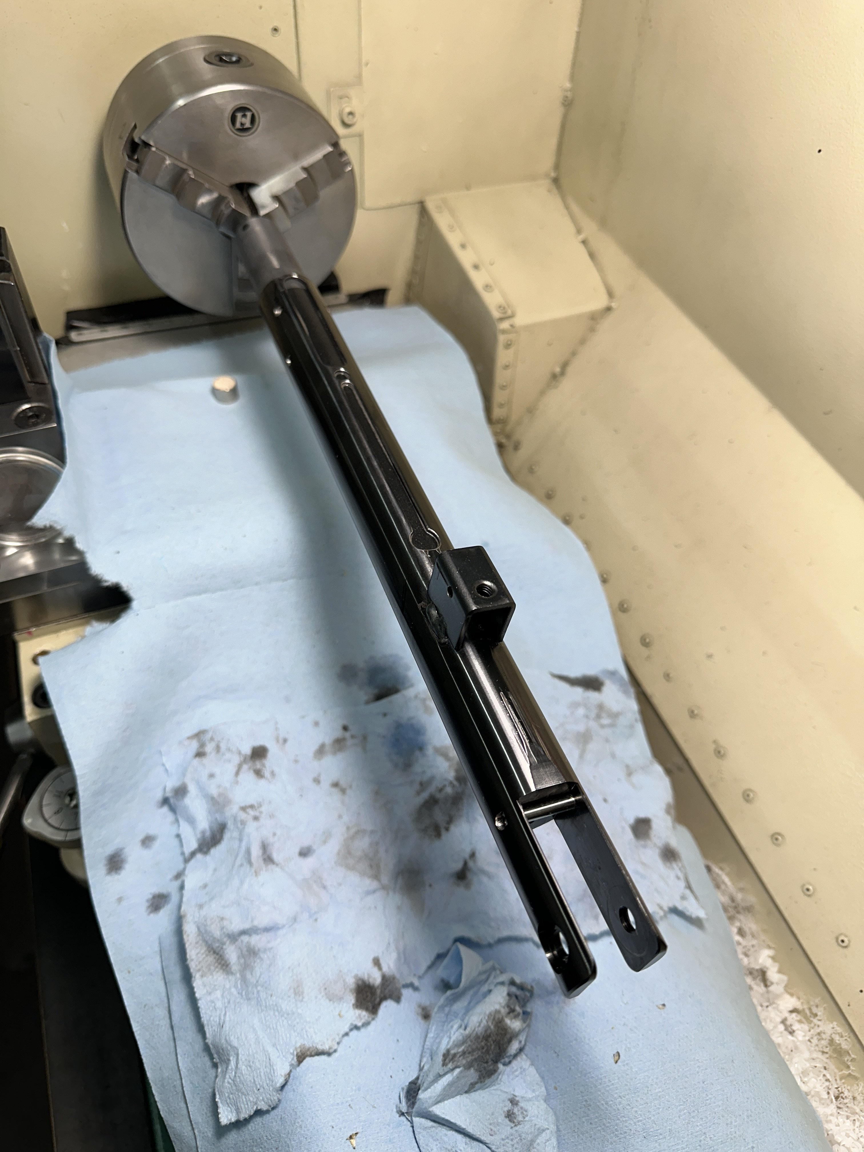

Anyway, here's the hone on my lathe.
Finished the hone, There was really bad tool marks, chatter in the bottom of the tube, I was able to get most of it out by super gluing sandpaper to the end of the hone.

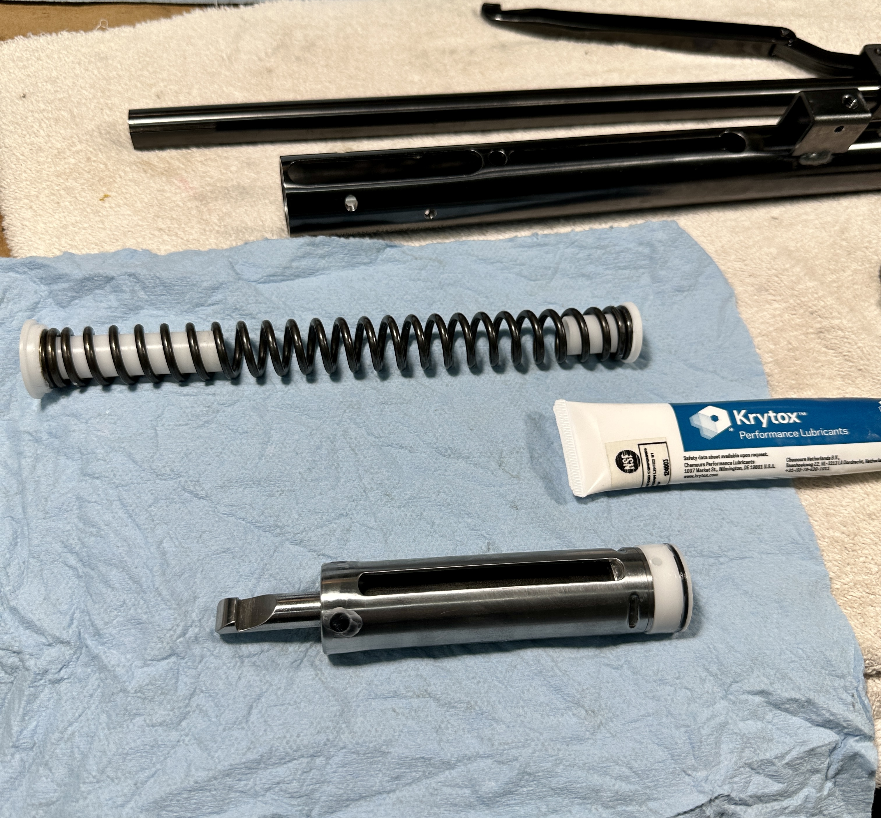

After that, I made new guides for the new JM spring, and also decided to button the back of the piston.

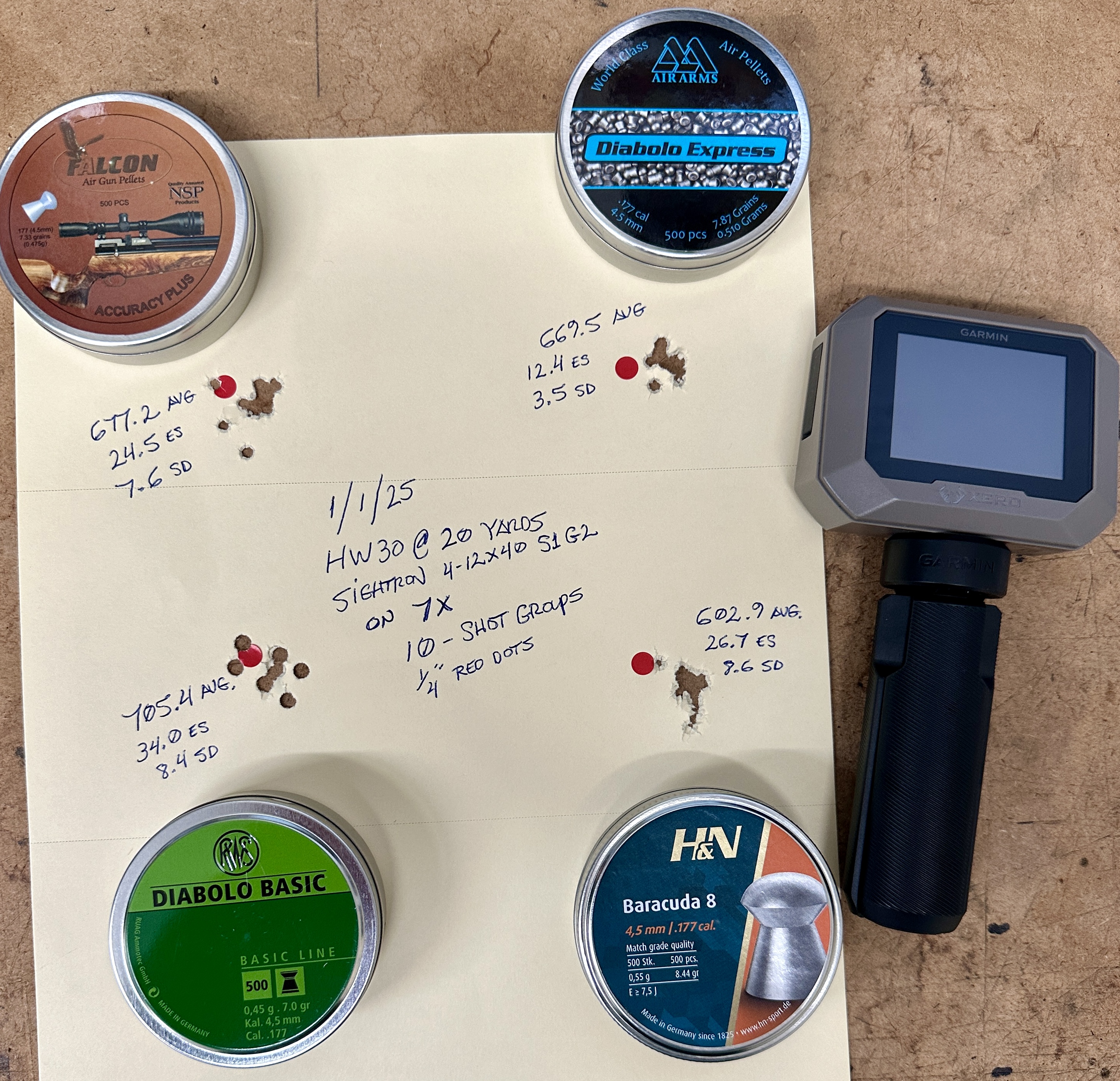

I tried to save it, but that wasn't working, so I had to start over again. I should've just went to bed.🤔 Today I decided to tear it back apart and install the HW parachute seal to see if anything changed, and shoot it some to take a break from working on it. The numbers are about the same, I did some ten shot groups at 20 yards..
The AA 7.87 looked the best to me. I'm going to revisit the oring seal and try more oring squeeze,

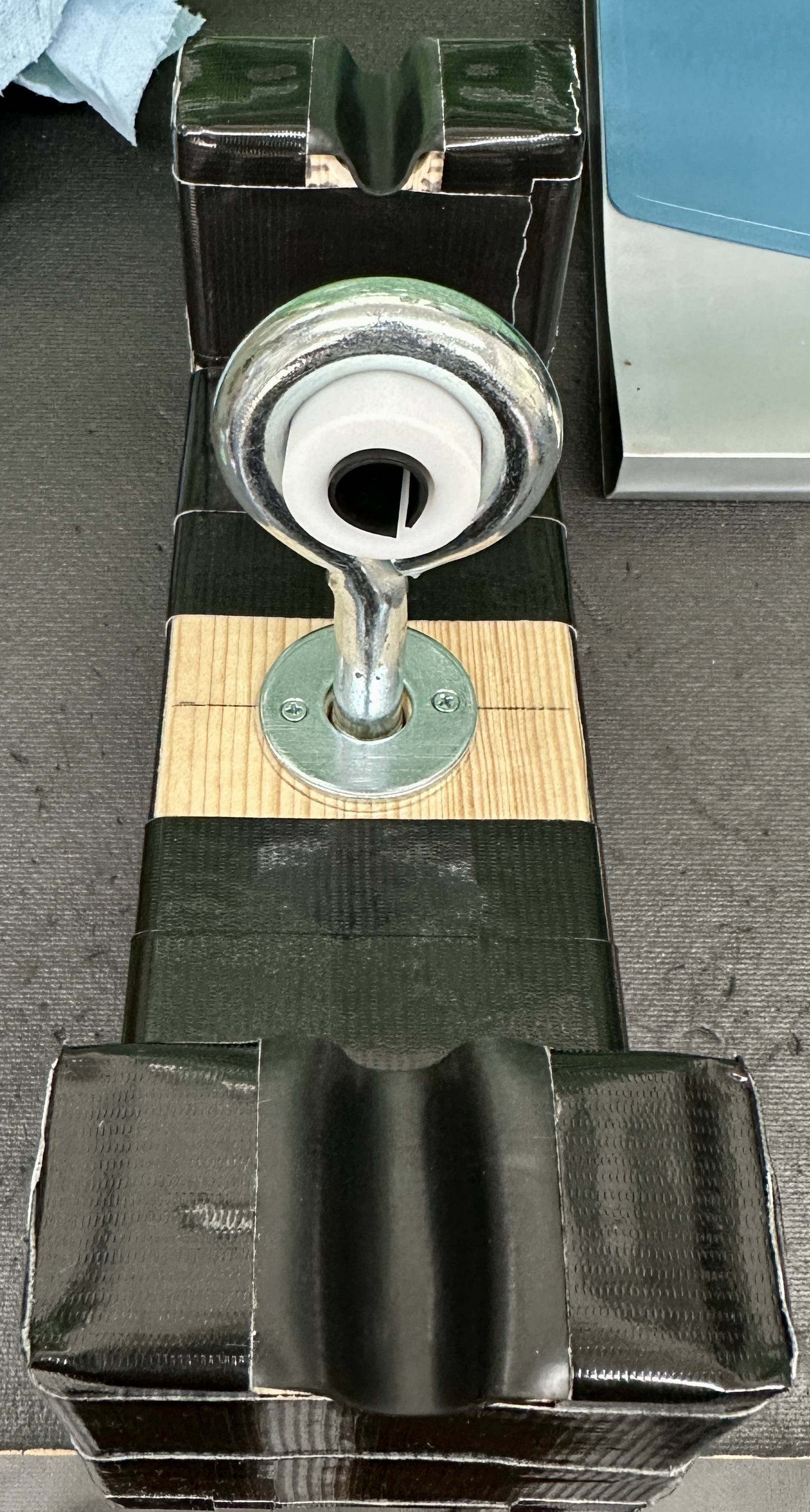

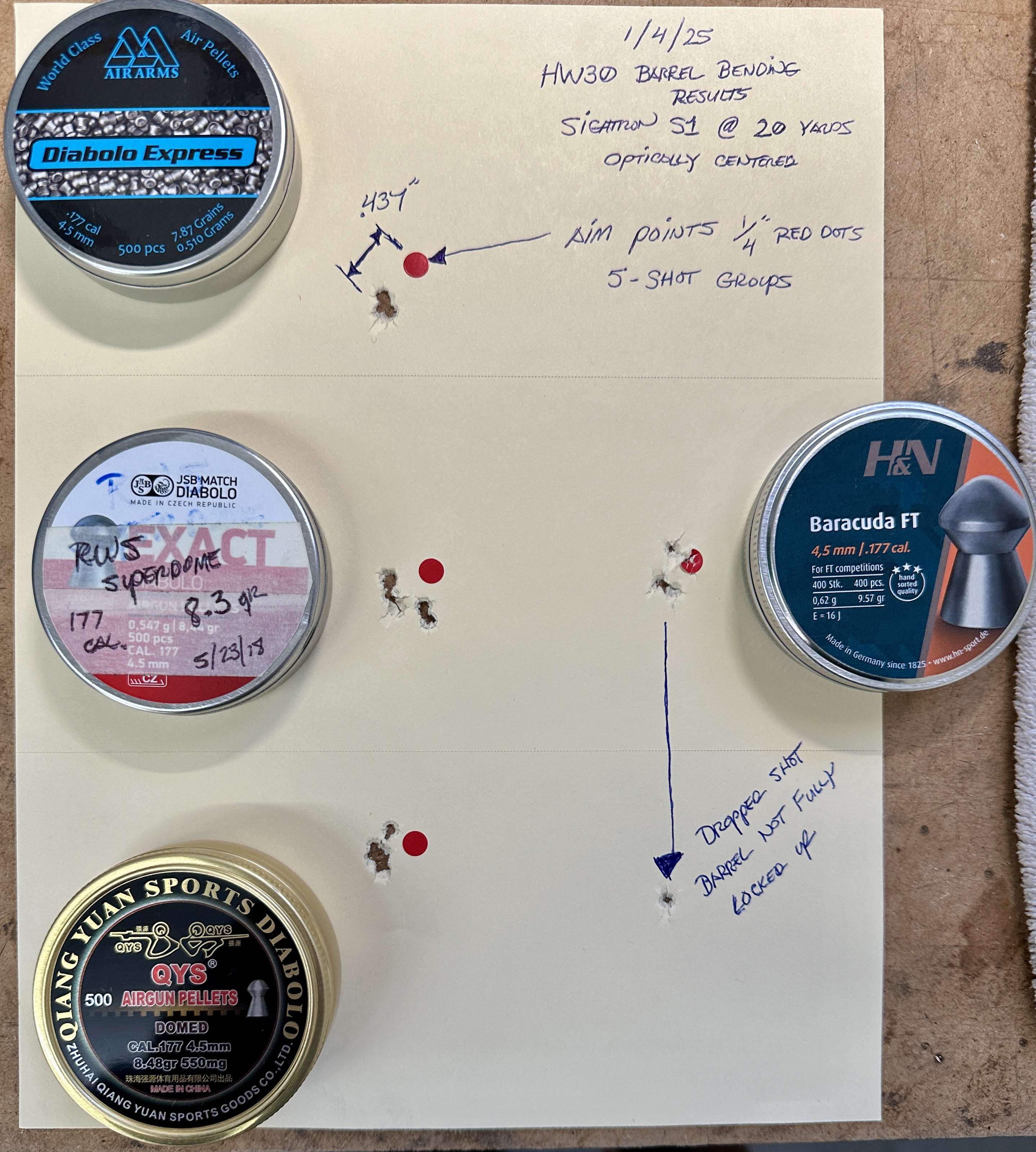

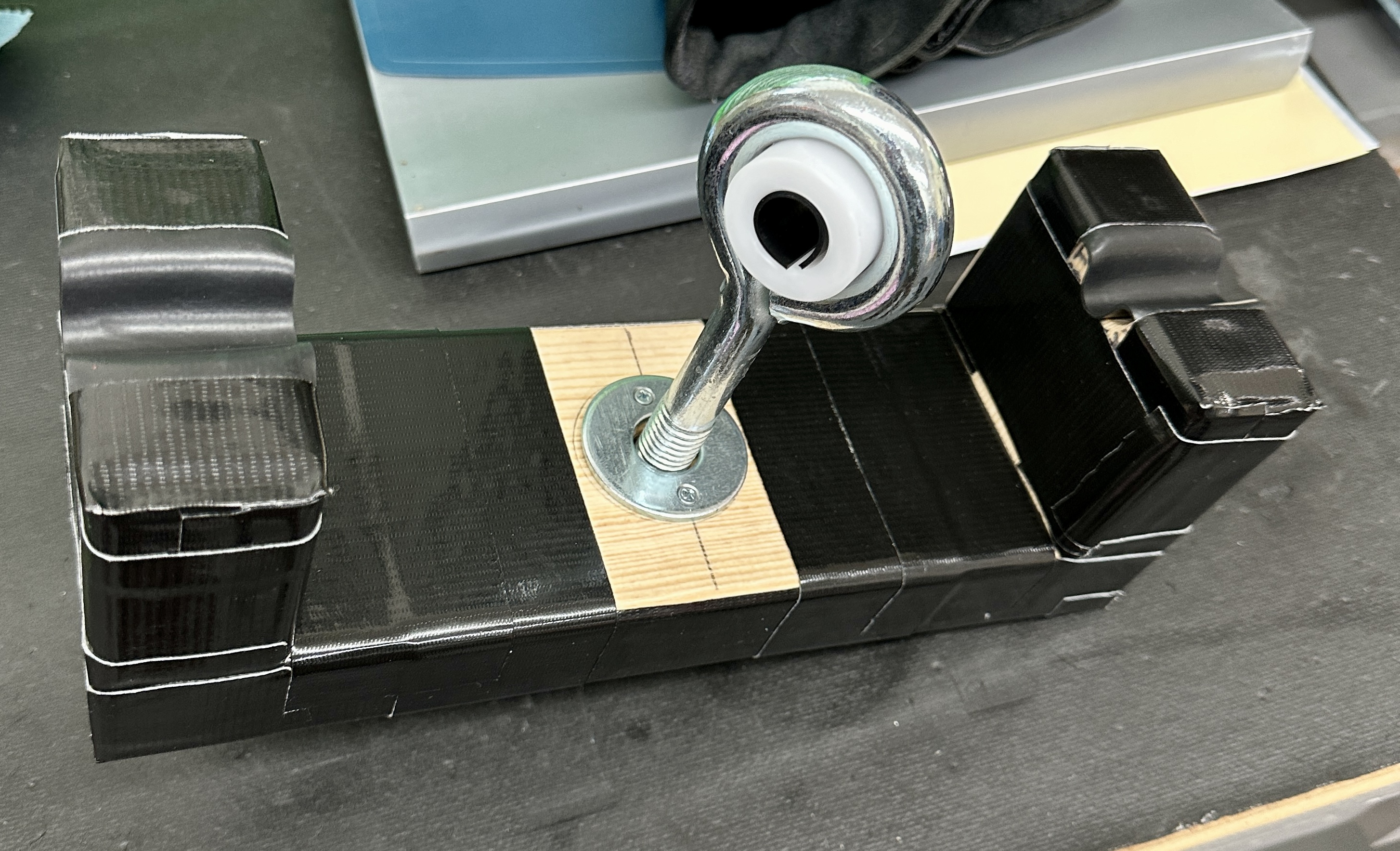

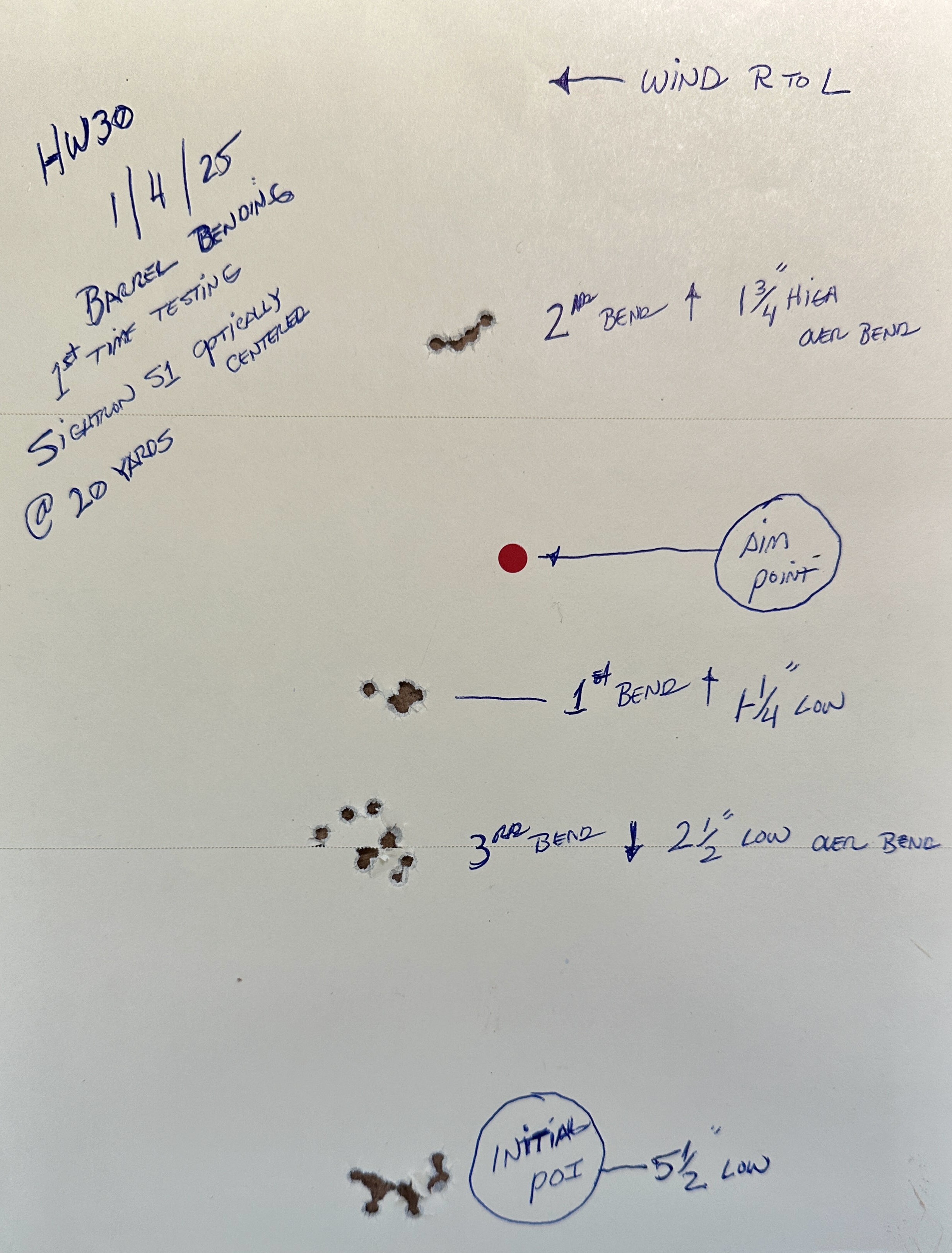

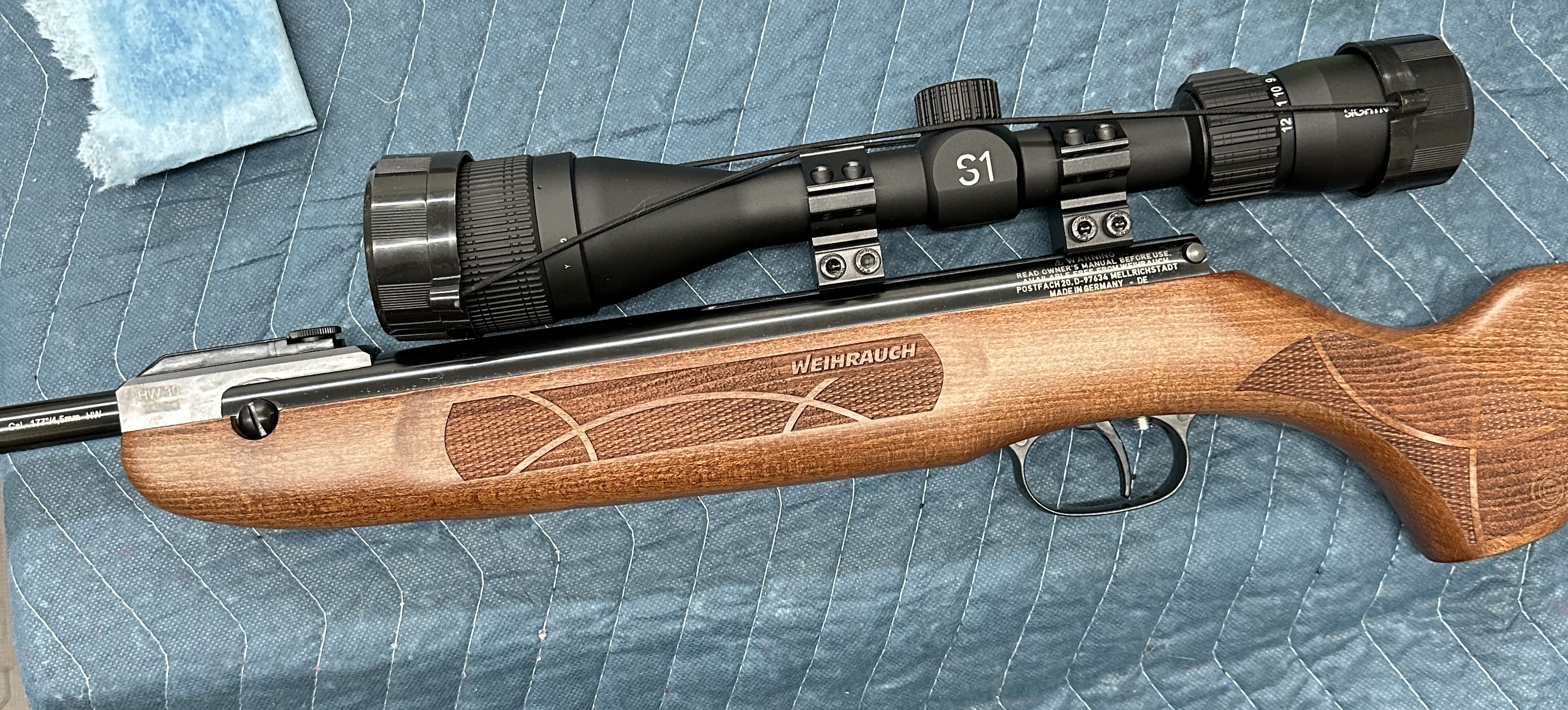

Today I tried my "clone" of Ed Canoles barrel tweaker on my HW30 at 20 yards. It was shooting low and to the left, but today it was mostly low and a little to the left, POA to POI with
the Sightron S1 optically centered. This is the first time I've ever tried bending a barrel, and it wasn't too bad, a lot of trial and error type thing.
Barrel tweaker I finished yesterday.
Here was the first attempts this morning
Then after several more adjust and shoot, repeat.
I ended up at less than 1/2" POA to POI with my optically centered Sightron, so, I'm pleased with that result.
No bluing was harmed in this experiment.🤪
