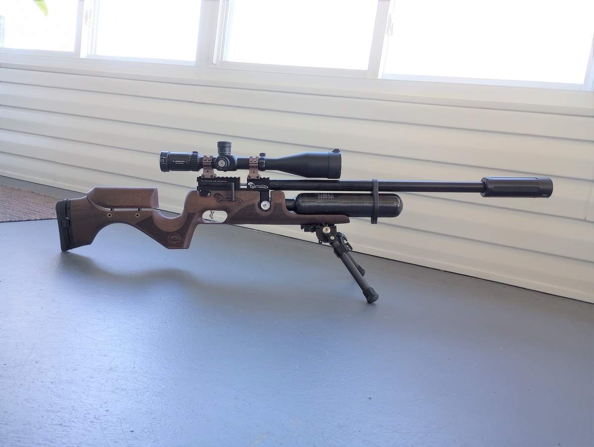

I thought I'd start a thread to chronicle my efforts to tune my Kral Bighorn .25 cal rifle for slugs. If you're not familiar with the Bighorn, it's an unregulated, PCP with a bottle max pressure of 250 bar and a choked barrel. I purchased it several months ago from Troy Hammer who had already made some changes to the power plant (modified hammer and spring, modified through port). Here's my Bighorn as she is dressed currently. (No, she didn't come with a barrel band or carbon bottle, I added those.)

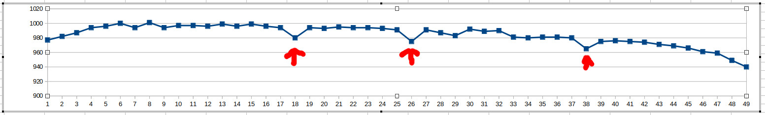

I wanted to shoot over a chrony but ran out of 26 grain Hybrids, so I used 25.39 grain JSB pellets. And here are the results:
On three occasions the shot velocity dropped 15 fps. I'm not sure what could have caused it. Defective pellets? Glitch in the chrony? Any other ideas?

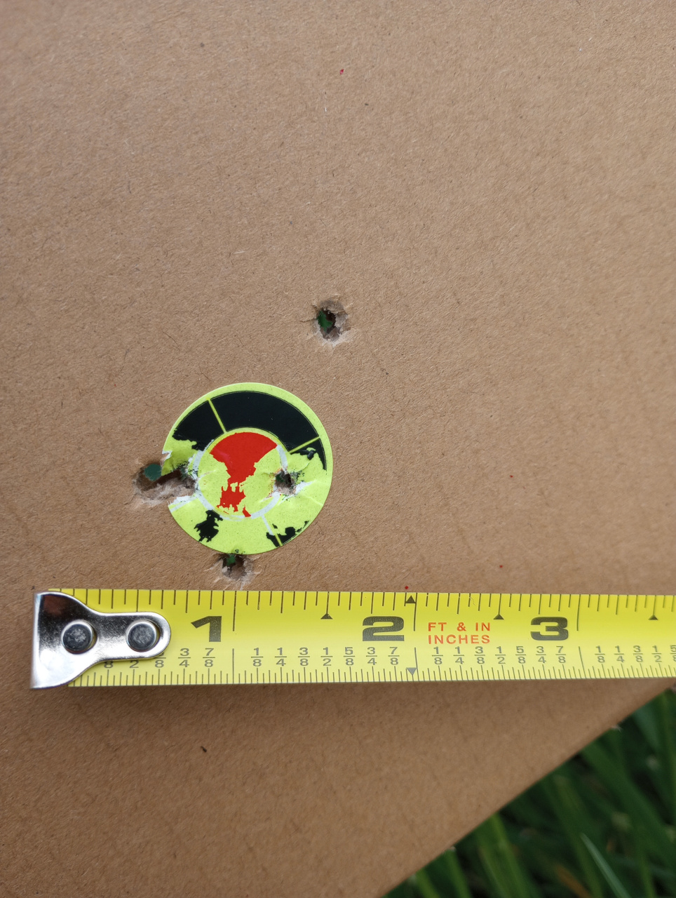

I shot 4 magazines at a 50 yds target this afternoon. Wind was 5-15 mph from my 5 o'clock. This was the best group. Shooting the JSB 25.39 at 950 +/- fps. Not horrible but also not great.
One thing I will say is that the trigger on this Bighorn is just where I like it. Very light and crisp.
Seeing as how a 15mph wind will blow a 25gr pellet 4” off its mark at 50 yards, I think you and your gun are shooting great. With 10mph swings in wind velocity, that’s not easy to compensate for and keep things tight. Possibly competition level shooting right there.

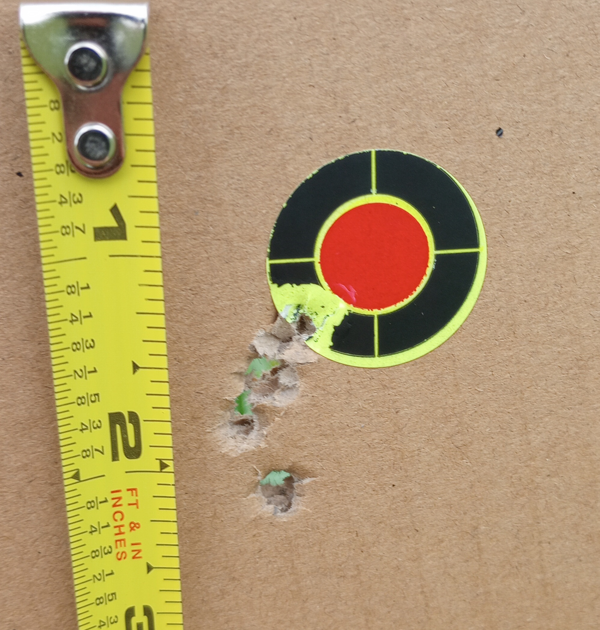

Then I shot 5 magazines of JSB 25.39 gr to 50 yds, light winds. To my eye, the groups looked about the same as yesterday. I believe that I'm at least partly to blame. This rifle is very hold sensitive. I normally hold a rifle loose and let it recoil freely. But I noticed that my groups shrink if I hold the rifle firmly and pull it into my shoulder.
Here's my best group today. Again, not bad but also not great.
