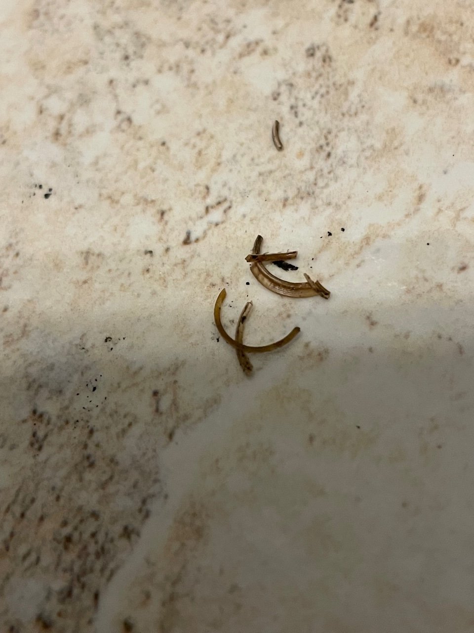

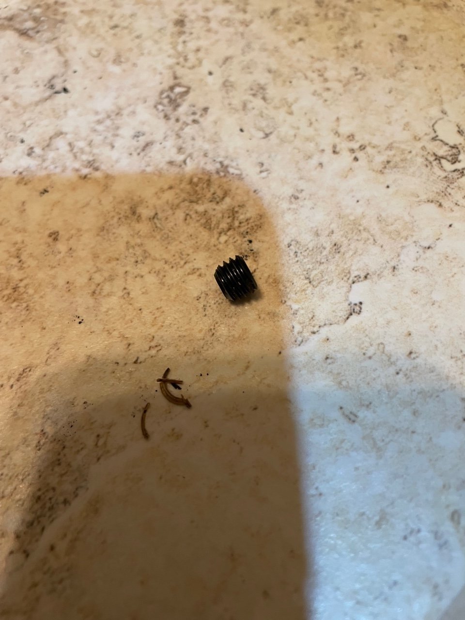

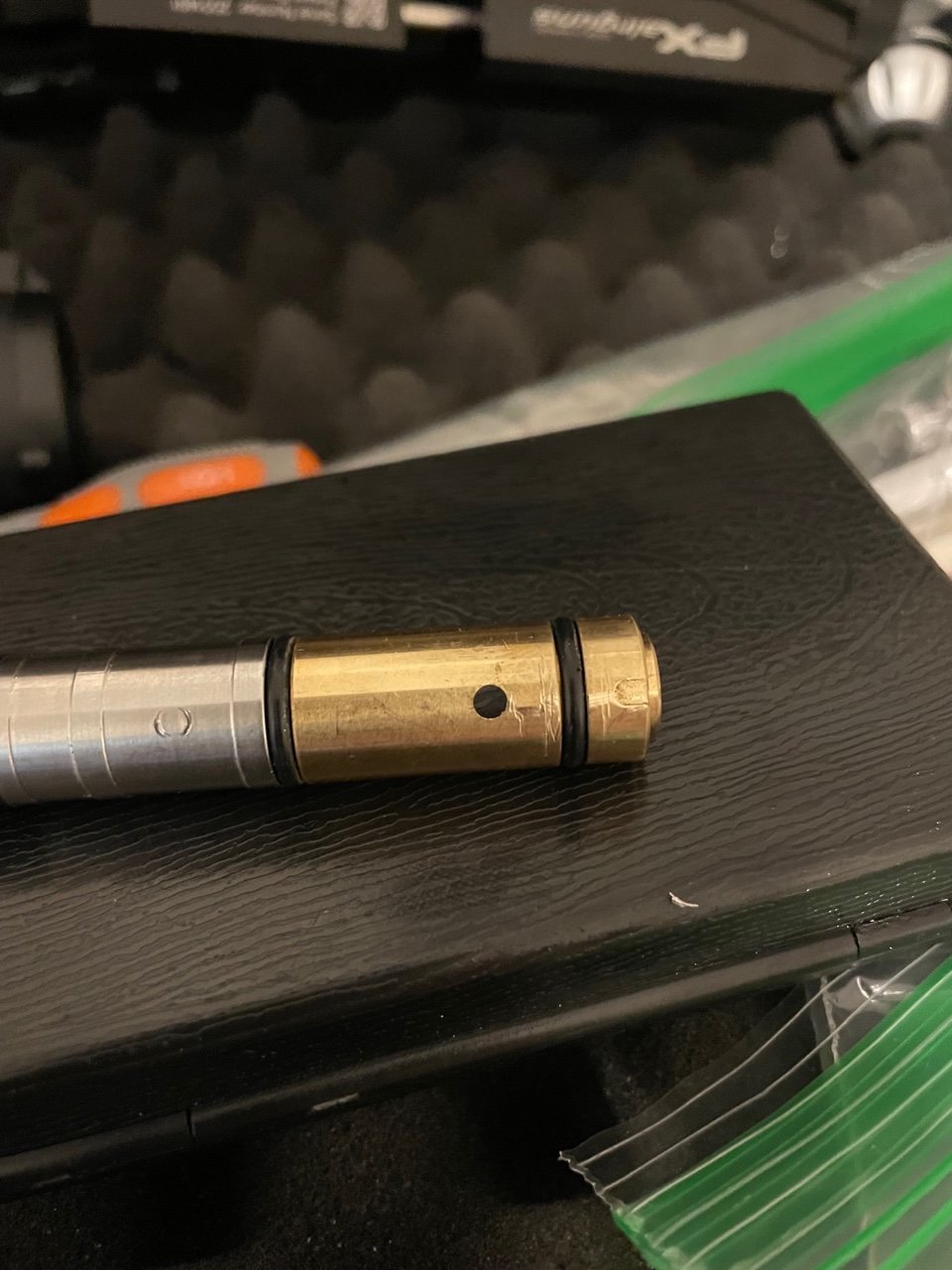

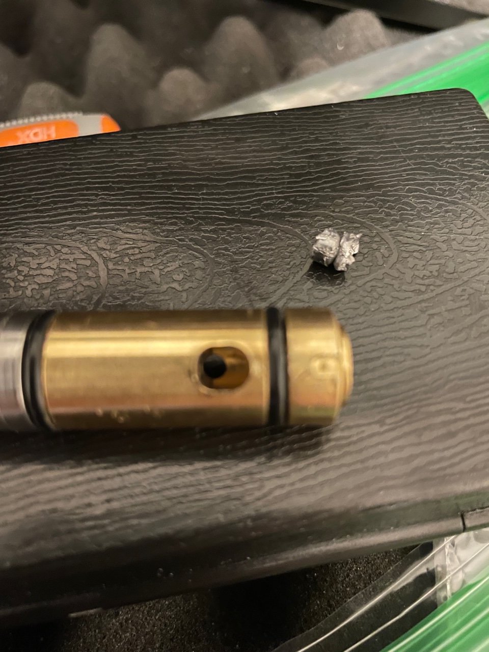

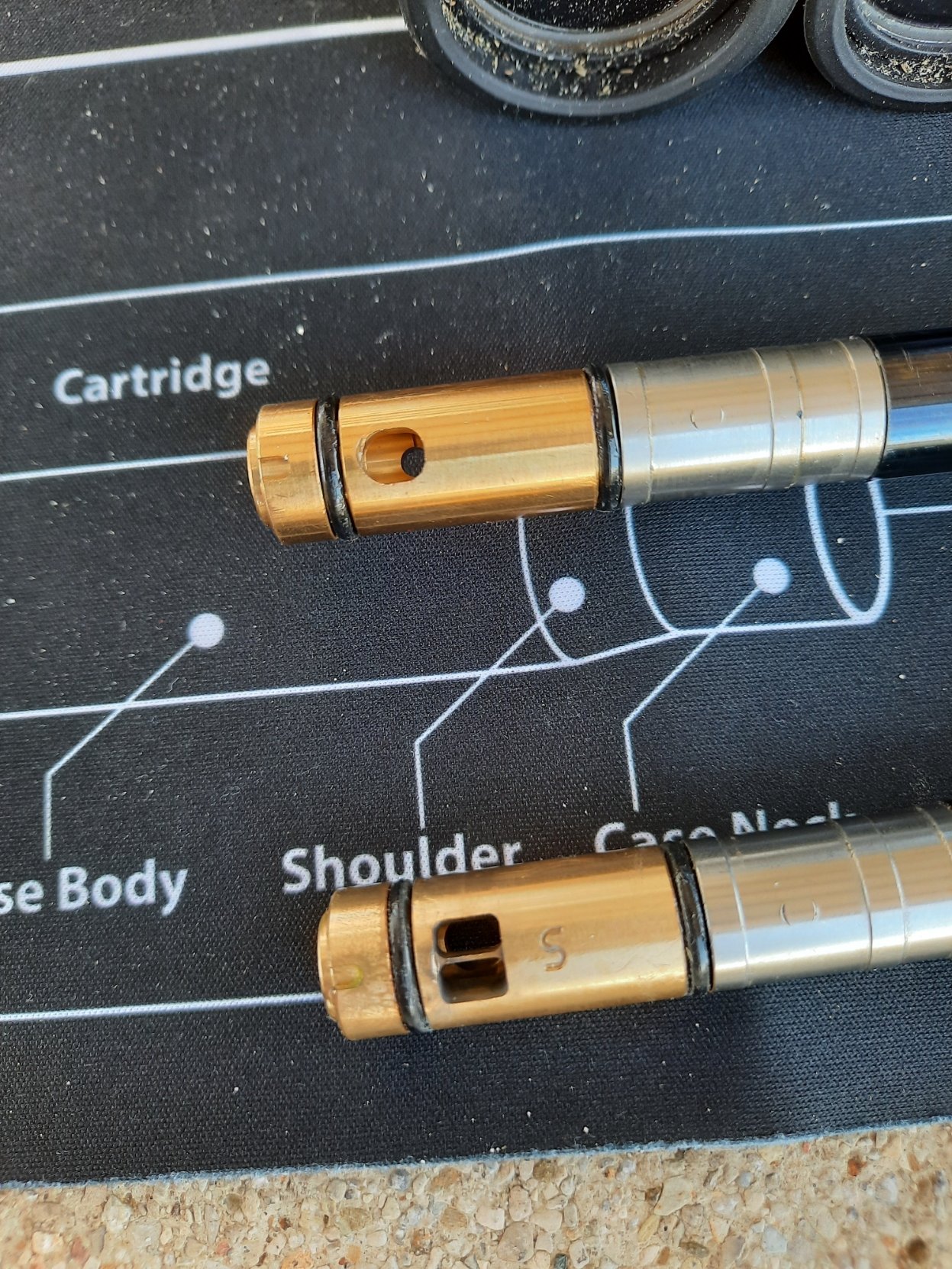

Here are photos after I put the larger barrel port in 6 o'clock position. Sheered a pellet and blocked the port. Also, the smaller port is shown. I removed the set screw over the valve section and some debris also cane out. I guess I'll need to Loctite this screw back in place to make sure it is air tight? Correct?

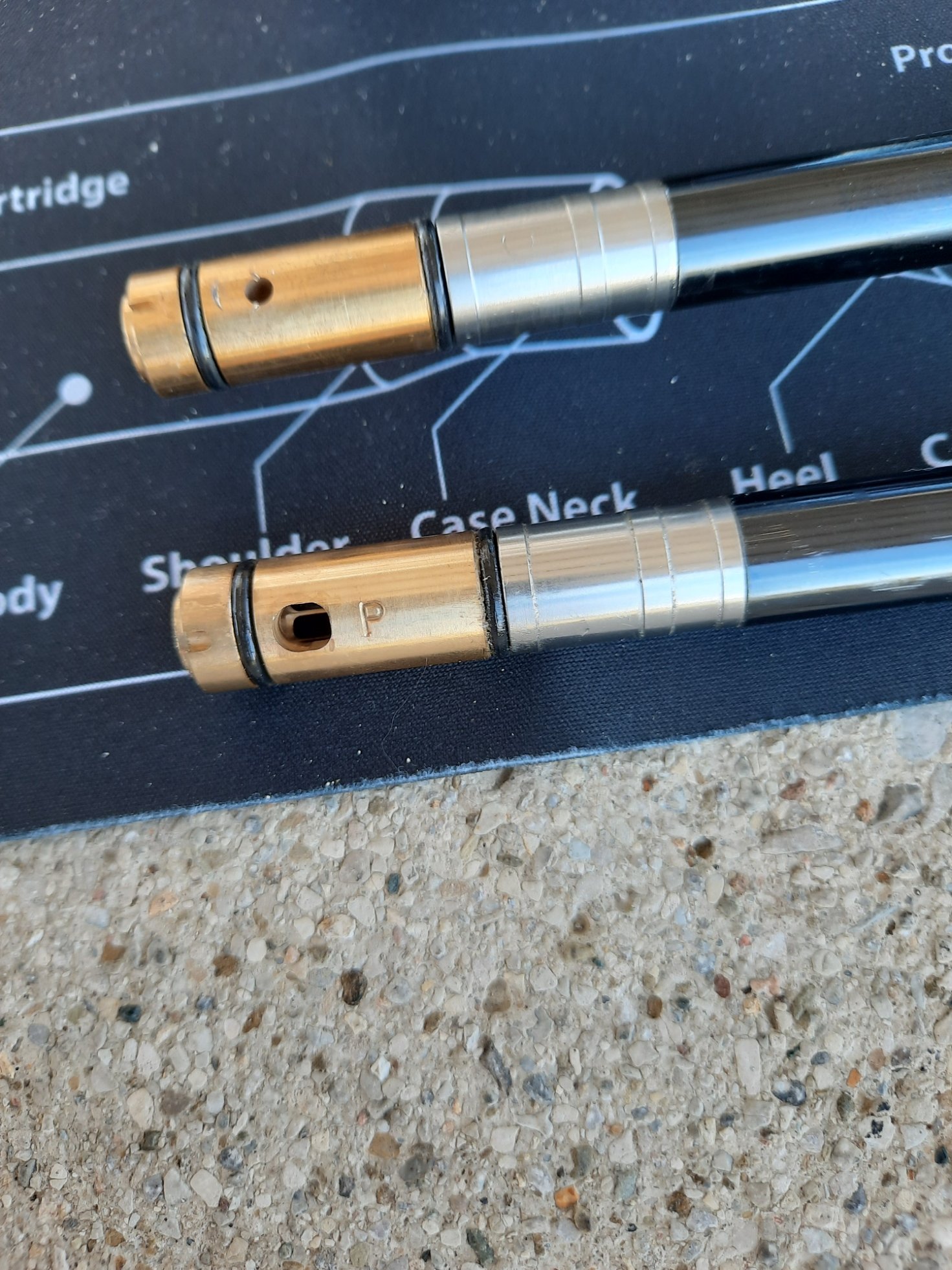

Dried loctite that came out with the set screw. If the stuff is brittle, and not brass or whatever metal the set screw thread into then its just dried loctite. Need to switch this transfer port out. See the photos, top port is my original and bottom is the newer port with the newer slug designed to keep pellets or slugs from falling down into it. In the future when you get something like this stuck remove barrel to get out stuck pellet/ slug, don't try to force it- you might screw up the entire barrel.
