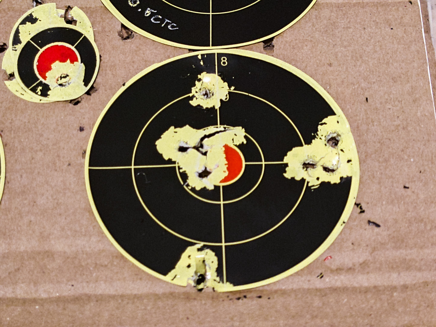

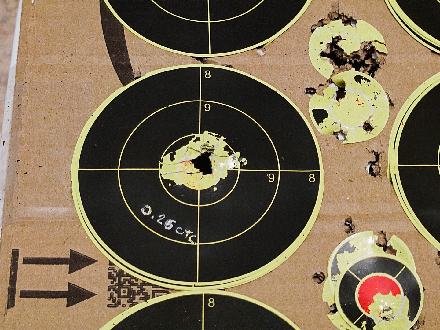

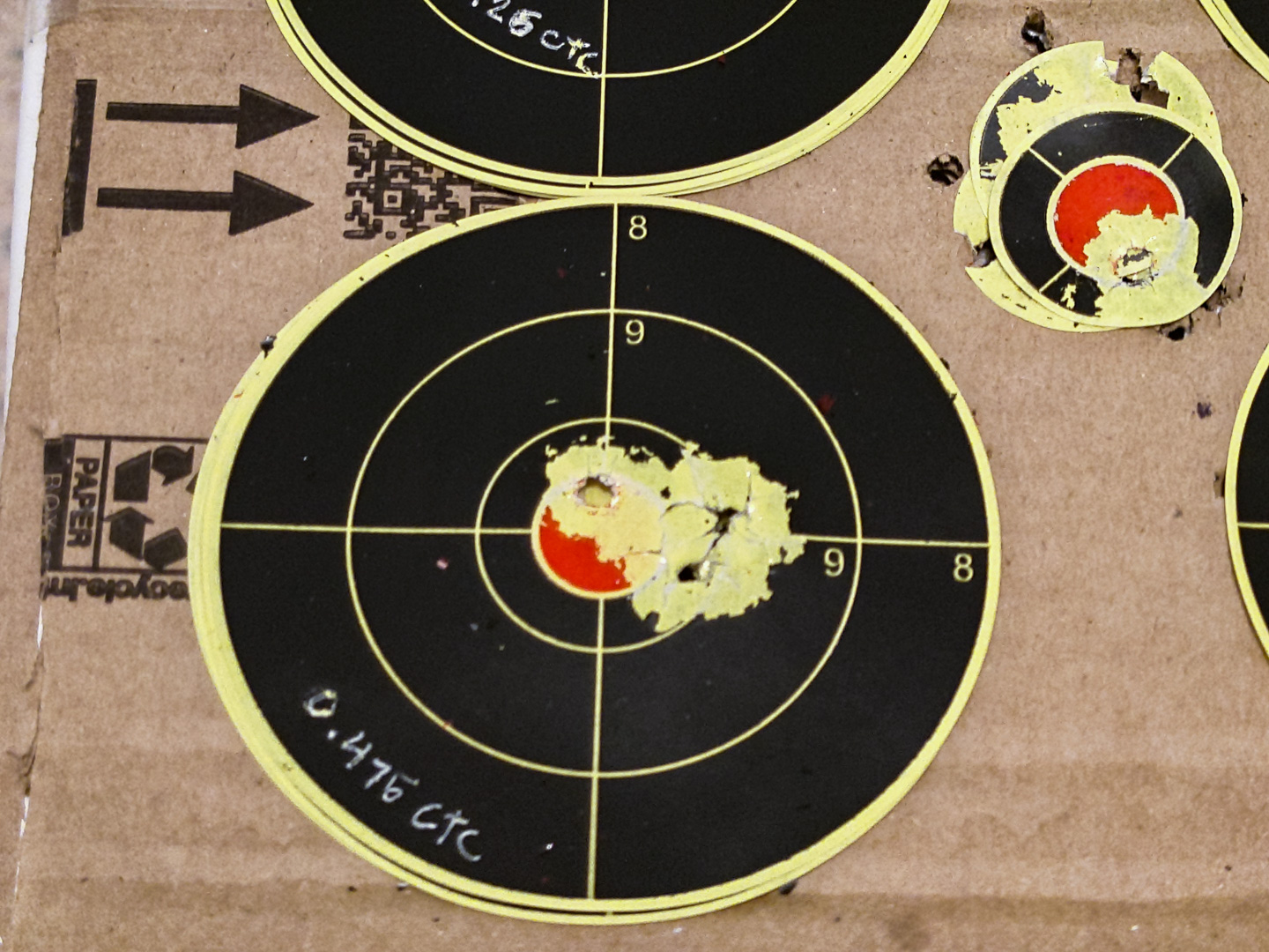

I did some shooting tonight with the Taipan Veteran Short .25 at 33 meters. The tune at 95 bars reg pressure is definitely much better than before. JSB King 25.39gr. and breezy 8 mph wind. Please don't crucify me... I know these are not the best groups that you have ever seen but I couldn't even get any where close to these with the reg at the 65 bars tune.
5 shot group 0.475" CTC. 4 in 0.375" CTC. ▼
5 shots 0.5" CTC ▼
This was my best group tonight. 5 shots 0.25 CTC. ▼
Experimenting with different holds trying to shoot the center and the intersecting lines. ▼

I think you would do far better if you try and increase the velocity to around the 8-900fps mark with that weight of projectile, so unfortunately this will take the reg set at higher pressure wind also becomes a bit less of an influence at higher velocities, there is no real compromise to less air use at higher projectile weights/velocities, you can save air by making the shot cycle more efficient by stopping things like hammer/valve bounce.
