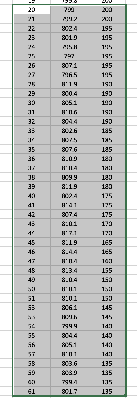

Kral Arms Tuning Unregulated PCP - Running out of Hammer Spring Adjustment
Here is the chart of sweet spot I assume..
Also for reminder JSB King Exact 25.5 Grain.
Also for reminder JSB King Exact 25.5 Grain.View attachment 489253
Mike
Dang Mike, I think I could live with that. Might be time for some accuracy testing. I would shoot a couple groups at the beginning of the sweet spot and a couple towards the end of it and compare them.

That tune with that weight pellet is about ideal ... IMO
If wanting / wishing for greater speed you will need to find a lighter pellet.
* I would HIGHLY recommend trying the JTS 21.6 grain semi-dome. With a tad less weight it will be faster and perhaps make equal or greater FPE numbers ? ( They are in my testing more accurate than JSB 25.4's :eek: )

Seemed pretty accurate. It likes these pellets. So I guess I should leave as is. 800 was kinda the goal.

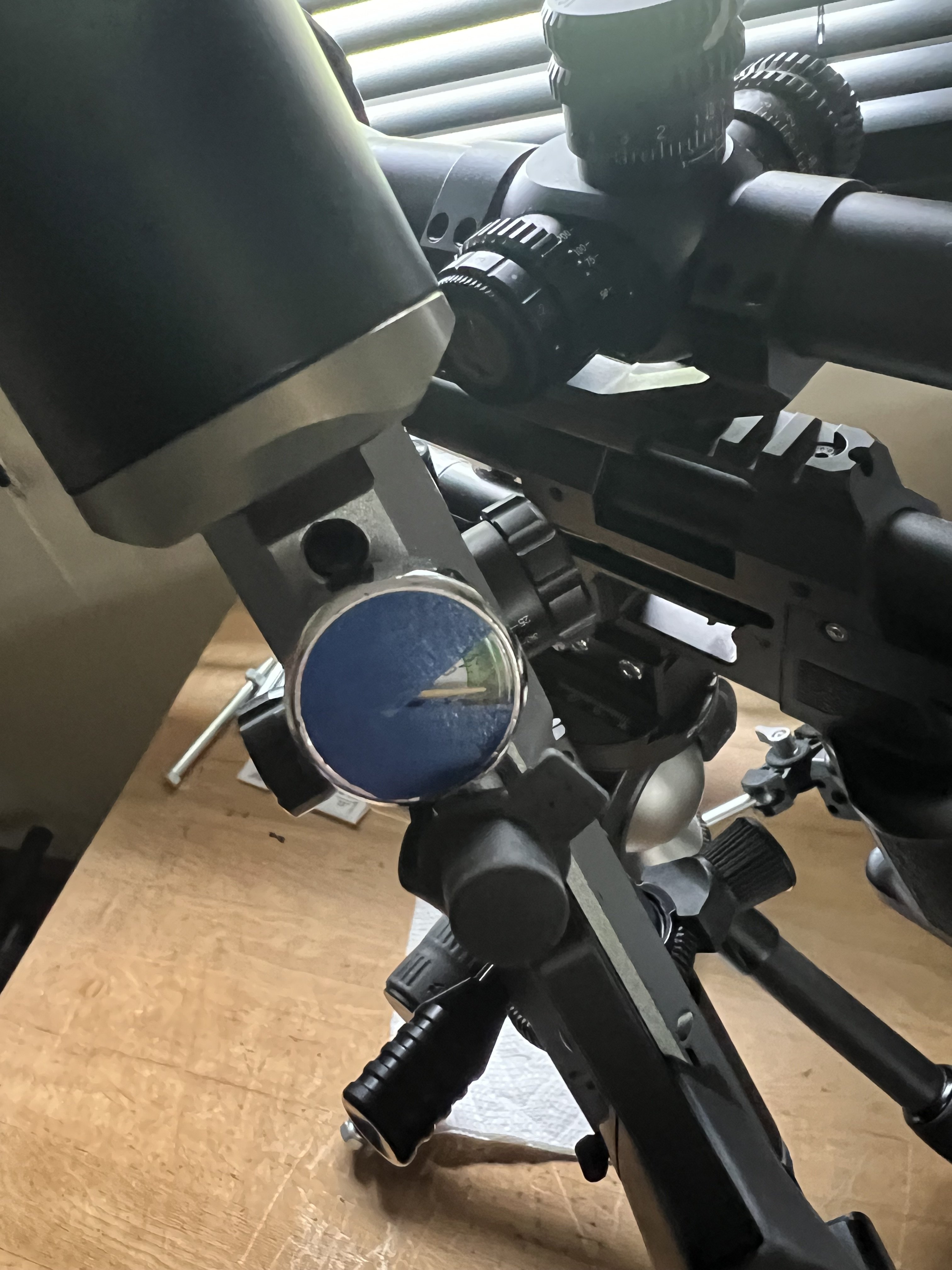

Heres another thing I do with my unregulated guns. Mainly because they don’t get shot often. Not because they are inferior, it’s because they are superior to a regulated gun. They can sit in my garage or down at the shop for months. When someone grabs the gun, it will be spot on with the first shot. But the problem is I forget my fill and refill numbers. So I do this.
That’s a great idea marking the gauge.
I reset my compressor to 220PSI fill for now. May drop to 210 on next fill.

Keep the chart you posted in post #21. You’ll need that if you ever decide to put a reg in the gun. It tells us some things about where the gun is and wants currently without any modifications. But let’s not go there right now. You might have a gun that’s going to suit your needs without going down a reinventing the gun path.
Thanks. I think I’ll forgo the regulator. But if I understand correctly. Asked on chart I would set regulator to about 140/150?

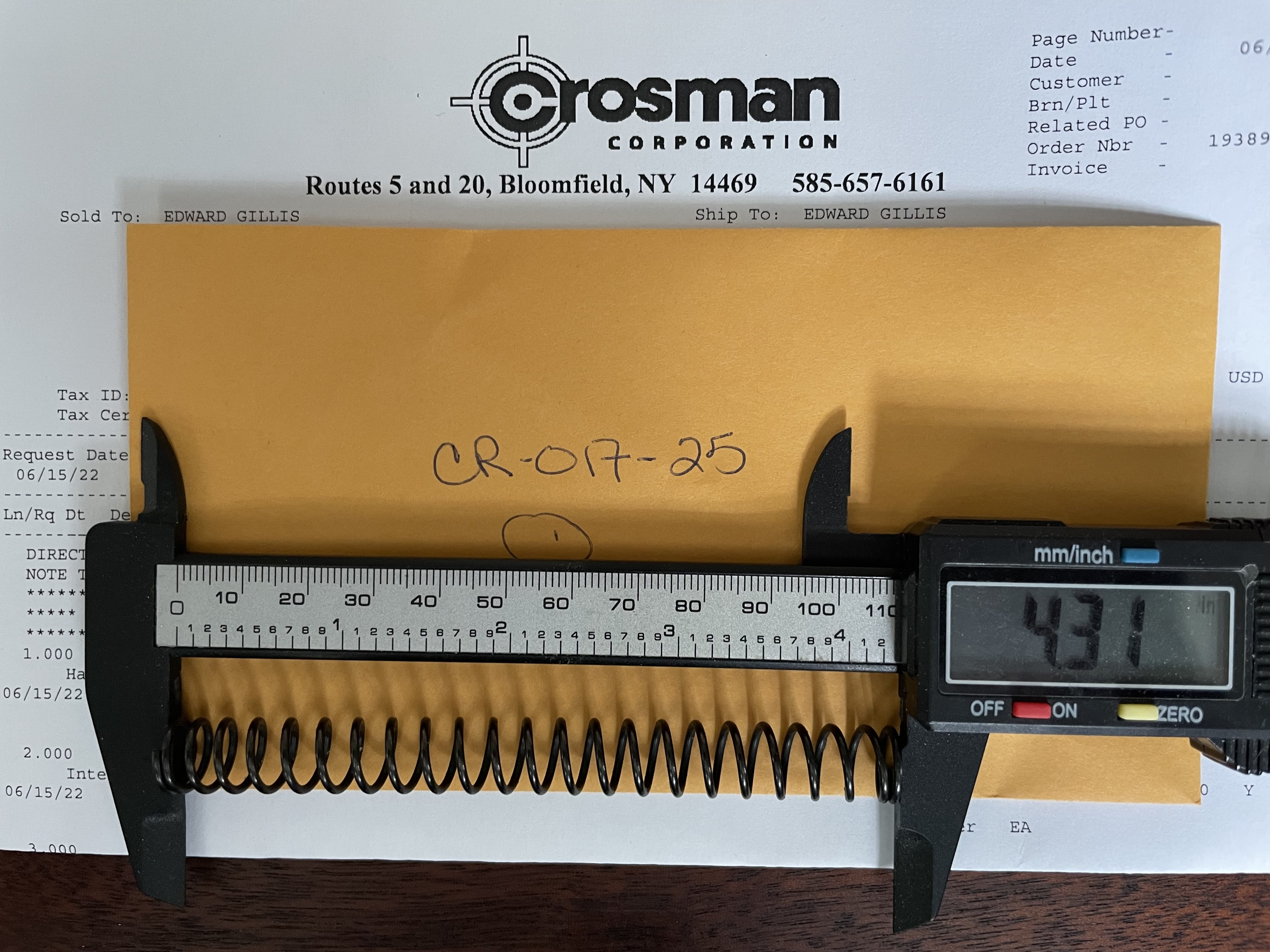

I found teh dimensions of the stock spring..Pretty long..
Replacement hammer spring for the Reximex Daystar & Pretensis air rifle.
11.35mm diameter, 95mm length.
I’ll fix this quickly for ya…
Benjamin Cayden and Reximex Daystar are the same action - use the same hammer spring.
Crosman uses a 4.25” spring in the .25 Cayden. Your spring is only 3.75.
Get the Crosman spring for $3.50 and try it - before you do anything else. You can always trim it to 4 inches or less if its too strong at 4.25 inches.
Edit: call Crosman service - which is Velocity Outdoors. The picture shows the part# and actually length of .25 caliber spring.
-Ed
-Ed
