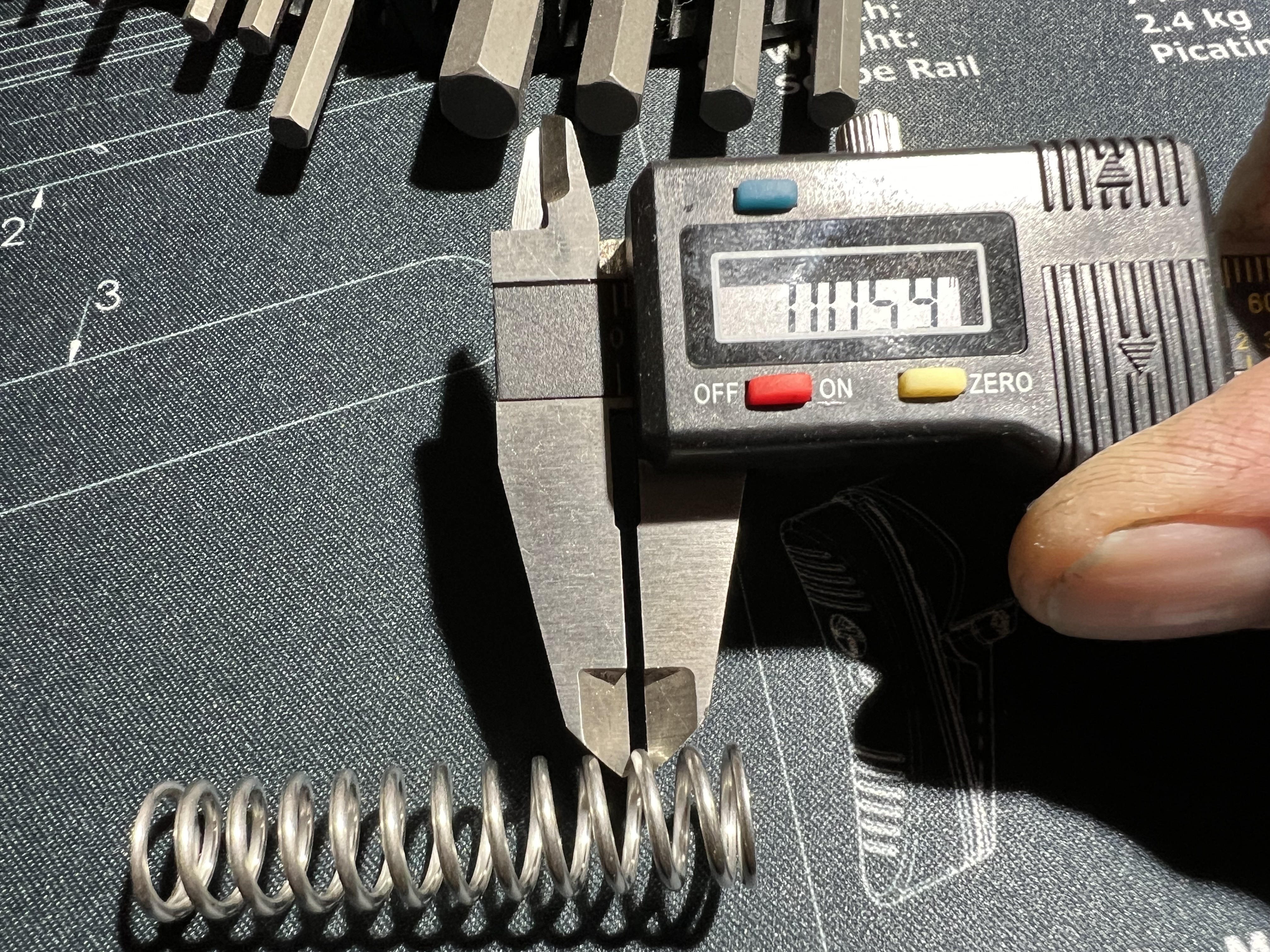

I think I figured out my issue.. Just took the existing Hammer Spring out to take a look and mine is only 70mm, while it should be longer.. This explains why I ran out of Hammer adjustment.
From what I gathered the Spring should be 95mm...
I probably got the low power spring installed in the rifle.
Reximex Daystar & Pretensis Hammerspring​
Replacement hammer spring for the Reximex Daystar & Pretensis air rifle.
11.35mm diameter, 95mm length.
Reactions: Stubbers
It may not be an issue. You may have a better spring. It’s not about the spring length, it’s about wire thickness. If a gun comes with a 95mm spring, the first thing a guy who knows how to tune a gun will do is go with a shorter heavier spring. Hammer bounce in any gun, regulated or not is your worst enemy. If you manage to get a longer spring for your gun, measure the wire thickness compared to yours. If it’s less, toss it. If it’s the same, pay attention to how your gun sounds as get get down to 150b and less. Go with the spring that your gun sounds the cleanest with. Regardless of a couple of FPS. After all, you should be after accuracy first.

What is the wire thickness on all the springs?

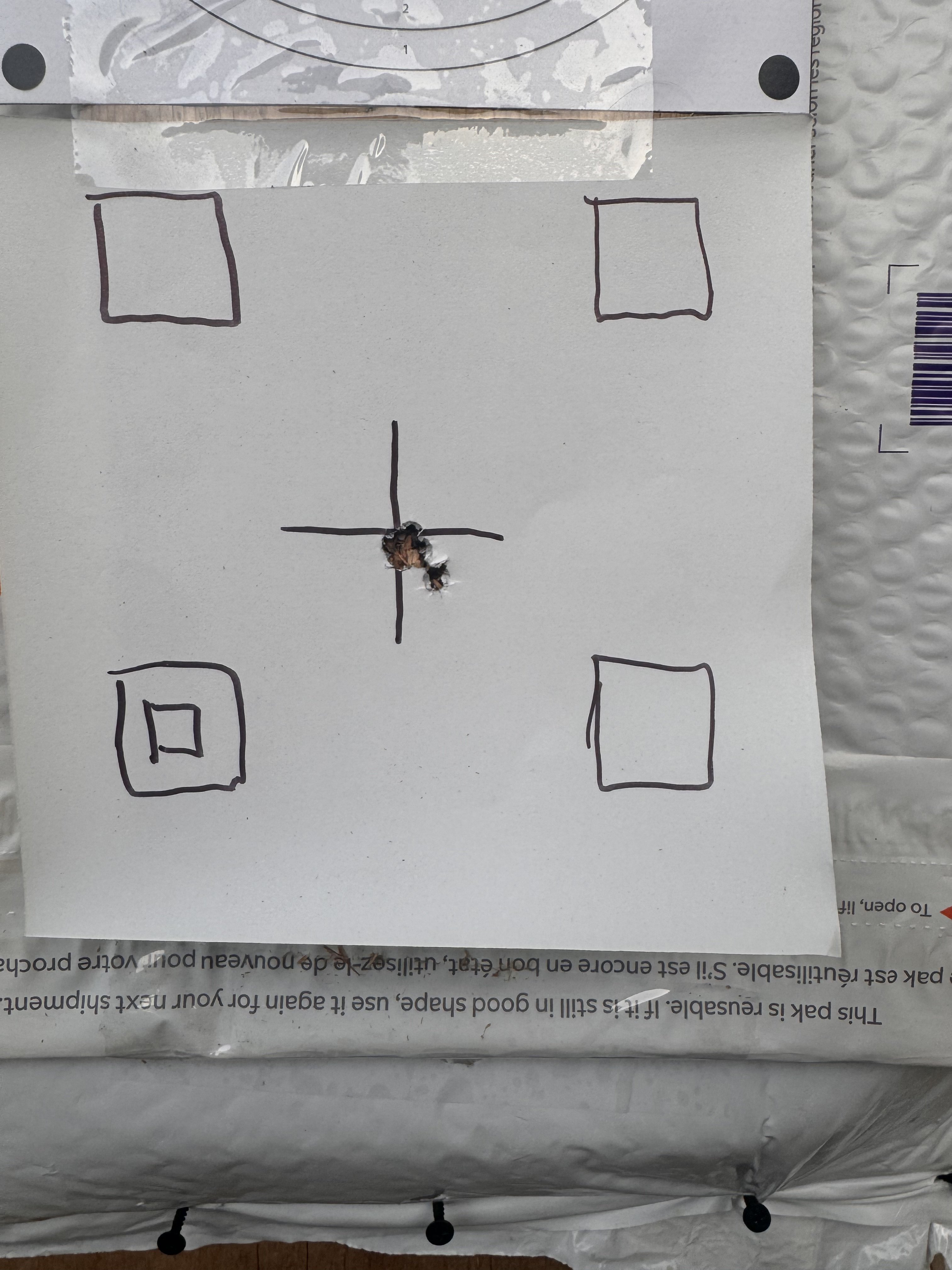

Going to get so,e accuracy data shortly at 30yards.. Should be able to get 50yards during the week and maybe I can fiddle with the new springs I ordered but pretty happy with the spacer / added weight hammer idea.

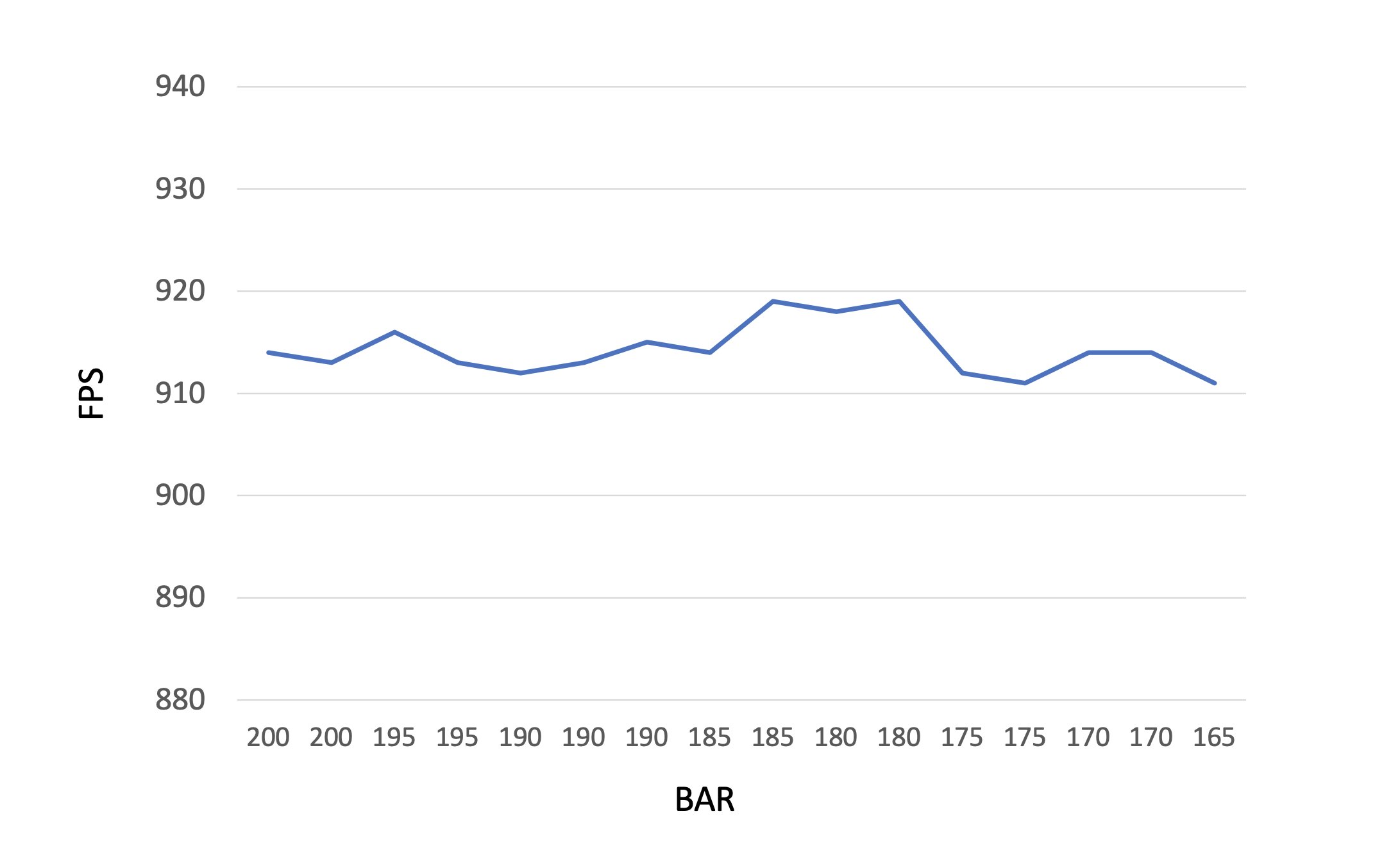

Quick update. Did some tuning with the help of a friend across the pond and opened up the ports and upgraded the hammer spring to an impact hammer spring.
Moved up to the JTS 29.6 grain pellets.
If you take the zone from 165 - 200 BAR I’m getting 20 shots with an ES of 8
That’s pretty good for an unregulated gun:) almost Panthera like ES.
230BAR - 875 FPS
220 - 885
210 - 890
205 - 903
200 - 913
197.5 - 916
195 - 913
190 - 910
190 - 913
190 - 915
185 - 914
185 - 919
180 - 919
175 - 912
175 - 911
170 - 914
170 - 914
165 - 911
160 - 905
155 - 895
150 - 900
150 - 893
145 - 892
140 - 885
