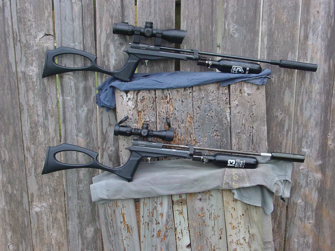

Top gun my bandit and bottom is my chaser. Going to do a shot count on it soon. I expect it to do 500+ crosman 7.9 HP.
