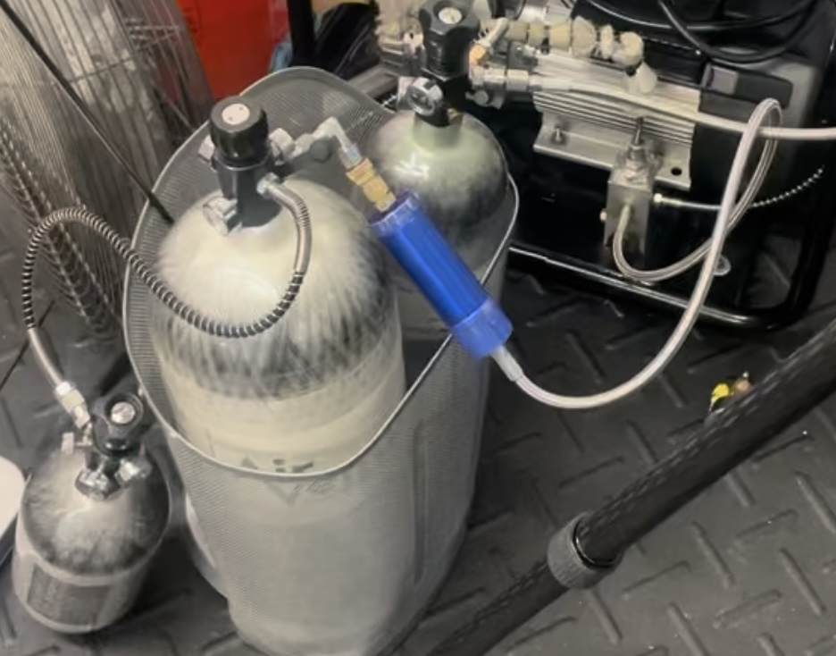

Well got my first air tank- got the Tuxing 4500 Psi - 4.7L , really nice tank- finished a little while ago filling it- used my GX CS4 compressor- took 2 hours and 24 minutes to fill from completely empty to 4500 psi, thinking I will really enjoy the tank- makes for a quick fill on my Gauntlet.

I have the Gx cs4i . It took 5 hours 10 minutes straight to fill the new 9 from empty, no problem. Love that speed of a tank vs putting gun on compressor each fill. You do it when new to pcp like I did but not for long
