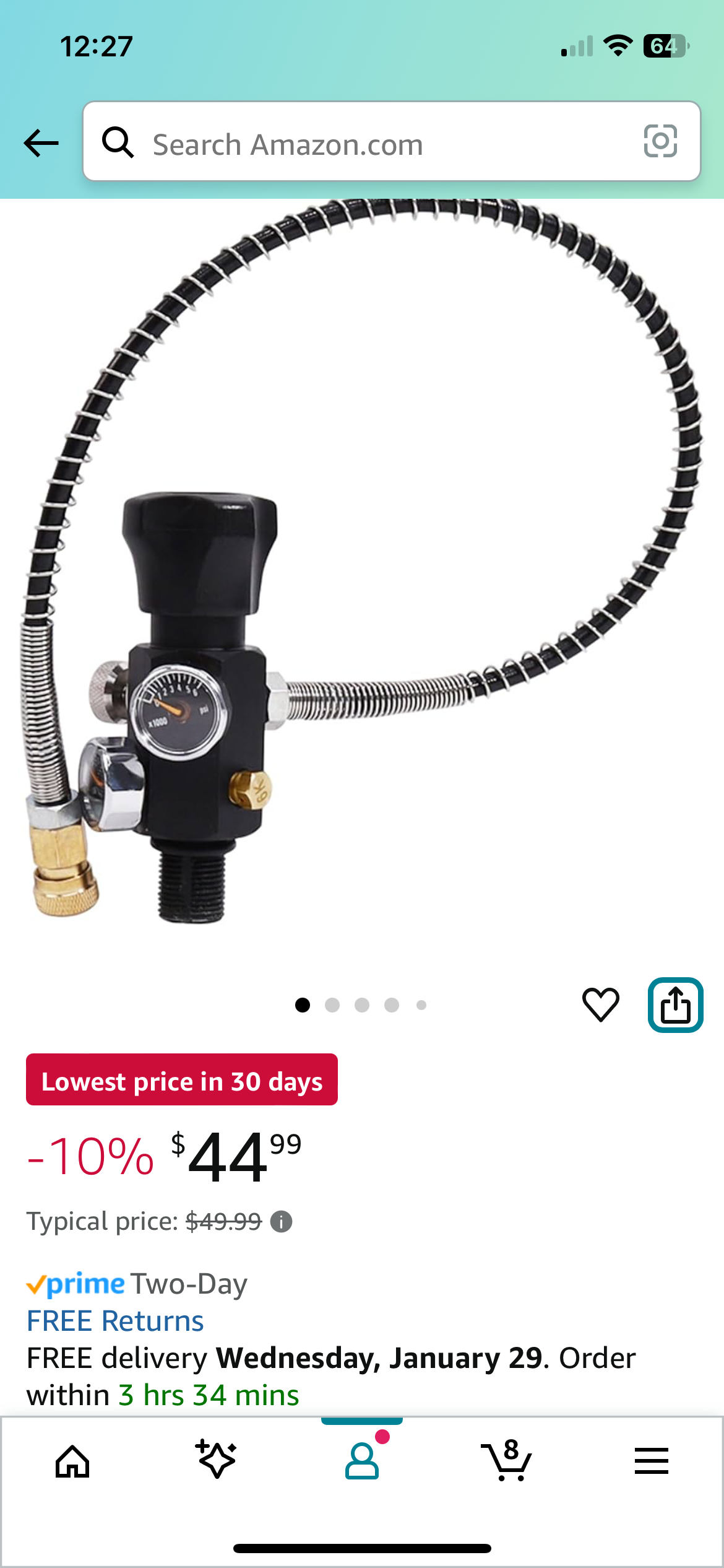

IORMAN 300bar / 4500psi High... https://www.amazon.com/dp/B0798LSYFR?ref=ppx_pop_mob_ap_share That’s the one I purchased. Shows currently unavailable. And yes you can open it to the pressure you want.
I purchased mine on Amazon for 79. I think it’s great.
Thanks, I like the preset adjustable. The ones I've been using don't drift so once they are set then everything is good to go.

Those type are knob adjustable, each time you open the valve you have to set the limit.
Mine are set before installation on tank. Just like adjustable regulators on the guns.
Open the valve it goes only as high as setting.
No chance to over fill unless regulator breaks.
Which is why I prefer them for tethering.

Hi- do you have to empty the tank to zero make reg adjustents ? - thankS
To come down, I would recommend it. Or at least get the tank below the value you are looking to set.
Going up, no. The adjustment is an external 4mm hex.
I haven't seen anywhere that says you can't adjust down. You would need to a quick bleed of air after each adjustment to see the new setting.
-- Matt

Seems like a good option to have. I did ask because somewhere I had read about a rifle that needed the air to be removed to go one way or the other on the reg pressure... Can not remember though. Thanks
A lot gun regs have to degas just to access the adjustment screw.
Some regs like the Huben Power Dream regs they specifically state you can damage the reg by going down.
I'm not an expert by any stretch so I tend to err on the Huben Power side. But I have quite a few of their regs.
