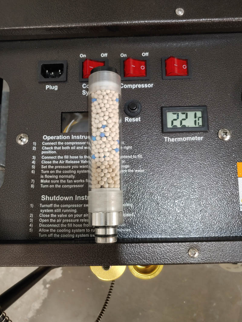

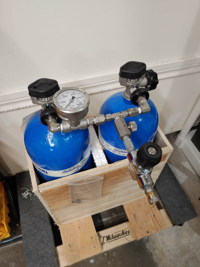

iflysky: They are 304 stainless Tee and a close nipple I plugged the original gauge opening with a stainless plug, they are 1/8 inch threading. (see image) Each of the ports have a delrin seal disk but I also wrap the threads a couple times with Oatey fast tape thread sealer. I purchased my stainless fittings locally at a supply house here, just call around in your area some one will probly have them just make sure they are stainless steel to be able to handle the high pressure. I removed the silica from the original plexi tube that come with the compressor and placed one filter disk in the bottom of tube and one on top with the 13x molecular sieve in between. (there is no need to replace the exisiting internal tube). I purchased the sieve from www.shopbvv.com
For Oil I use Royal Purple synt 100 I have not used Coltri or Bauer oil so I cant give any info on those, but the Royal purple works very well in this compressor. You can fill your air guns directly and yes you just open the air drain after shutoff to release line pressure. For my air tanks I bought new it was worth the money and I know I have 15 years on them atleast and a hydro renew each 5 years is only about 40 bucks so I think a new tank is worth the money, I have not heard anything bad from the refirbished tank so it would be a personel preference on your end to make this consideration. I have 74Cuft and 2 100 Cuft either is a good setup I use my 74 in the field and the 100s in the shop.
Looking at this thread where you plugged the original gauge port with 1/8" x close nipple. I thought all of the fittings were M10x1.0. The 1/8" would close it I assume but would probably corrupt the M10 threads. Your thoughts? I have one of these on the way and want to make sure I do everything properly.

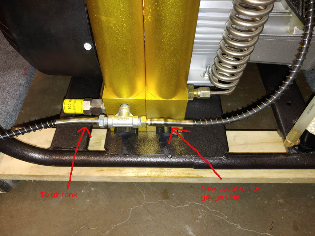

TIme for an update: After running for a couple weeks I noticed on the longer run times the compressor would shut off and the tanks would be about 200 pounds liter on air than the compressor gauge. I also noticed that they had installed the airline for the compressor gauge at the bottom of the water trap by the water drain ( see first image). This allows water to be pushed into gauge line affecting reading IMHO and possible future issues. I decided to make a change and removed the line from original position and plugged then installed a SS tee into the outlet pressure line, and installed the pressure gauge line there (see second image). Now the compressor gauge and tank match no matter the run time. This will also stop any future issues of water possibly damaging the compressor gauge. I also changed out there 3 part internal silca and charcoal for 13x Molecular Sieve beads (see image 3).The compressor continues to run very good I use it to top off my two 100Cuft drager tanks I use in the shop. From 3000psi to 4500psi it does its work in 11 minutes. I will post shortly filling a 74 Cu ft tank from empty to give a update on times and temps for a bottle from scratch. So far very pleased with operation.
View attachment 116257View attachment 116270View attachment 116284View attachment 116294
@bthurman My TXEDT033 will be delivered today. I began accumulating parts for the "T" fitting mod you suggested. I just realized my 033 has ato purge and the 032 does not. I think the auto purge may solve the problem you had without the "T" fitting. Your thoughts? I'll keep you posted!
