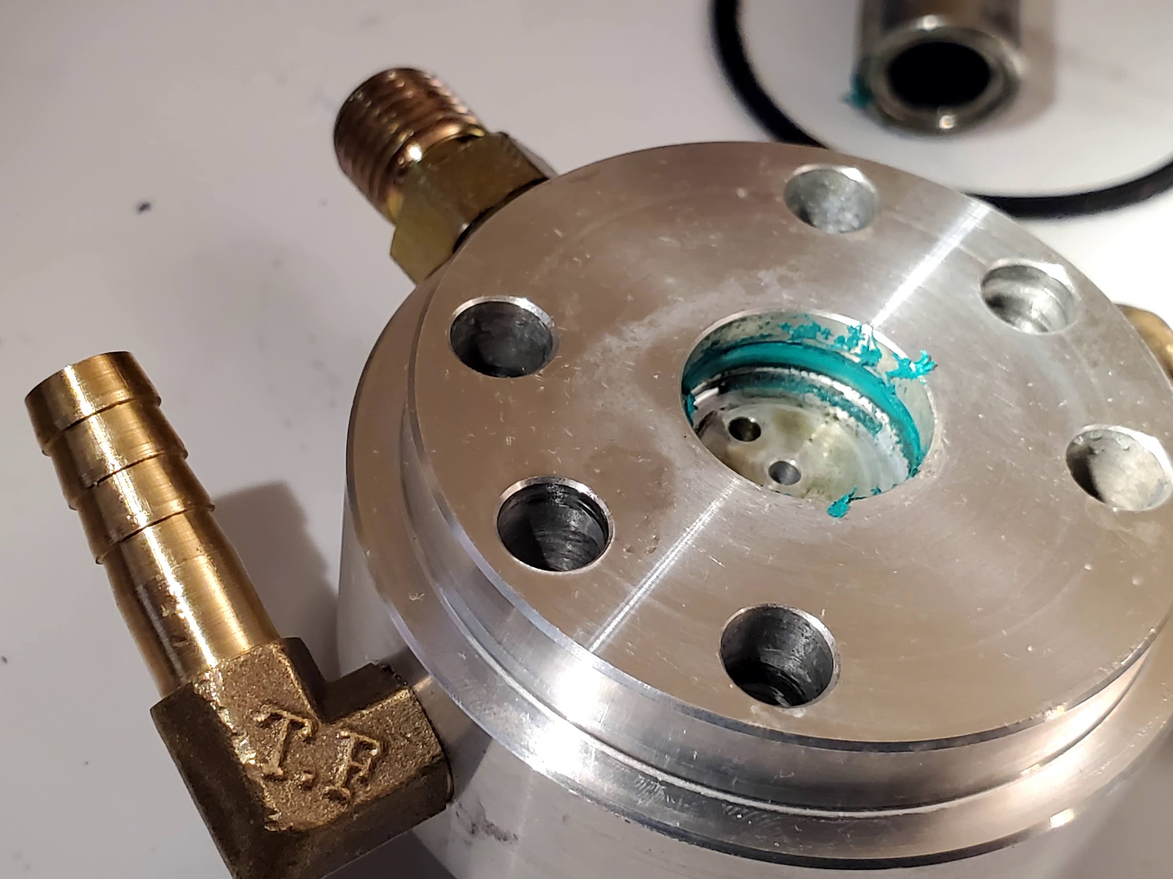

Hey gang. My 032 with only 4 hours of runtime has started blowing air into the coolant line from the high pressure cylinder. Any pointers on how to fix, what parts to get, etc.?
In all likelihood the gasket under HP head torn and now leaking into water jacket. You need to disassemble and inspect anything else is a guess.
Well yes. Tore it apart and found that the green o-ring that seals the top of the HP cylinder is not in great shape at all. Pieces of it came out when I pulled out the cylinder. Does anyone have specs for this o-ring, perhaps suggestions for something more durable?

Measure the replacement that came in the replacement parts kit. Find a matching one at an auto parts store (Nitrile or Buna 90), lubricate it with silicone grease, and reassemble it. They likely didn't lubricate it on installation, may have cut during installation, and dry installation may have caused abrasion from vibration.

Yes looks like this is what happened. I would imagine that it needs higher temperature resistance than Nitrile / Buna though?
Now that I think about it, what's the right material for these o-rings anyway? It would need to combine resistance to high temperatures, oil, water, and ideally antifreeze. It seems that when it comes to o-rings, such material does not exist.
Nitrile? Does not like high temperatures. EPDM? Not oil resistant. FKM? Not for hot water and coolant. Silicone? Probably not going to work at these pressures anyway. Where do you compromise?
Nitrile/buena temperature resistance is sufficient.
Well I don't know. It's only rated to 225F, lower than the others, and this o-ring is sealing the high pressure cylinder where temperatures may rise high enough for oil to diesel... Has anyone actually used it for this application successfully?
Viton is not recommended for antifreeze, so I'd be limited to running straight water...
Anyway my interest is purely theoretical at this point: I found the parts kit that came with the compressor, it had 2 spare green o-rings, so I used those and carefully put everything back together, making sure to properly lube with silicone grease. Let's see if they last now.

Well if that helps anyone, 114 size o-ring seems to be a good fit there. #114, 5/8" ID, 13/16" OD, 3/32" width. This is not an exact match, original o-rings are metric but this size fits well and seems to seal tighter than the original. The original o-rings are something like 22mm OD, 18mm ID, 2mm width. As for the material, your guess is as good as mine.

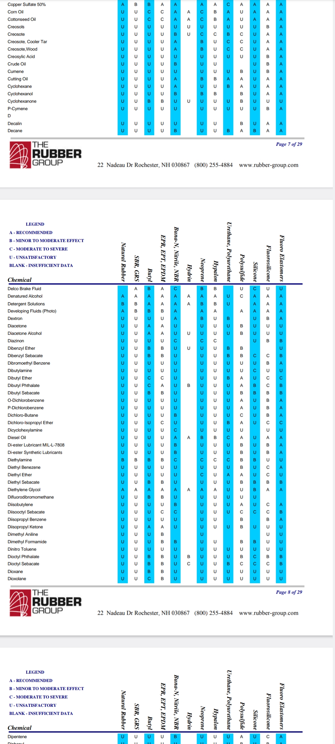

And also no resistance to petroleum base oils and most synthetics, including diester oils such as SECO 500.
Here's a nice chemical compatibility chart:
https://utexind.com/materials-resources/chemical-compatibility/
Also, I noticed that after replacing the o-rings the compressor started running noticeably cooler: temperature readings at the cylinder head are like 20F lower than ever under the same conditions. Looks like there had been a small leak there from factory which I never noticed, and the air bubbles around the HP cylinder affected cooling. Eventually the leak got so bad that the high pressure air shredded the o-ring and that's when I noticed the problem.
Moral of the story: pay attention to your coolant lines.
