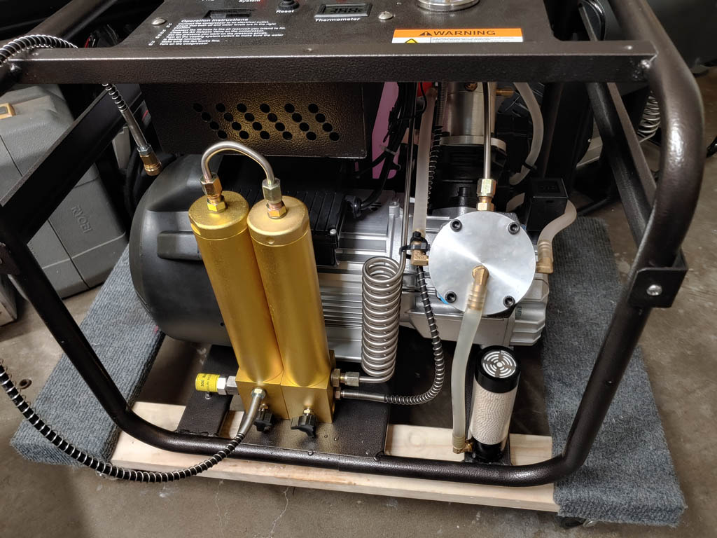

I am going to do 2 part review. this first is on inital unpacking and break in with a tank top off: The second will be on filtration after a full fill.

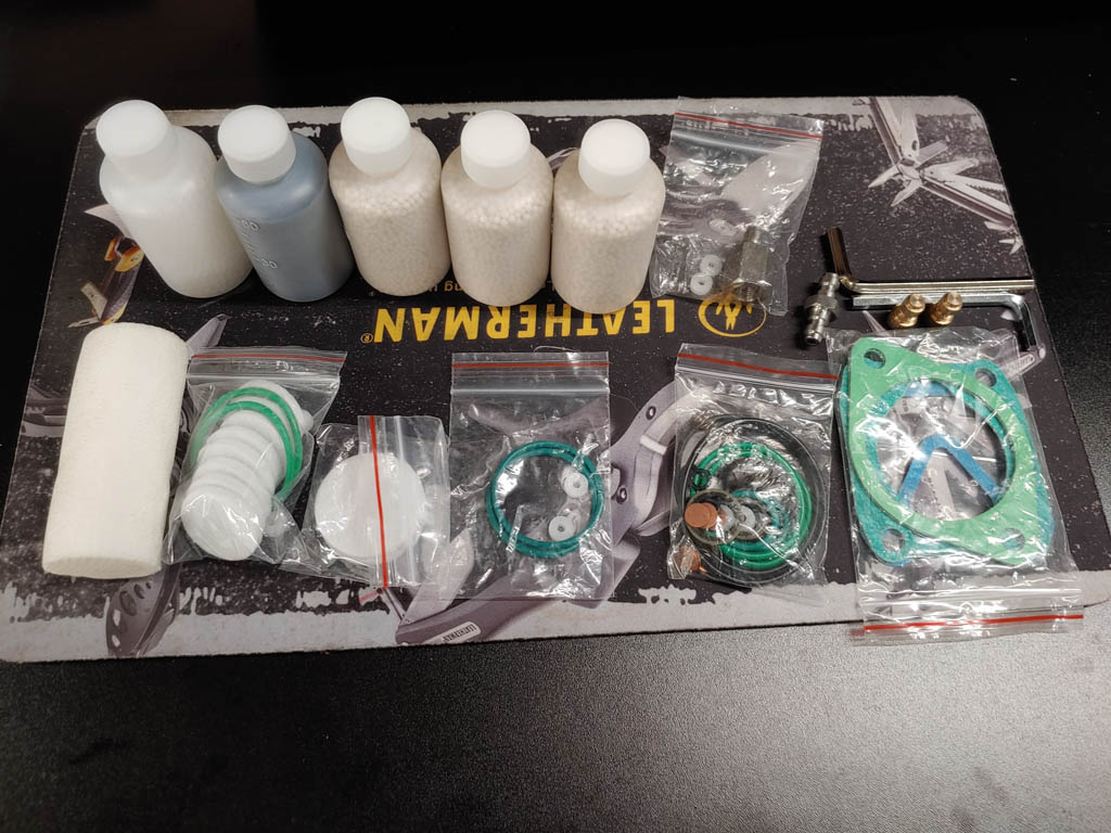

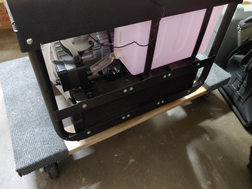

Unit arrived in good condition no damage to box or unit. I was very suprised that they had foam inserts packed around all components very pleased. The unit is a little bigger and heavier than AV 4500 but this is due to the dual filter system and the larger air cooling system. Setup is very easy I used Purple syn lube 100 for the crank case. It comes with a air intake dryer setup as well as a twin water filter seperator for the output. The second stage piston is bigger than the AV and quite frankly I have to say it is much stouter than the AV. THe cooling system is routed very well and there is excellent water circulation thru out the entire system. The pump is on the outside of the tank which is a bonus in my book, the radiator is the full length of the compressor frame with 3 large cooling fans to circulate air flow. System holds 5L of water including the plumbing and radiator. This model runs on 120volts. I was suprised by the accessories and spares provided, all cylinder gaskets filter replacement media several burst disks and multible fittings to connect to tanks. Hose whips are sturdy and very well made.
After a 10 minute breakin period which had no issues I decided to top off my 74cf tank. Started at 3000psi and topped to 4500psi the process took less than 11 minutes, the air gauge is very accurate and shutoff was dead on at 4500psi. There are 2 air bleeds one for the water trap and the other for the filter seperator. I did find that during operation openeing the water trap worked very well I live in a high humidty region, I checked the second drain and found NO water present so the first trap is definantly doing its job. Noise and vibration are less than my AV I actually had a normal conversation while it was running - and it topped off the tank 9 minutes faster than the AV. The only draw back I see so far is the inlet dryer, the vibration does cause the beads to move around at the top of the canister which could cause some dusting issues there is a flat filter on the bottom of the can to help prevent this from getting in compressor I did not notice any dust after initial running. The temperature did very well, the secondary cylinder were temp probe is located never exceeded 60 Celcius and after shutdown the cooling system rapidly brought the temp down a very good cooling system in MHO. I used a laser thermometer and along with a second surface temp gauge, the upper secondary cylinder cooling head ran at 90 degrees the primary cylinder cooling head at 107 degrees, much lower than my AV.
Overall intially I am impressed I have to say. I will be using this exstenivley over the next couple weeks and will update this post to let you know how it holds up, but so far I would have to say this is a well built unit and worth the price.
