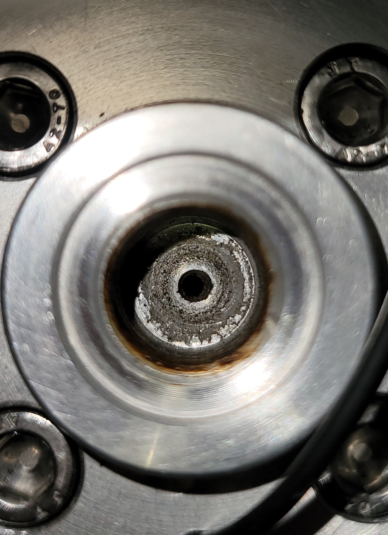

I ran into this a few days ago. 10 months old, I probably topped up 2 9L tanks worth per week.
High pressure outlet check valve is pitted to death. Leaks into the crank case. Currently talking to someone at tuxing... tempted to call in that 4 year warranty and go buy an alkin... but that's a whole lotta cheddar.
I pulled it apart and replaced the seals. That didn't fix it so I looked at the check valve.
Switch to Seco 500 synthetic. Royal purple is not a good oil for that compressor. Your burning yours. RP is actually only good to about 2800.psi then break down rapidly. Still operate the compressor to this day in the review, has over 290 hrs.
Good to know. Maybe the oil was detonating around the check valve or something. I can't think of any other reason it would pit like that.

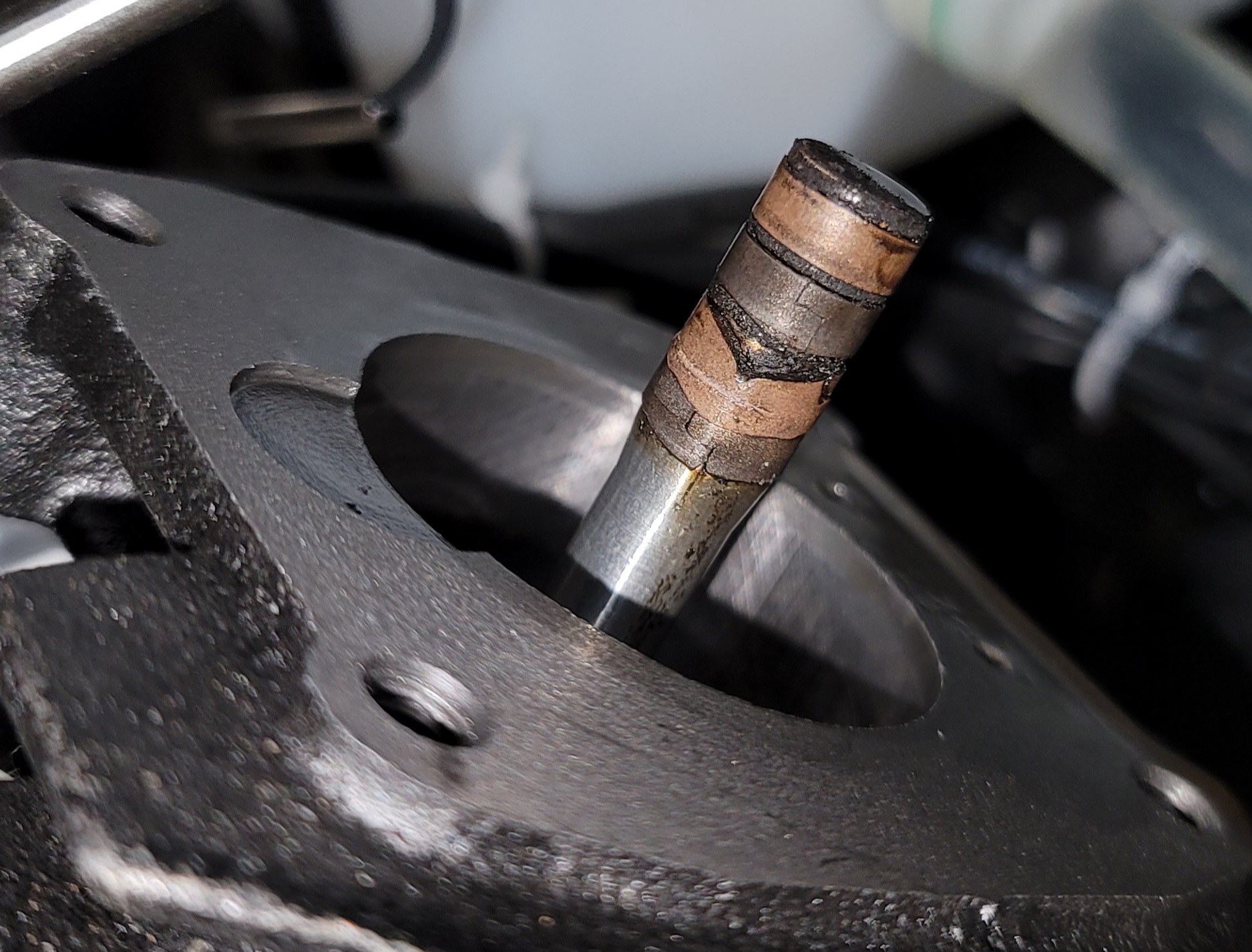

Those high pressure rings on the piston are toast. I use Mobile Rarus 427 compressor oil, and that has worked for me better than any other lubricants. After too much heat, compressor head warps, and new rings don’t help. I ran 2 thin layers of yellow teflon tape, and it’s kept hi pressure rings from slipping down piston sides like on your picture
it may be hard to believe, but you’d be surprised how well this works on a warped hi pressure head
