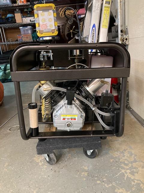

Ordered up this compressor on Christmas and said it would ship from the US. Well it didn't it shipped from China and it arrived today. The packaging was beat up, but the compressor look great! Set it up and ran it for 10 minutes on a "Break in" period then filled my 30 minute tank in about 3-5 minutes. Definitely need to put in the tee and plug like like others have said to get a true pressure reading. My tank says about 200 PSI below the gauge on the compressor. Tomorrow I will fill another bottle then change the oil.

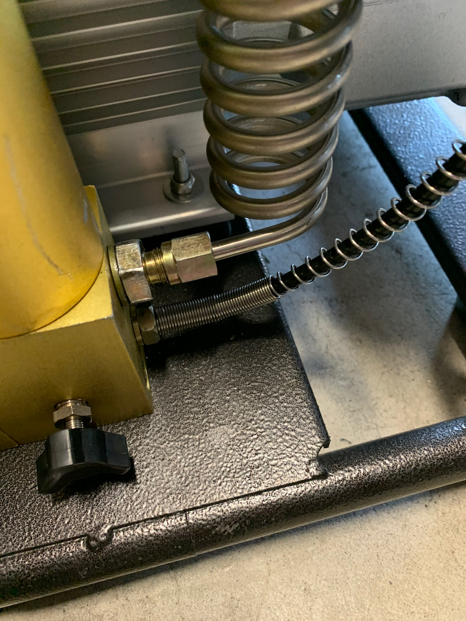

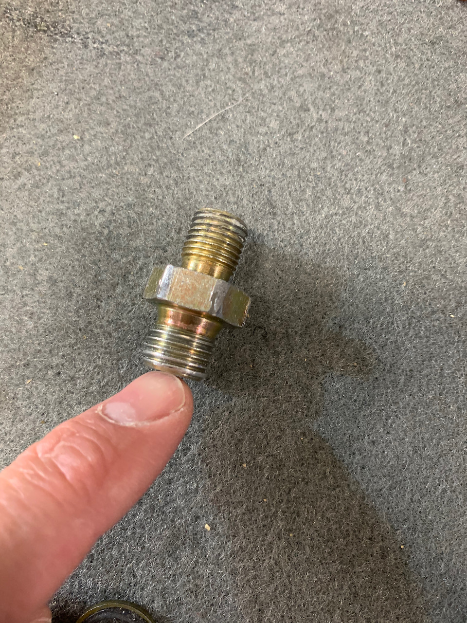

The issue started when I went to install the tee and plug. I couldn't figure out how to get the gauge line off the gauge and input to the first gold filter (yes I know now how easy it is please save you slings and arrows, I beat myself up enough). I just started pulling parts off with no coherent plan and ended up down a rabbit hole. I pulled the high pressure line off of the gold filter block, and when I went to put it back together I cross threaded the connection from the high pressure line to the filter block. Needless to say this was bad and killed the compressor. If only I had called Brian, this could have all been prevented.
Now the good news. I contacted Tuxing and they replied within minutes (time change considered). I told them what I had done and the parts needed to fix my mistake. They were very helpful! I had to replace the filter block on the right filter, the fitting to attach the high pressure line to the right filter block, and the gauge hose. They had the parts at my door in less than a week for $45. I thought that was very reasonable all things considered. The other plus to my mistake is having the knowledge that should I need parts or service in the future for maintenance or what have you, this bodes well.

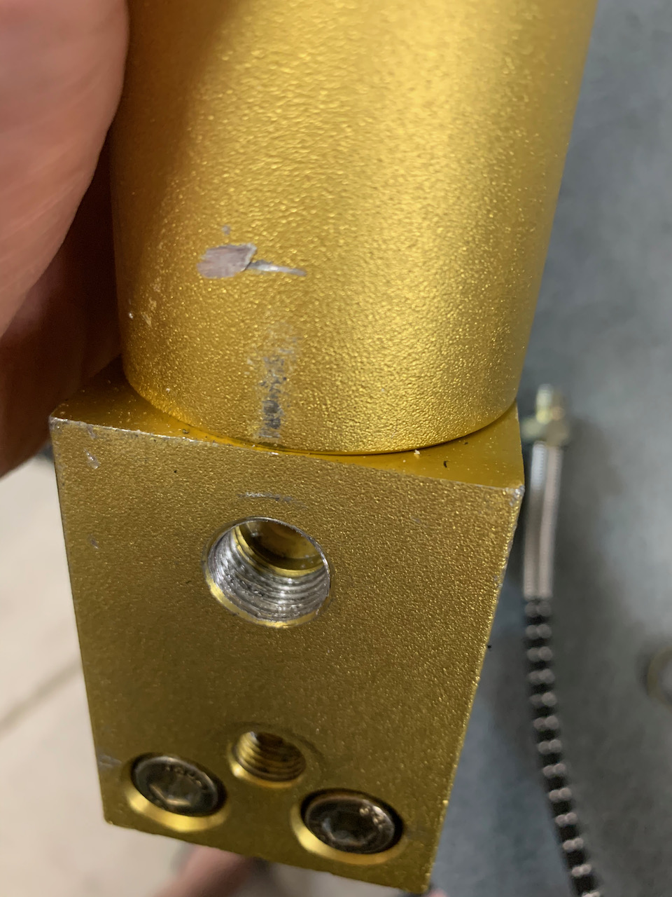

Did another test with the plug and discovered and that there was a leak at the point where the hose attached to the back of the gauge. I couldn't hear it, and it actually didn't even really bubble when misted with water. As soon as I touched though it hissed nice and loud. It was not a good seal and when the compressor vibrated it allowed air escape best I can tell.

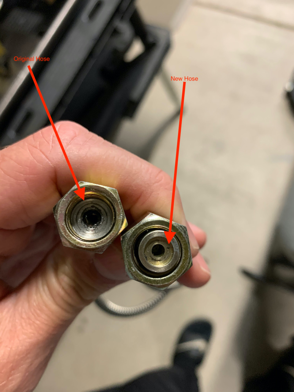

Now keep in mind this is the replacement hose Tuxing had sent me. I asked for a replacement hose as I feared I had kinked my original hose and possibly ruined it. I tried everything to get the slip nut on the replacement hose and gauge to seal, but it would not. At first I though I was missing an o ring, which it was. So I put an o ring in. Not sure it was right o ring, but I just picked one out of my replacements that came with the compressor. You see the hose that came on the compressor and the replacement were different. The original hose had a solid one piece nut, while the replacement hose had a slip style nut. You can see in the pic below that the new hose appears to be missing an o ring. Yup, tried that. Also included images of the back of the gauge for reference. Looks like it should work with the slip nut and o ring, right? Well no matter how tight I made it, it still leaked. I figured I'd try putting the original hose back on, and sure enough, sealed right up like a drum. Not sure if my gauge is different than the ones they use with the newer hose or what the deal is, but its sealed now so I'm sticking with it.

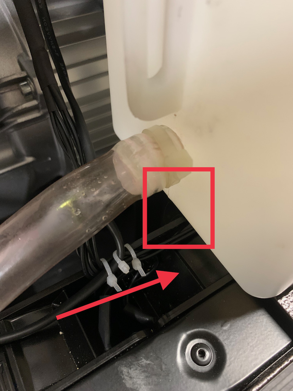

I also had an issue with the water tank leaking a little where the hose leaves the water tank to the pump. Contacted Tuxing again and again, responded right away. Their advice was to put some sealing tape around the stem coming off the water tank. I did that, and also put a zip tie on. But it was still dripping from where you see the red box. Contacted Tuxing again. Their advice was to apply more sealing tape. So I applied more sealing tape, some liquid silicone, and a zip tie. Finally got it to stop dripping. It's not pretty, but it works. I was worried about it dripping because it was dripping right onto the cooling fan connections and I was worried about the fans shorting out. Tuxing did finally admit that they were having some issue with the reservoir leaking on some units, but they weren't sure why. Guess I got one of the leaky ones.
Okay, now everything is good to go. I was able to top off my 6.8L bottle from about 200-300 bar in about 12 minutes, and I was able to fill up my Brocock Sniper XR (250BAR 480CC bottle) from empty in about 7 minutes. My temps were similar to Brain. Compressor displayed a temp of about 133 F max. I have noticed that even with the tee plumbed direct to the gauge, my compressor gauge and bottle gauge don't match. The compressor gauge is showing several hundred PSI low when the bottle is for sure filled. The compressor will actually overfill the tank. The tank is an Acecare 6.8L 300 Bar bottle. I set the auto shutoff on the compressor at 30MPA which should be 300 bar, or 4300+PSI. The compressor overfilled the bottle in an attempt to reach it's 30MPA cutoff. It actually blew the pressure disk in the relief valve on the tank (easy fix). I also noticed that the 300 BAR over pressure relief valve on the compressor (on the far side the second filter block) was hissing. So the compressor was fur sure at 300BAR, but gauge said it hadn't reached bar yet. Am I missing something, both the compressor relief valve and tank relief valve are telling me I'm at 300 bar even if the compressor gauge doesn't tell me that? I guess it's just gauge error? I guess it's not a big deal at the end of the day, just look at what the compressor gauge is at when the tank is full and make a note of that reading as 300BAR. Still learning and trying to figure all this out.

I finished the “T” mod yesterday and it is running great. The gauge was off by 300 from my tank gauge before the mod now it is off 100. I also had the leak on water tank (Same spot too) and a little silicone did the trick. I only have an hour on mine, but everything is working great. I love the auto shutoff!! Now I Need to get out and shoot more so I can use the compressor....

iflyskyhigh I feel what you went thru for sure. I got mine and had a few problems to get fixed. The first one was the pressure gauge was leaking at the hose connection and upon removal seen that the oring was cut in two pieces so ok easy fix replaced the oring fix that. Then the water leak started same area as yours but mine was on the seam around the mounting ear on the tank. Was finally able to find the exact spot and did some plastic welding and got that fixed had small pin hole at seam that had not got sealed. Then went to change the fliter siez out and they had the two switched around the left one had the tube and the other and roll filter in it so got them switched and all was good changed the oil out to the good high pressure compressor oil and put Redlne water wetter in the cooling system rerounted some of the hoses and installed a hour meter and now all is good. Got a Shoebox Freedon 8 with the speedup gear and belt that I had been using for 4 years. It has been good but wanted something that filled quicker. The shoebox took about 1.5 hours to go from 3500 psi to 4500psi on my Great white tanks and now it takes about 10-11 minutes to fill which I love. Got about 4 hours on it and all is good time will tell but I love it right now for sure. Also one last thing the pressure had needle bent to low and was not making good contact so had to drill small hole to bend the needle up a tad and that some to have fixed the auto cut offf now as it cuts off right on the correct pressure. I also did the gauge line move the Brian told me he did as well which did help the reading no doubt on mine.

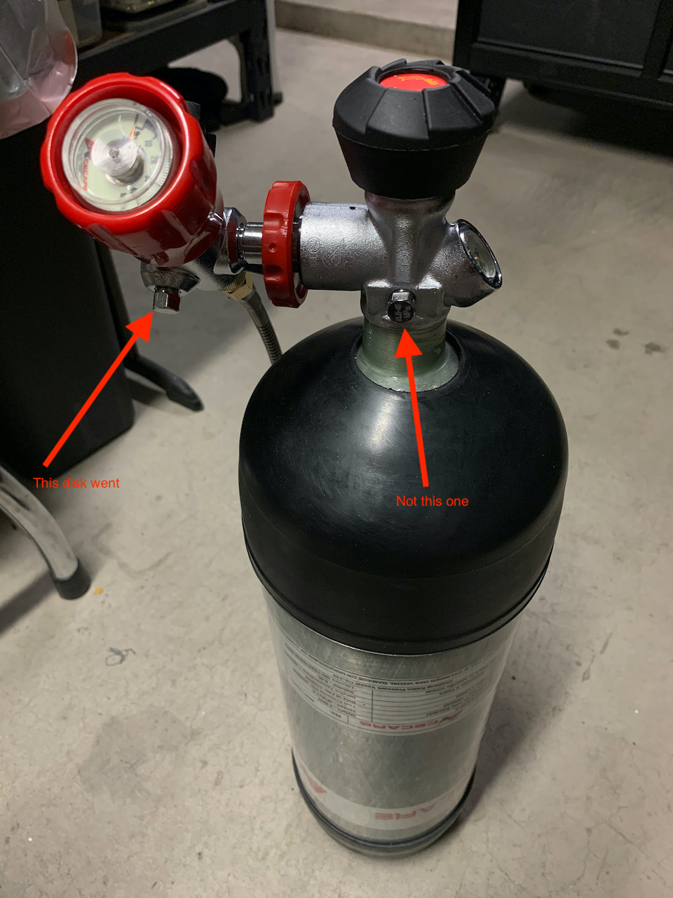

I need to verify how much mine is off. I'm not sure, but I know it's still off quite a bit, even with the Tee installed. Like I said, I'm inclined to believe the bottle vs the gauge on the compressor. Because the gauge on the bottle was reading 31+ MPa or 310+ Bar, which is 4500PSI+. And the blow out disk on the bottle did in fact go which makes sense since it's rated for 30MPa / 300 Bar. So a couple things learned, the compressor will in fact put out 4500+PSI, and the gauge is not very accurate. For some reason I thought these carbon fiber bottles were good to 4500PSI, but obviously they state right on the bottle that they are meant for 300BAR, which is not 4500PSI. There is a lot of different terminology thrown around when dealing with all this stuff. I understand some it gets lost in translation, and when dealing with different forms of measurement they aren't always equivalent. But do the American made bottles actually go to 4500PSI? Further more, looking at the gauge on the compressor I think the red part of the indications starts below 4500PSI, AND the safety relief valve on the other side of the gold filters gives way at 300BAR, so even though this compressor is rated to 4500PSI and can do it, it's not really meant too? Still all a little confusing. Sorry, I should clarify. The blow disk on the DIN filling station that attaches to the valve on the bottle went. There is also a blow out disk on the valve that keeps the air in the tank. It remained in tact.

I couldn't even get the gauge line to seal EVEN with a brand new o ring. I tried varying degrees of force on the nut, but not matter how loose or how tight it was it leaked.
I'm pretty sure my leak was at that same seem. I just couldn't pin point it. I'm guessing that was the tanks were manufactured there was a defect in the mold and the seems didn't get completely sealed. Still not sure exactly where the leak was, but the silicone I applied did fix it. Doesn't look pretty but it works. I'm a little miffed about the water leak. It appears they know there is an issue. They should have offered to send a replacement tank, but despite me hinting around about it and more less asking them to the didn't offer.
