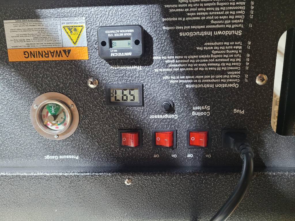

Update. I received my Air compressor yesterday. I paid total of $899.00/ no tax/no shipping. This thing works like a champ. This unit is a very quiet. It appears to well designed and and high quality. I used Mobil 827 Rarus oil and a 50/50 mixture of antifreeze and distilled water. I will keep you informed on the overall performance. One Question. There are three rocker switches on top of the unit. Two are marked for compressor and one for cooling. What's the third one?
I have the same compressor and if I had to guess I would say for the "auto purge" enable version. Just a guess. After fixing leaks and vibration, it now performs very well.
I fired up my compressor today. It filled my Great White CF tank from 2800 PSI to 4400 PSI in 22 minutes. My temperature stayed around 168 degrees F the last 5 minutes or so. The compressor performed very well and surprisingly quiet. I do not have the auto purge version. I thought I was ordering that version but turns out I did not. Tuxing said for about $125.oo they would ship me the parts to install it my self. Do you thing that it would be worth installing? Also do you purge while filling the tank or wait till the unit shuts off.
