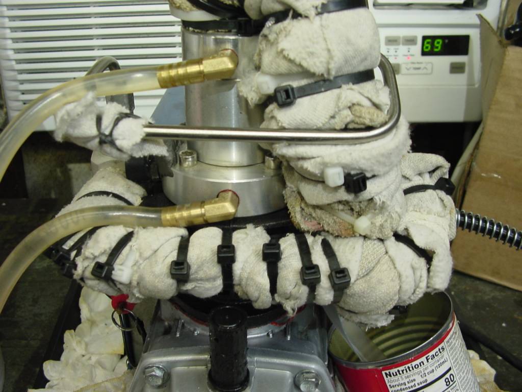

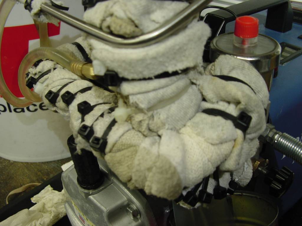

A good way to keep the little Y.H. cool in extended fills. It never gets above 48c while filling an 88 cf bottle from 3400 to 4300 psi. Material is multi layers of ole sweat shirt cut into strips and wrapped on the air lines and wet wit distilled water. I play to mix a little redline water wetter or royal purple ice in the water.

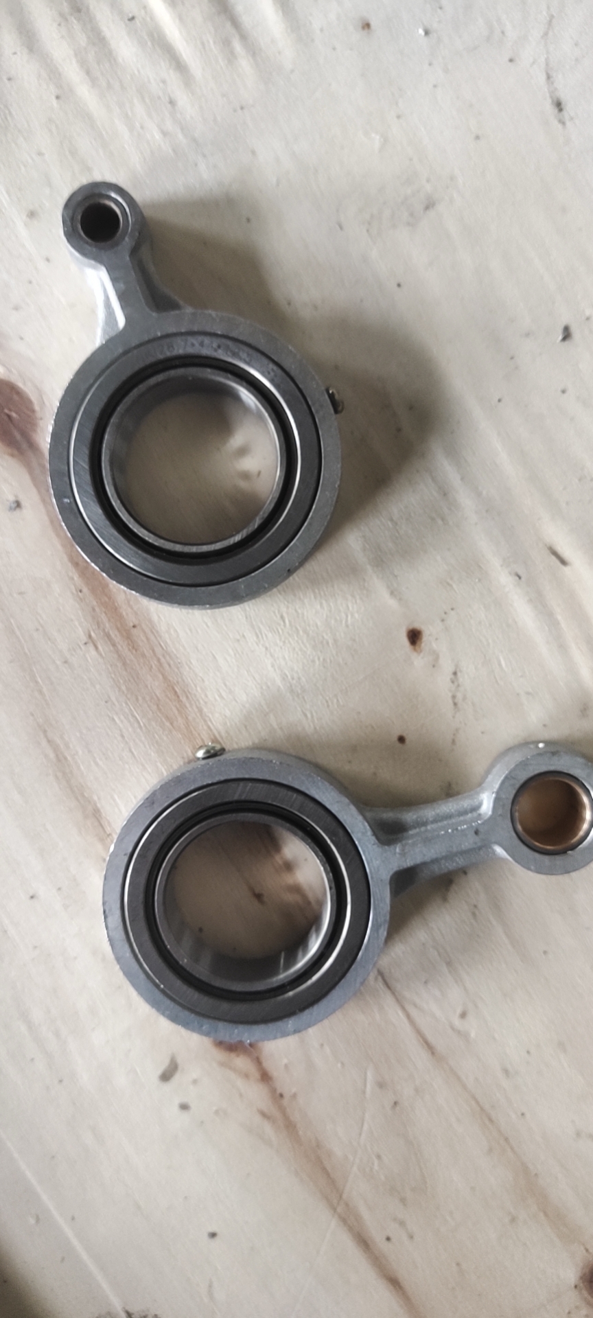

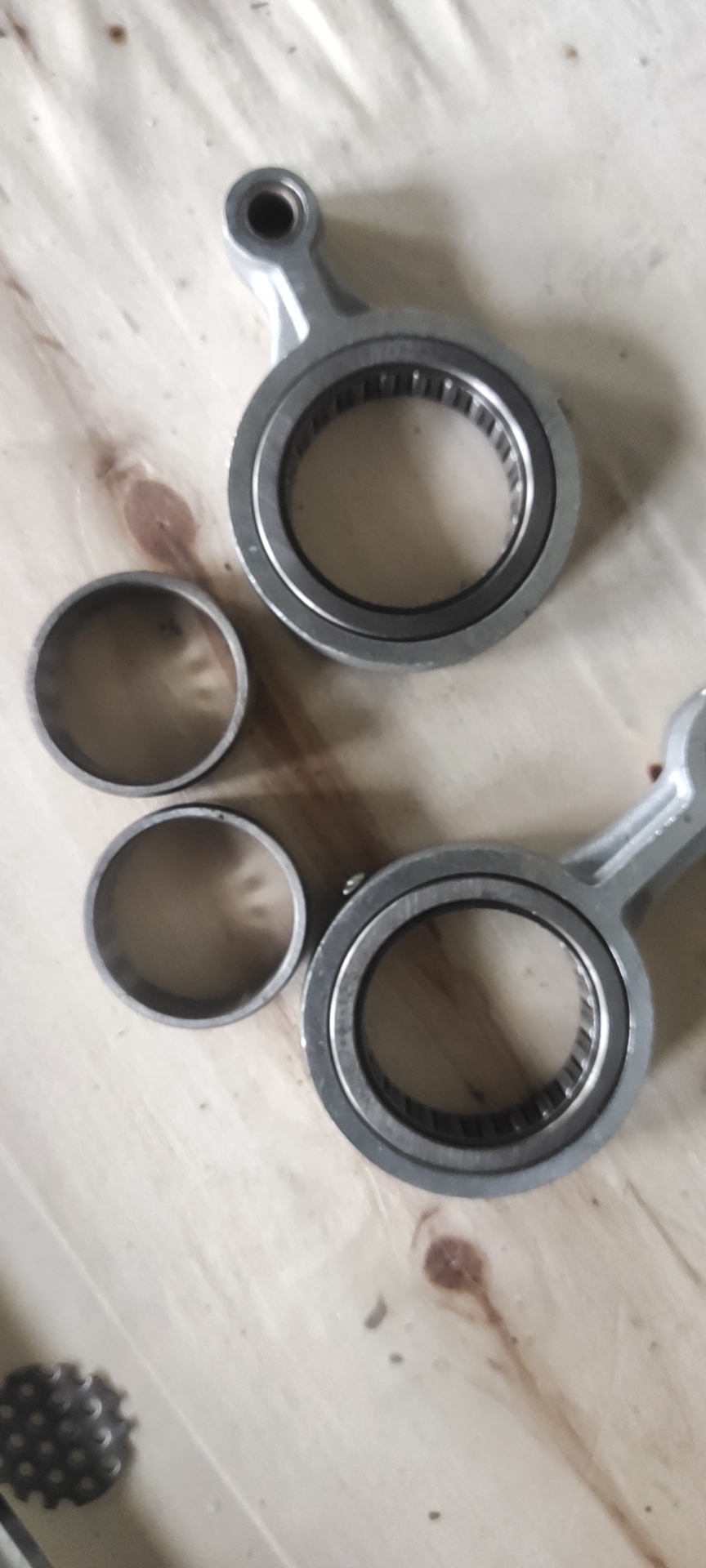

Thurman was able to get full info on it, as we both wanted to know if it had crank to rod bearings as virtually no Chinese compressors made for our uses do.
He was able to find out this week. It took a while due to Chinese New year. Woo-Hoo, It does!!!
Not only bearing on the rod end, gut a bronze bearing on the rod to piston end. But it goes further than that. It has actual caged roller bearings on the crank to rod end. Not like auto Babbitt bearings, but rather think high rpm, high performance motor cycle or F-1 race engine tech.
It is a full blown dive compressor, and is certified. 4 stages, 3.5 cfm.
I will try and post a few pics of what it looks like. you will notice that the rod is extremely short. We Hot Rodders know well that short stroke makes for a high reving, near bullet proof lower end. At the low rpm this unit operates at, it should live a very long life.

View attachment H27fcbd33b8684e7b8ec8a741aee7ae9dm.1614878491.jpgView attachment H78de976f330147588ad8e0ac3b2571523.1614878532.jpgView attachment H214c19043ebc4d87a5c54a643893667fS.1614878546.jpgView attachment H20b20cb4db3144409f4047717cfbcdd26.1614878563.jpgView attachment H45dd203a037e49759b09bb7e19b06f8cy.1614878611.jpgView attachment Ha00b61695a0645ac8f12d7f16c7356a5z.1614878634.jpg
