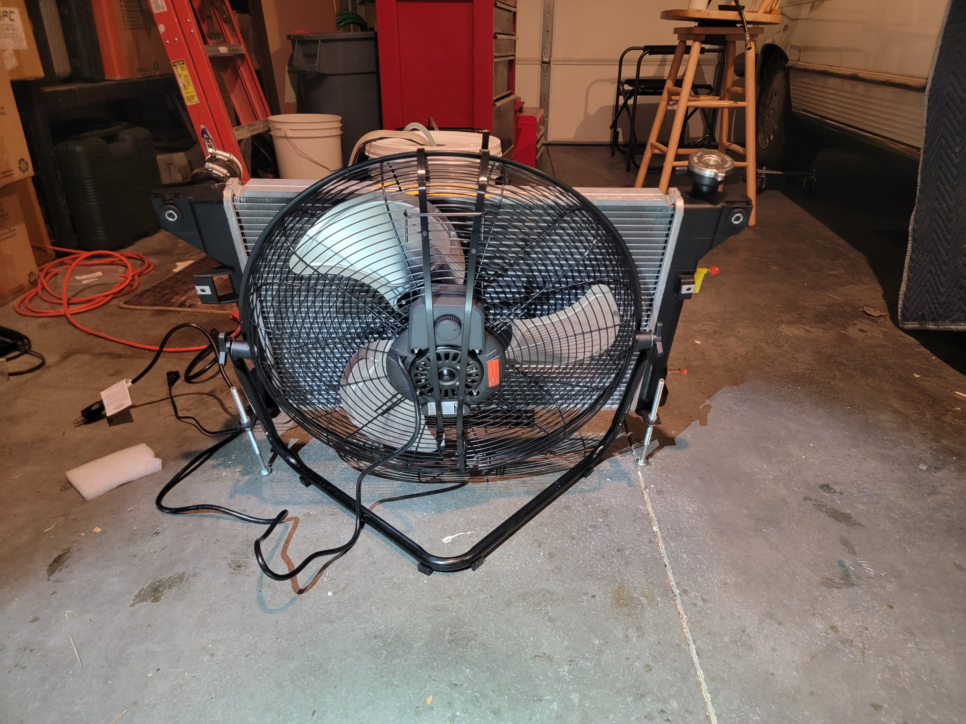

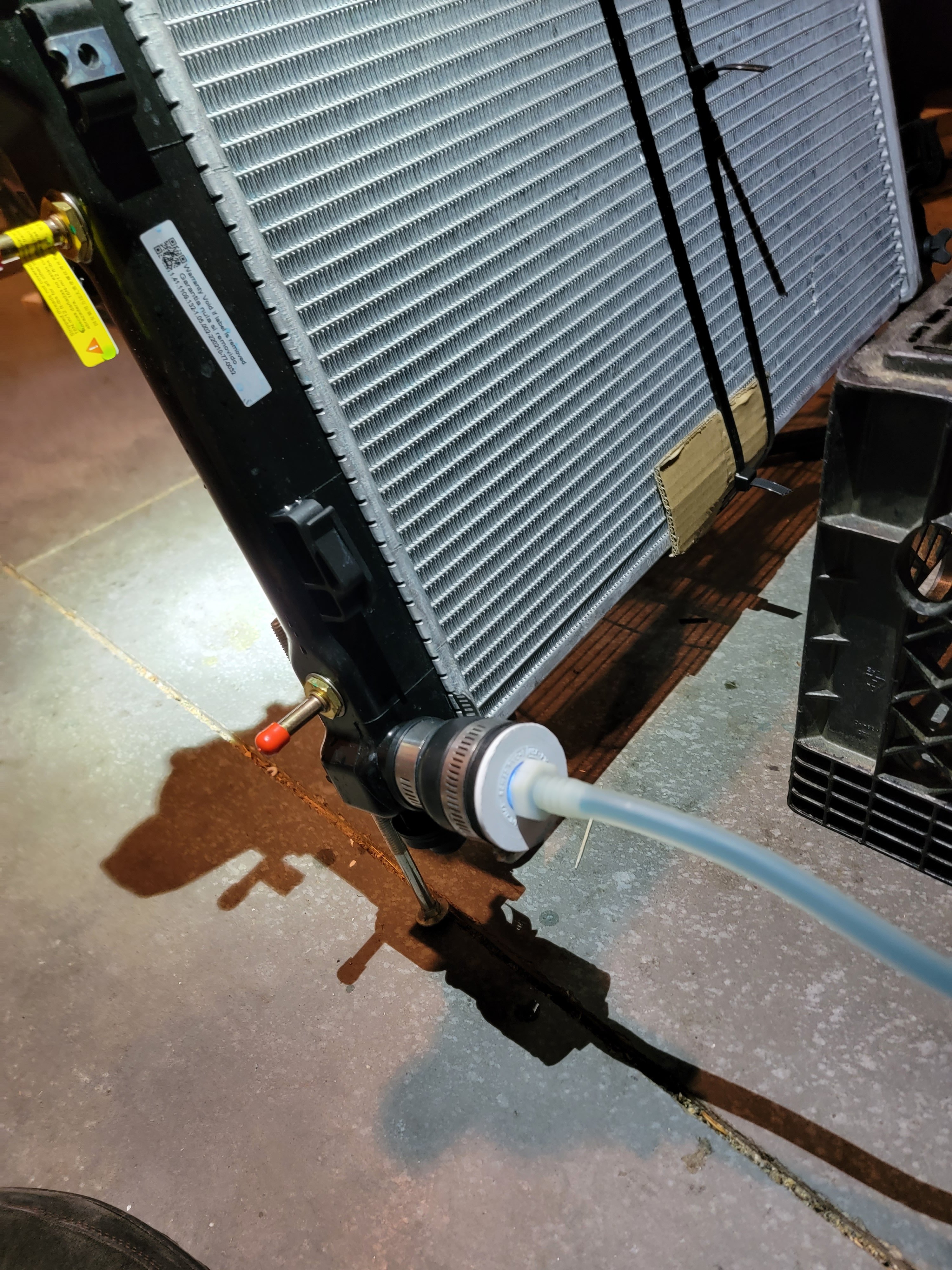

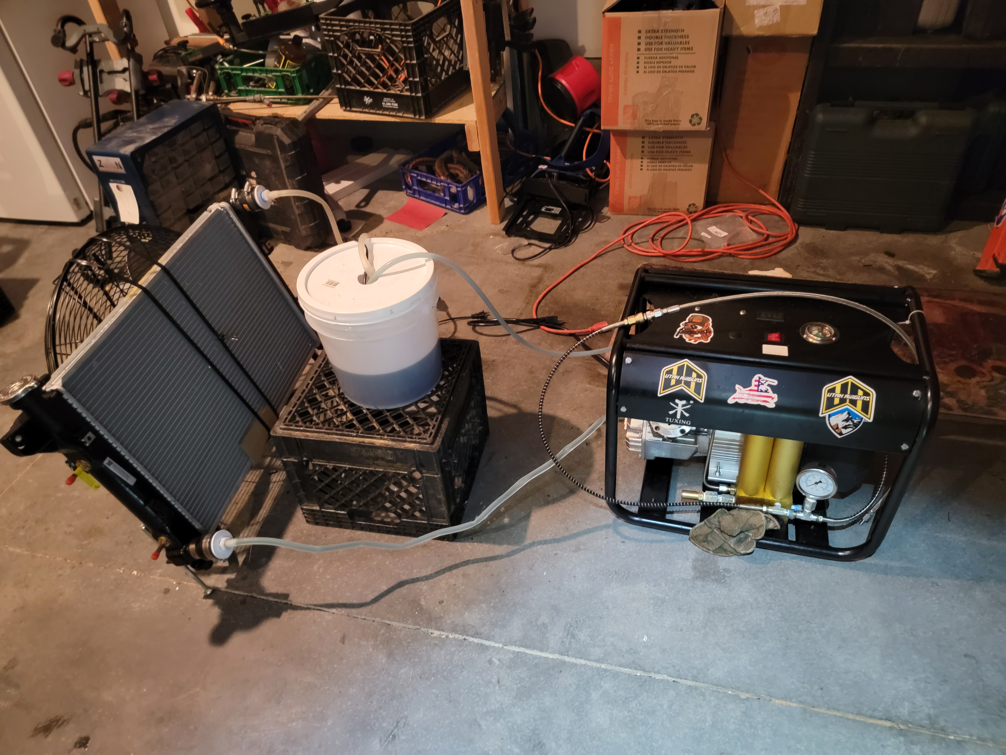

I looked at tranny coolers and heater cores and the radiator was about $20 more. We talked about fabricating a bracket and mounting to the compressor frame but...When we held the core up to the fan it seemed pretty obvious that attaching the core to the fan shroud was the way to go. The results far exceed the expectations. Cost of this cooling system, right at $200.
Price check. Direct from Tuxing, the TXEDM042 is $550 right now. The TXEDT032, same compressor with the integrated liquid cooling system is $799. Still a little bit more expensive then the cost of the 42 + $200, but a complete working out of the box solution. But damn, you will not get any thermal issues with this radiator for sure!

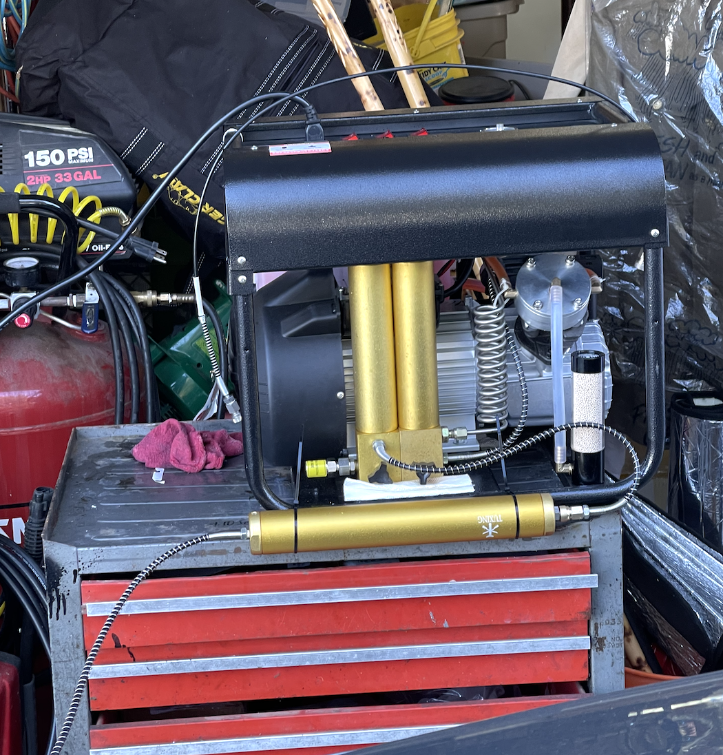

I’m considering buying one - looks like $430 direct from Tuxing, $500 from Amazon. Mixed reviews on Amazon. How are your compressors holding up?
Hit and miss. Typical chinese assemble and shipping problems. If you are mechanical probably fine. After my last rebuild txedt32 working well enough. Tuxing has been sending the wrong parts for the rebuild. Looks like they are focused on supporting the 1500 scuba compressor.
