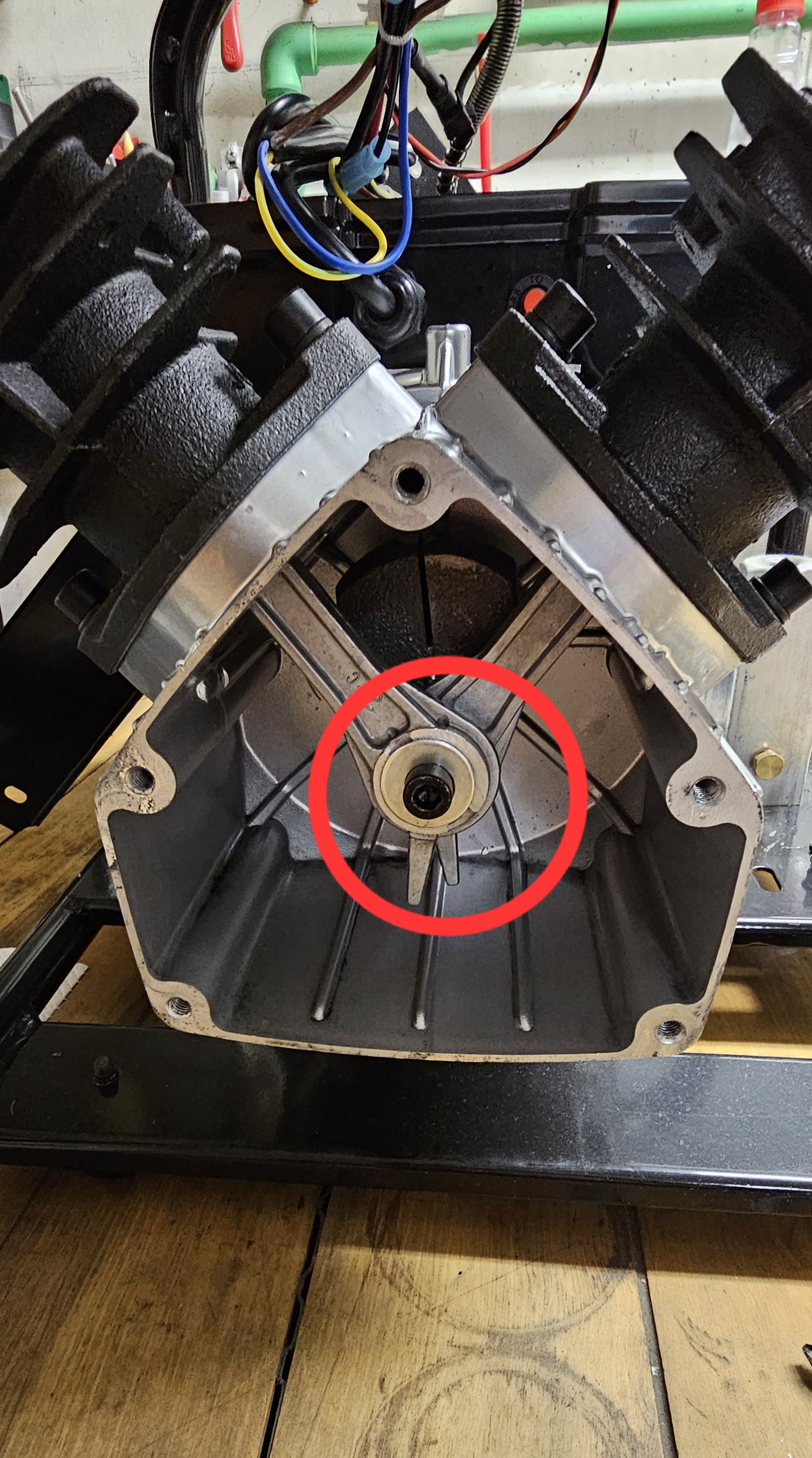

Hi all!
Does anyone know how to loosen and remove the screw on on the Tuxing double cylinder compressor that attaches piston rods to the flywheel?
One circled in red:
It's really tight and, of course, everything is spinning making things even harder.
Thank you!

Found an allen key with a longer arm, a bit smaller hammer and it finally broke loose.
Yes, it's a left hand thread.
Thank you all!
I thought that I'll avoid taking the cylinders off but in order to take the piston rods off the flywheel, those had to come off too.

I left the rods in place and just changed pistons. Remove cylinders then access c-clips on pistons to remove dowel pins holding themin place.

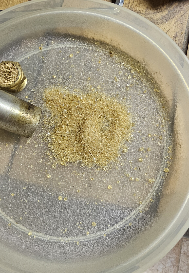

Most interesting thing that I have found inside was in the splitter block (aluminium block from where HP air goes to pressure gauge, filling hose, burst disk, bleeder valve)
In that block there is one last final desiccant filter.
It's been pulverised from the pressure

When I've bought it, I also bought the intake filter with those brownish drying pellets
So, for those not to absorb moisture when not in use, I have 3D printed a nice tight cap
One day I went to top up 6.8L bottle, connected everything and let it do it's job.
After a while I have noticed that it's filling the bottle way to slow.
Everything was ok, no leaks so i thought maybe some of the o-rings or seals inside went wrong but since it was slowly building up pressure I let it work thinking "I need this bottle tomorrow, I'll deal with it some other day."
Only later when I was storing the compressor to it's place have I realised what a stupid thing have I done!
It worked under vacuum the whole filling session!
I guess that it took the air pass the piston rings and the small amount it could through 3D printed cap
Since it created vacuum on the intake, it sucked all the dust and particles from those brown pellets
After that, compressed air that was coming out of it smelled terribly.
Aftermath:
- dust from those brown drying pellets went into every corner inside the cylinders, pipes, all the filters, stuck to every surface.
- I've changed all the seals, o-rings, piston rings because these is no way to know which is damaged and which is not (whole set is not exactly cheap)
- I had to dump all air from 6.8L and 14L bottles which I now need to fill from 0
- I had to buy new oil also and where I live that is 46€ per litre (quart is about 0.94 of a litre)
