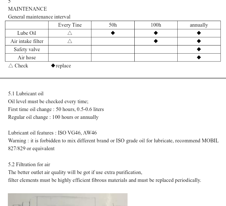

Air bubbles or "Whipped" oil is rare and if it does happen and oil can not re-level it self ? ... the froth will still retain a more translucent color of the oil itself & Not be whiteAt this point, you have several possible explanations. Water or Air bubbles, being that it is also clearing up, when you switched oils did you take the cover off and clean off the residue from the prior oil?
