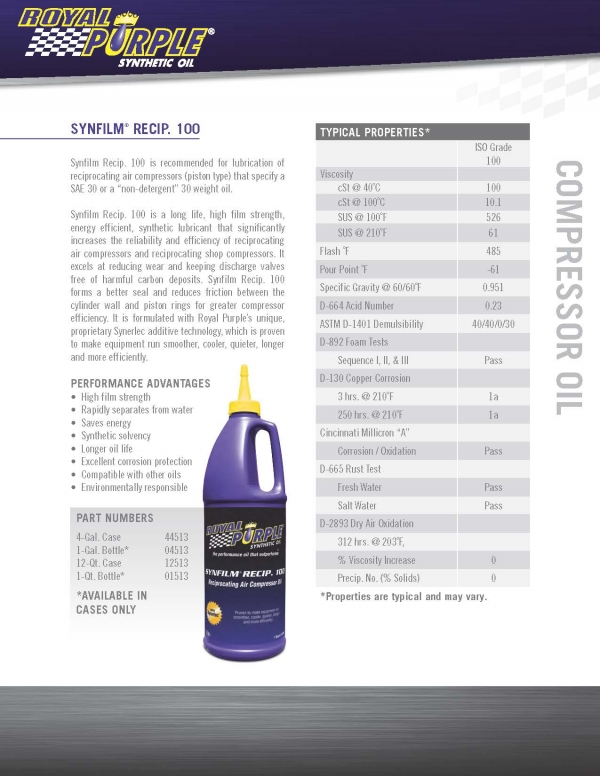

Decided to use Royal Purple synthetic compressor oil in the Tuxing two cylinder HPAC. I only ran the unit for about 15 minutes unloaded and about 20 minutes loaded (filling tanks) on Wednesday, and things seem good to go so far. FYI, ISO grade 100 oil is equivalent to SAE 30 weight motor oil viscosity.
