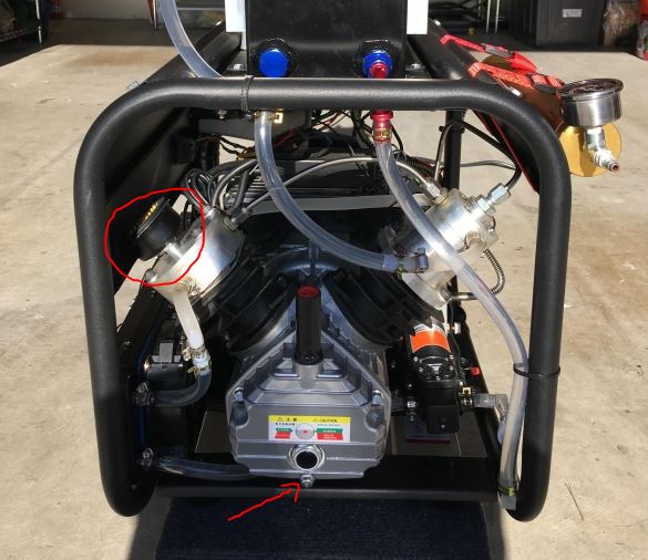

Hello Mike,
May I have some questions about your setup. I bought a Tuxing compressor from the bay with auto shut off feature but mine came with no drain bolt. I noticed yours has one right below the oil level screen. So to do the oil change i have to remove the cover plate? I emailed the seller (txfactory) but i think i may have better response here.
Here is mine:
Compares to yours:
And where did you get that intake air filter? (circled in red). Is an adapter needed to screw it in?
One last question: How and when to purge? Purge with the bleed valve or using the bolt beside it?
Thank you for sharing your experience and Have a good labor day.
1. Purge with bleed valve on the outlet valve block. Once every ten minutes is fine...
2. Inlet filter was bought off eBay. It wouldn't fit with the cap on so as you can see I use it with the cap off and a strong rubber band holding the filter in the can. No adaptor needed.
https://ebay.us/YFqDl1
3. Weird about the drain plug. I think you can also just unscrew the sight glass and drain through that. Tilt the compressor forward to get all the oil out...
Mike

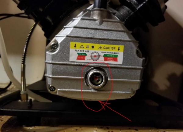

Hello Mike,
Here is mine:
Compares to yours:
If you look closely at the oil window frame you will see it is hex shaped and is there to allow a socket wrench to fit over it to remove it and drain the oil. After the oil drains, tilt the compressor over toward the open plug to get all of the oil out of the crankcase. I wouldn’t take the entire front plate off when it is so easy to take off the window/plug which is for that purpose.

Anyway, i inspected the glass screen screw and found that it requires a thin 1 inch socket plus looks like it's been glued in so removing the cover plate is my only option for now.

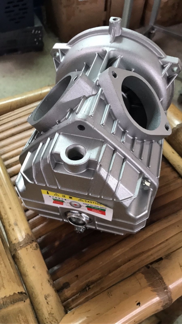

So i pushed the seller to send me a cover plate with drain bolt but they will send me a cover plate together with a crankcase!

@tutuan I think the front cover the factory sent to you 99% can fit your present compressor. (In order to make sure it can match, we can say that the crankcase almost as bonus for your future maintenance), you need not wait one more month. you can use the present front cover firstly. And the newly front cover will delivery to you about 2 weeks from China to US.
@tutuan This is no issue at all from my perspective and I am not surprised by the answer they gave you because I got exactly the same answer from Yong Heng when I asked them why the drain bolt is glued to the crankcase cover with silicone sealant. There should be an O-ring as there is obviously a groove for it.

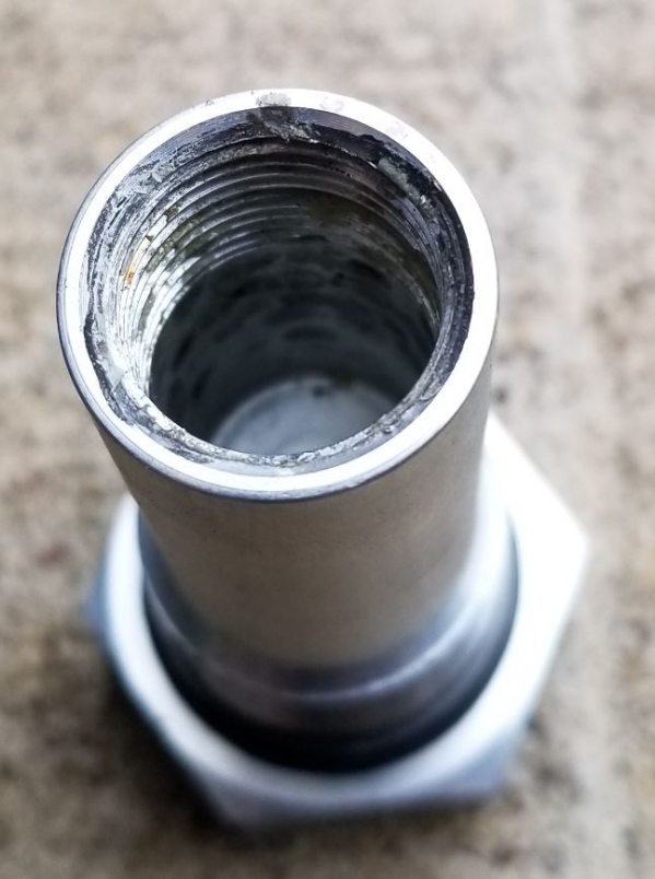

Thank you all for the support and advises. Last weekend i played with the compressor a bit: let it run unloaded for 20 minutes, opened the cover plate for the first oil change, disassembled the outlet valve block and the high pressure cylinder, then run it to fill up a 90 cubic inch tank to 4500 psi. And here is what i found:
The canister that holds silica gel inside the outlet valve block was rusted even not turned on yet. Filled it with the cotton filter per Mike's suggestion.
