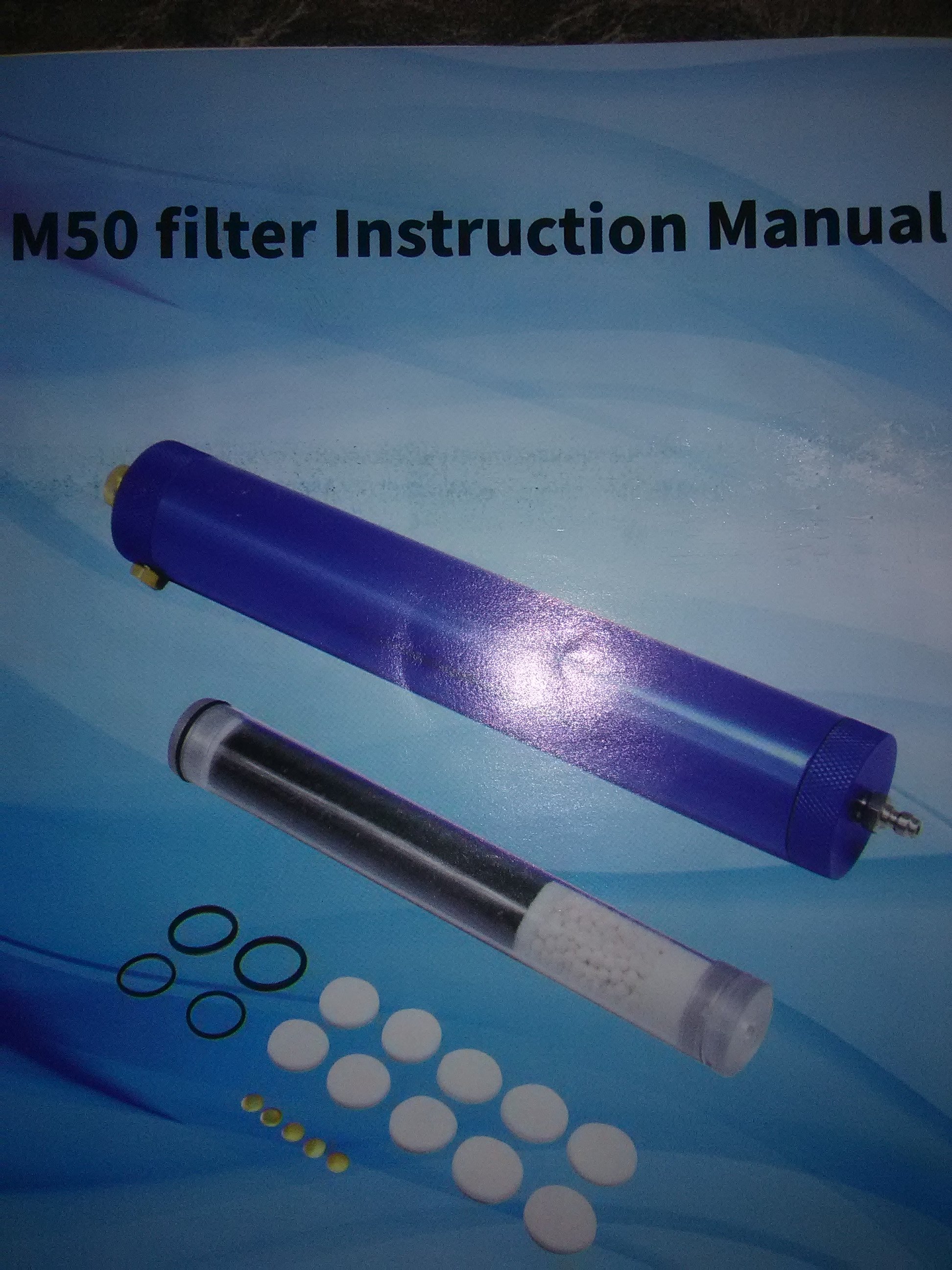

Nice set-up, I've heard mention of a spring-suspended base, this is the first I've seen. Think Blankshot17 called this correctly, re-inforcing could lead to a greater intensity catastrophe. The M50 filter, I'll include pic of Owner's Manual, has burst disc protection, which might be another way to approach this. WM

Can you suggest an inline burst disk?
