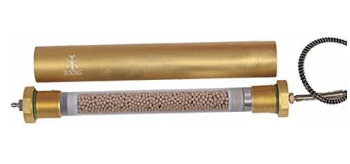

Hi all,
I know many of you use this Tuxing oil/water seperator:
Understood the filling should be replaced with better silica gel pearls. Can somebody advice on the best diameter for such pearls? Atm, i am looking at the one’s with a 2 to 5mm diameter. Should that be ok?
Thanks in advance!

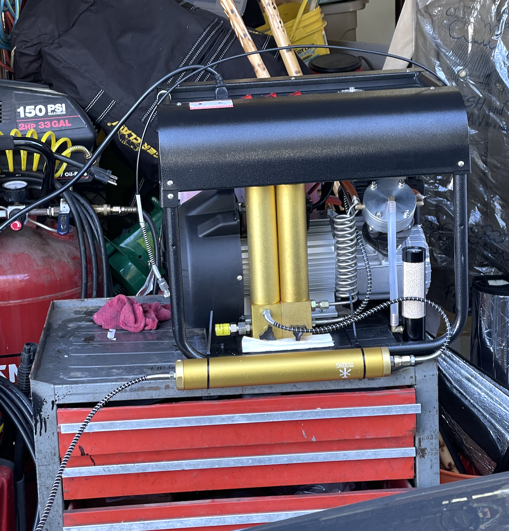

3A Molecular Sieve is what I use (https://www.amazon.com/dp/B09QGM9X7G?ref=nb_sb_ss_w_as-reorder-t1_ypp_rep_k0_1_18&amp&crid=24AE226W75R0Y&amp&sprefix=3a+molecular+sieve).
Or color changing (https://www.amazon.com/dp/B09QFJQQ7...colid=Z88MEFP49P53&psc=1&ref_=lv_ov_lig_dp_it)
ether one will do a good job.
I also made a DIY filter for my compressor's "Air Intake" which will help avoid corrosion inside compressor's air cylinder.

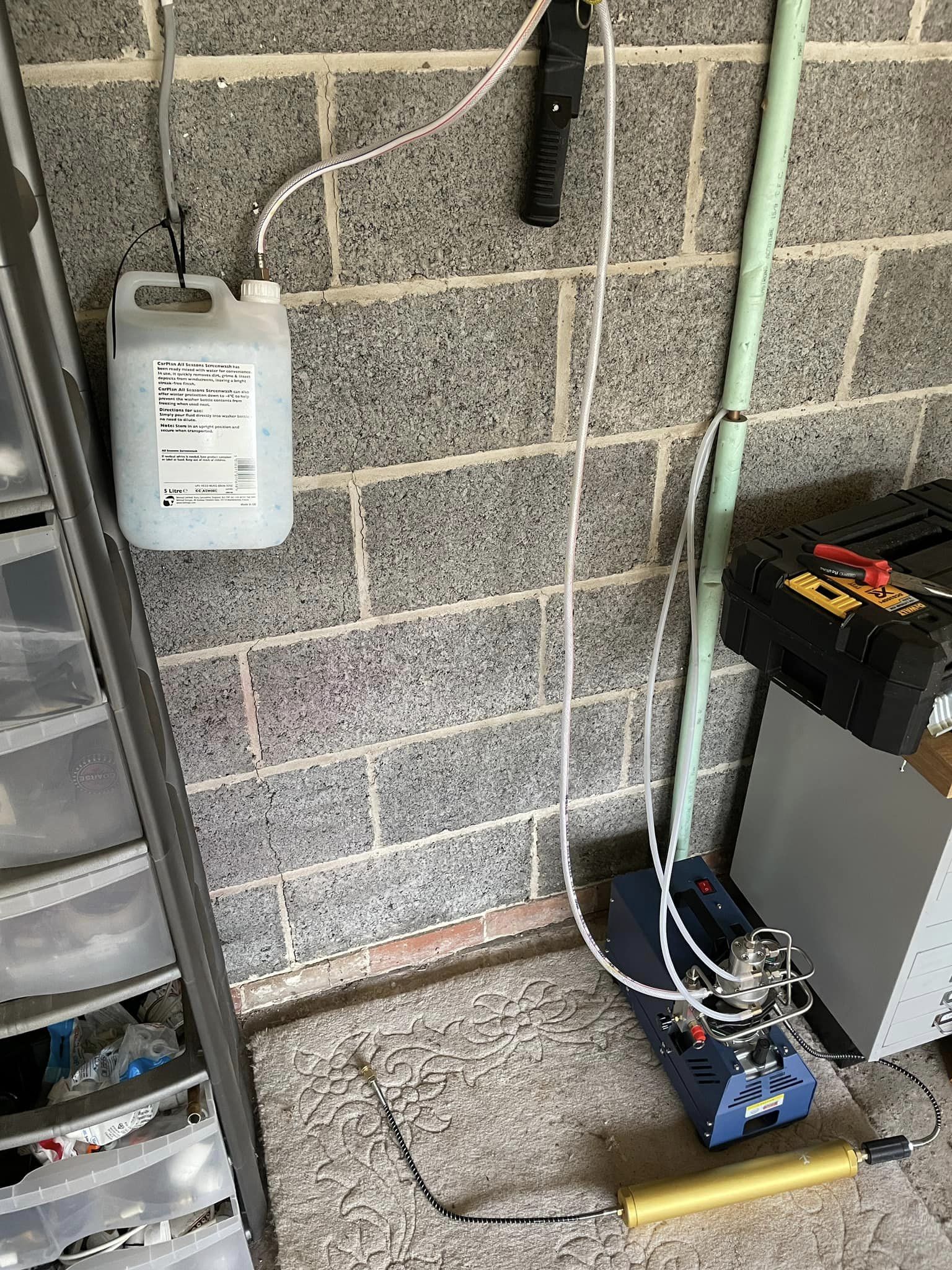

Had a lot of moisture in my gun after only a few compressor fills. Uk can be very damp. Got a Tuxing filter but am also trying a pre-drier. 1 Gallon if silica beads on the inlet. Yes it does have a filter before it gets to compressor. Cost almost nothing and will probably help a bit.
I know I have no moisture issue thanks to using a pre-drier and inline filter.
