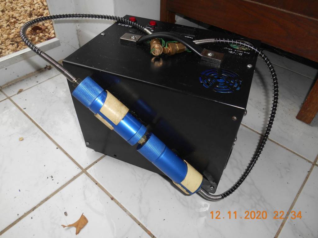

Sadly while filling a small (pistol 50cc) reservoir it got stucked at 150 bar for a while.
When I stopped, bleed it and started again, there was allmost no pressure built up anymore.

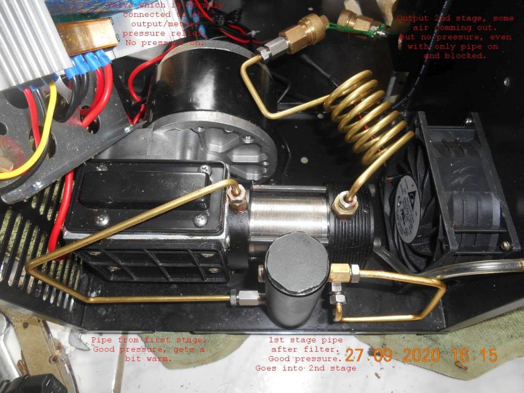

I checked everything for leaks and defects, but nothing special found, only a small pipe blockage on the tube from the low-pressure to high pressure cylinder, but didn't help much.
Replaced some stuff, no result.

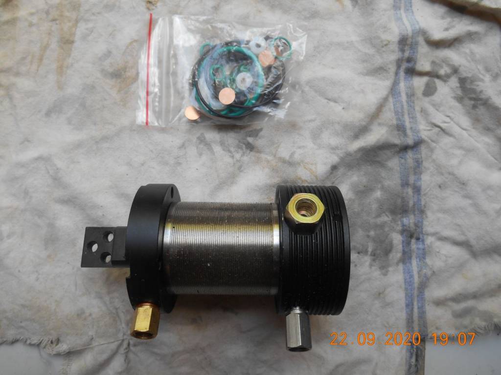

Ater tat I completely stripped the compressor and now replaced about everything wchich was in the extra ordered spare parts bag.
Again no result, first stage is building up some pressure which get's lost in the second stage.
Had some (good) contact with the seller, he offered to send a new cyl. head and some extra parts.
