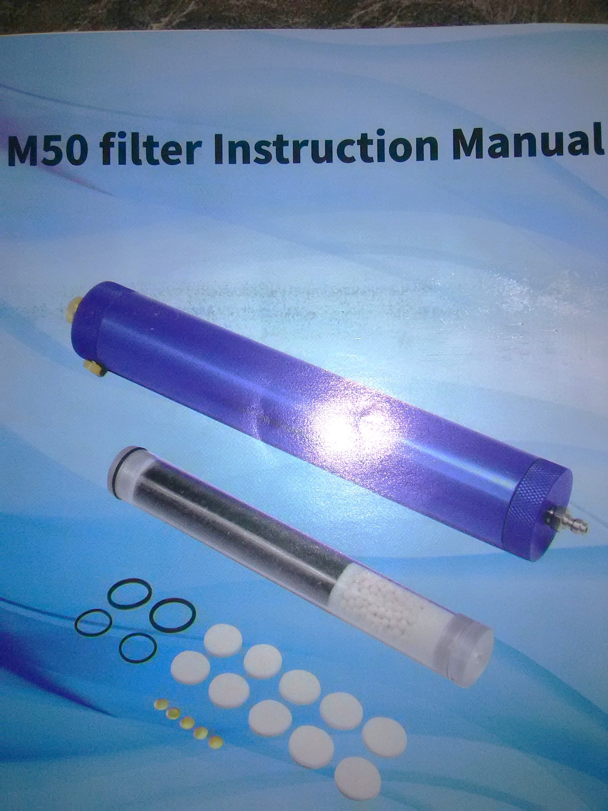

I was just looking over one of the smaller filters and noticed rough edges where the oring should seal, I bet that is where that one leakes :) I just use cotton in the small filters, the large I use a moisture asorbing sive bead.
Manual states inlet is male foster fitting, outlet (to gun or tank) female. Plastic insert should be positioned so desiccant beads towards inlet end, activated charcoal towards outlet. WM

In any of these Tuxing filters, the o-ring sealed end cap is always installed on the outlet side. The non-sealed end cap is always installed on the inlet.
The reason for this is the non-sealed end cap allows incoming air to "leak" into the space between the plastic cartridge and the inner walls of the pressure vessel. This assures that the air pressure is always equal on both the inside and the outside of the plastic cartridge.
One should never open a connected pressurized tank valve until the compressor has pressurized the filter to equal the pressure in the tank. If the filter is pressurized from the tank, the o-ring seal will not allow the air pressure to equalize on both the inside and outside of the plastic cartridge and likely cause the cartridge to fail.
When I received my Tuxing cartridge filter, the cartridge was configured such that the charcoal section was installed in the inlet side. It was a simple process to reverse the end caps and reinstall the cartridge in the pressure vessel.

Jack, Thanks, knew about one end being "O" ringed, never considered why. Now I know and makes sense. WM
