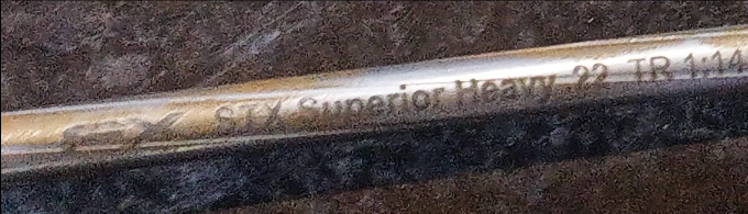

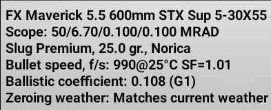

The barrel i am using is a 1:14 fx 800mm providing according to strelok a stability factor of 2 for the 40gr 2.66 for the 30gr and 3 for the 25gr.
My question is could this be related to any kind of instability created by overstabilization or is simply the slug being too light and be carried forward or backward by the wind?

My question is are you sure your 800mm FX barrel is 1:14????

I did not count the grooves but it is what was laser engraved on the liner.

Speaking of which, OMFG!!!! 1:14!!!!! that is so damn awesome! I so want one now! No wonder the slugger with 800mm barrel shot the heavy slugs sooooooooo nice!!!!

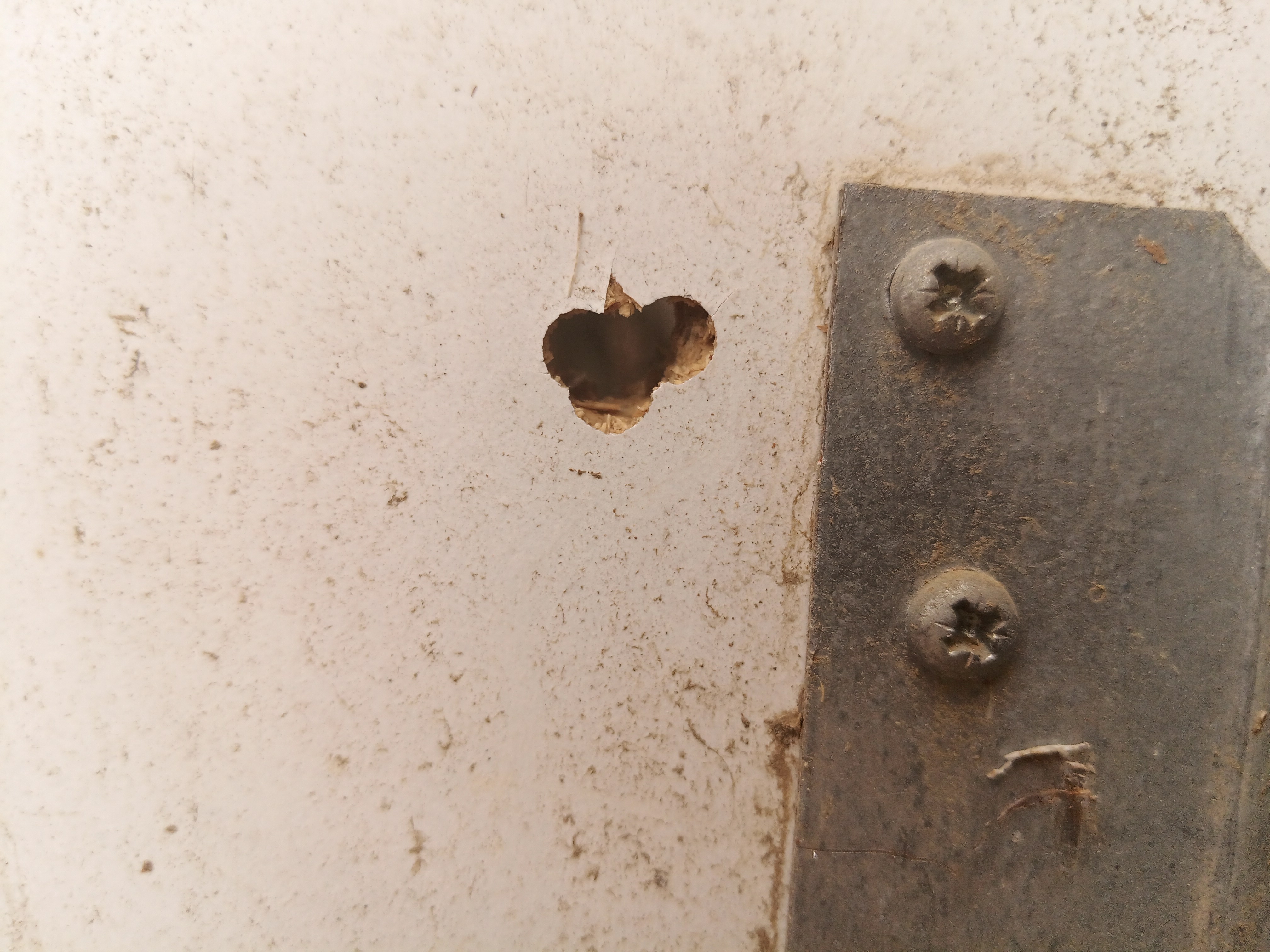

The minimum gyroscopic stability i could get away was with a pellet liner and tested to 300m accurately was with a 25gr slug measuring 7.9mm in lenght meanning a SF of around 1.
Target at 300m is the one below.
Anything heavier/longer tumbled spreading 2" groups from 50m.

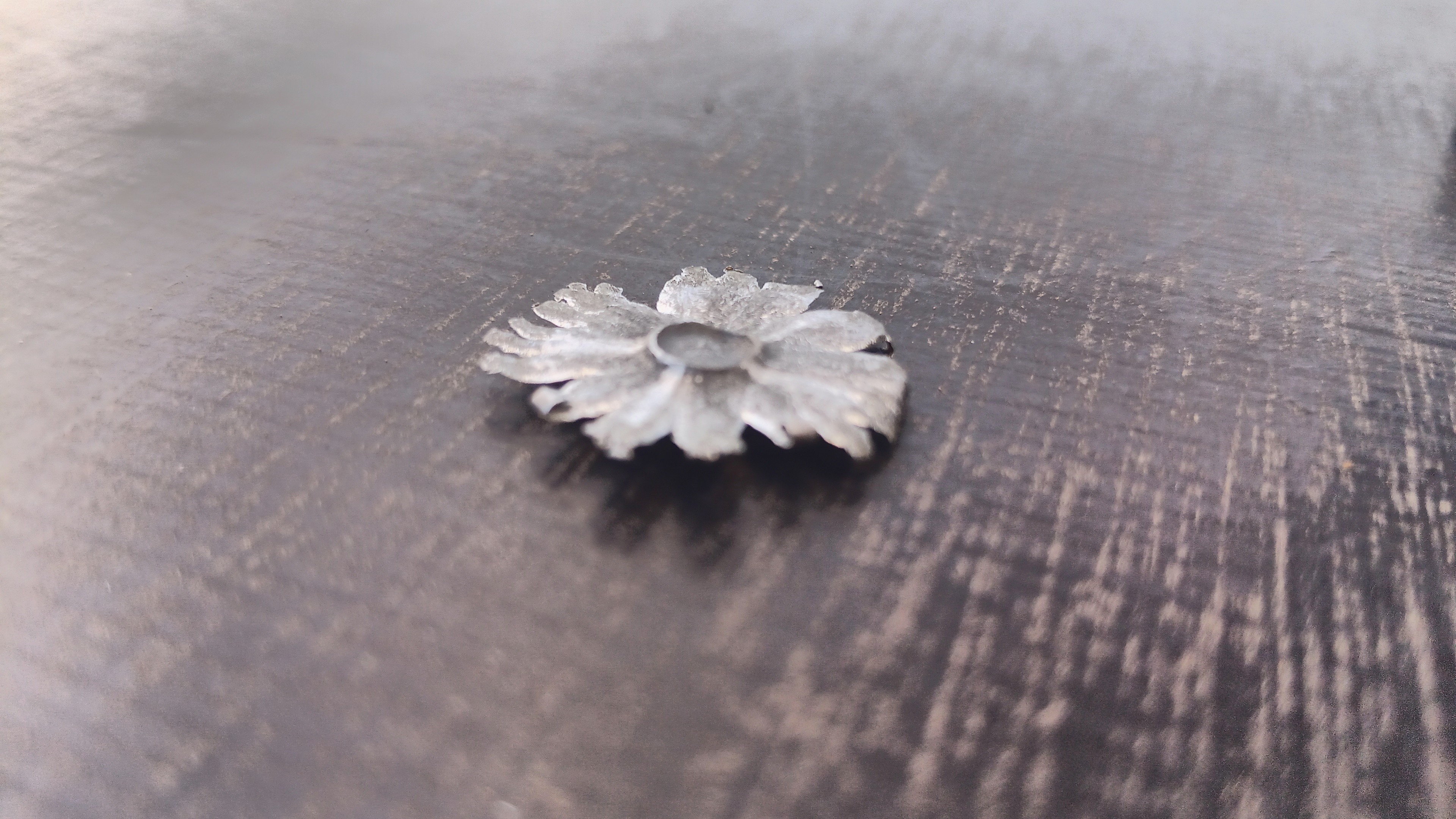

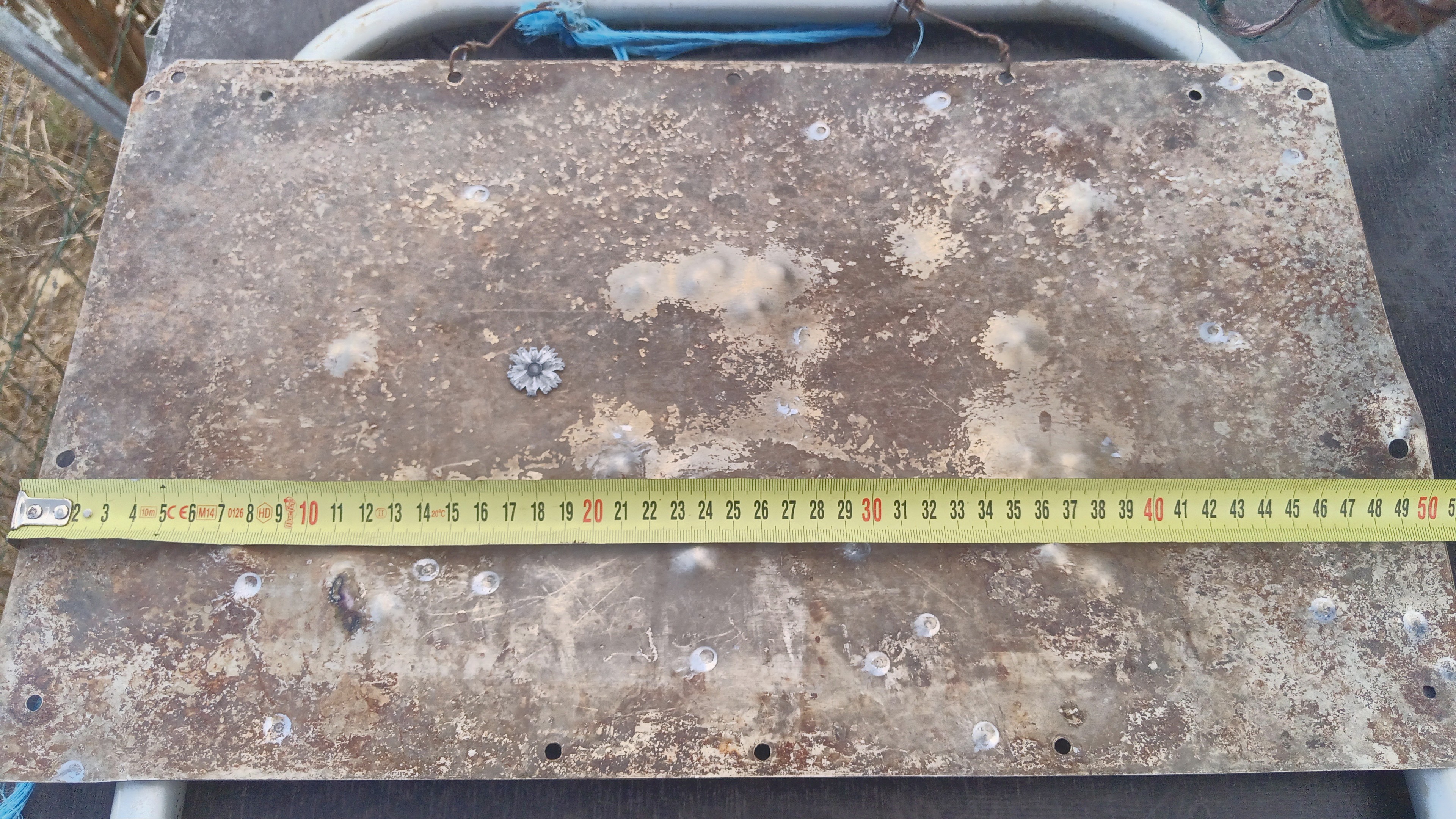

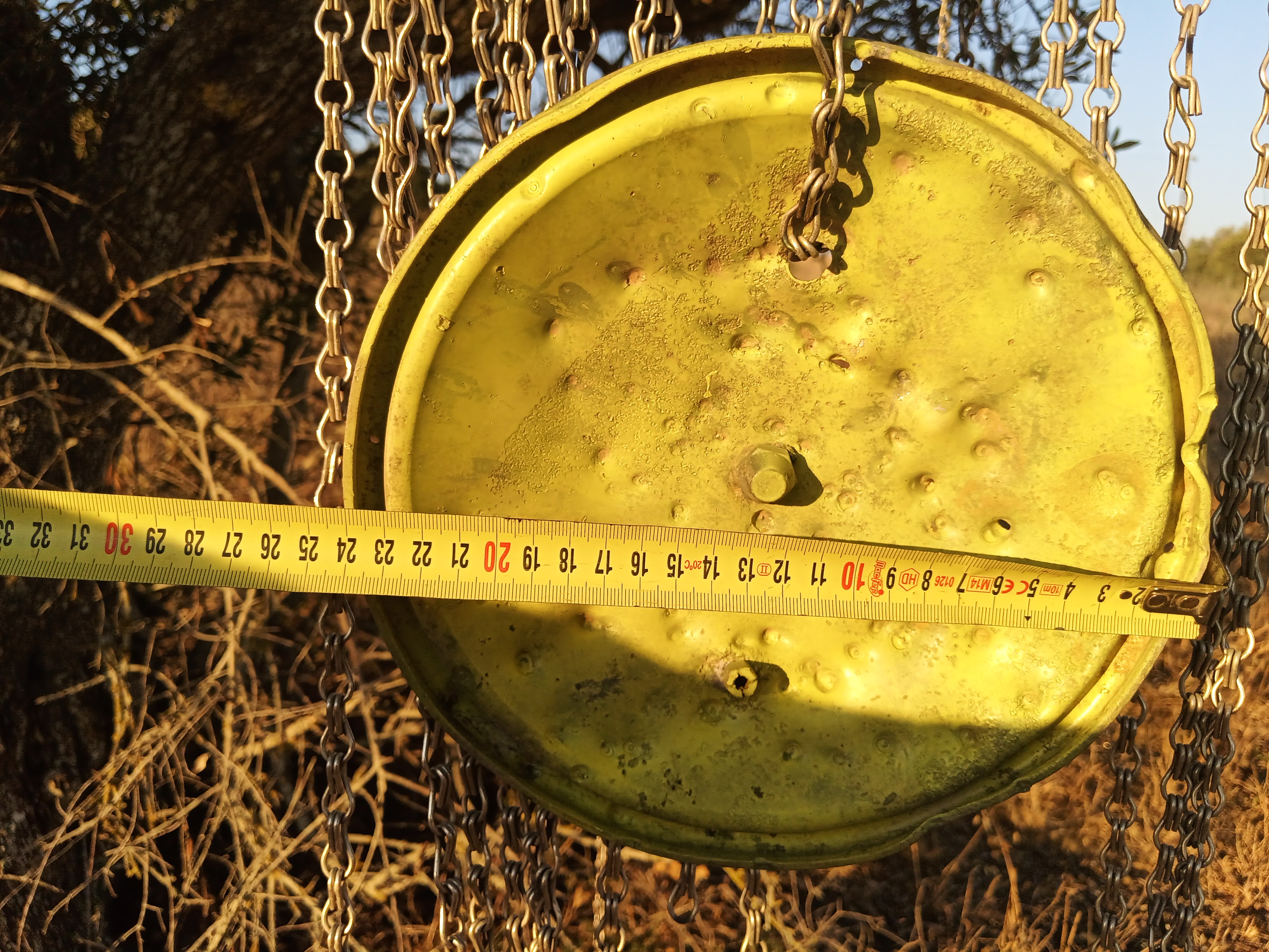

As for trajectory at 450m with zan 40gr i recovered yesterday one after it's impact on a stainless plate and its looking good to my eyes don't think it's out of alignment just yet.

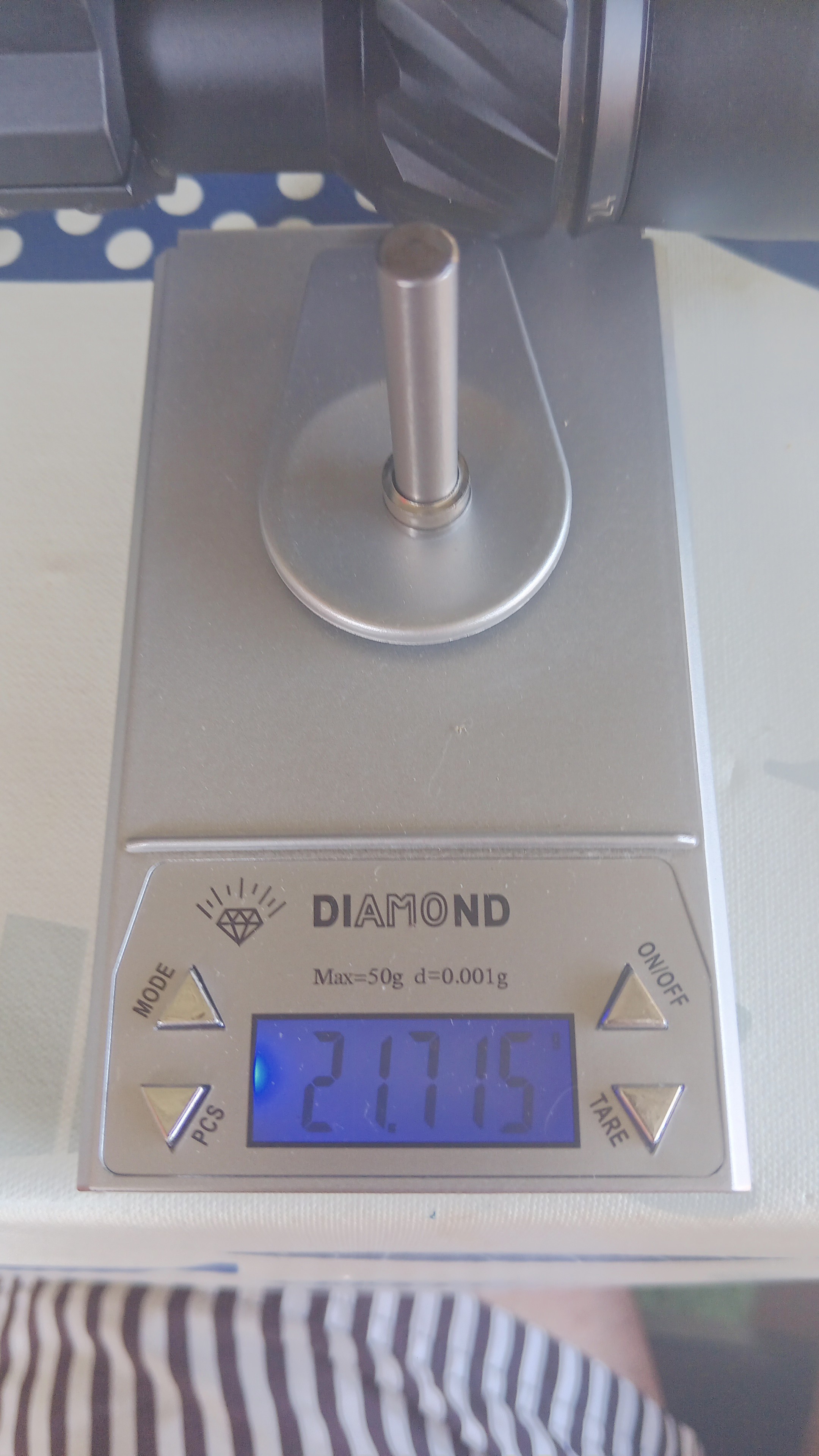

For the hammer i use a carbon tungsten made from grinding a piece from an tunsten endmill with stainless spacers for tuning along reg pressure just because i believe it's better a low speed/high energy hammer for harmonics and vibrations. I used it from 130 to 170bar up to 3 months now. Around 2000 rounds through it.
Warning still did not check the block for wear if overtravel is induced you can damage it!

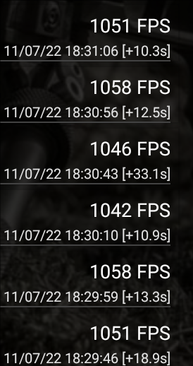

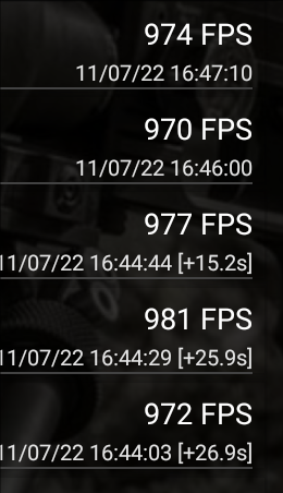

Ignoto, I just looked it up on my ballictic app. If you have an ES/extreme spread of 30 fps - that alone will account for almost 37 inches of vertical spread at 450Y. Add more if your gun is as precise as 1.5 moa at 100Y like most of the better airguns are. Even the BC of the 40 grainers is low compared to centerfires and on the low side compared to a 22rf because of the big hollow point as well as going 100 fps slower than standard velocity ammo. The BC of the 25 and 30 gr slugs must be .085 G1 or so, this low BC gets affected sideways by wind a lot as well as the vertical component. Those light slugs are really petering out at 450Y!

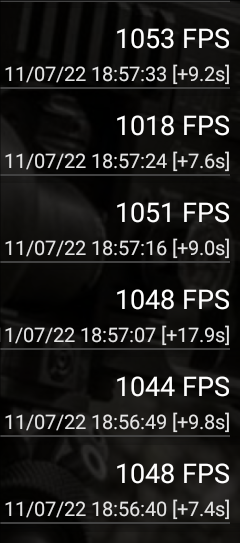

I though about the speed too and measured fps on shots sent and even tryed slowing them and speeding them up-same happened wich meant to me that it wasn't a speed thing.
