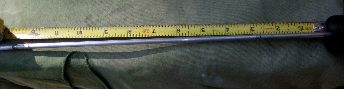

Just measure it yourself with a cleaning rod or somthing that will hold in the rifling and turn with ot as you push or pull .. put a dot and start line on the rod pull or push it until it rolls back to its start point then measure from the start line to the end of one full rotation and thats your twist rate. So if you pull 1/2 turn in 8 inch then it's a 1 in 16 .
Anyway i posyed my guns rate a few time at gta and fuzzy brain thinking back my gamo was 1 in 24 ?
I can easy go out in a few and recheck that from said above way.

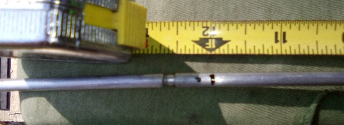

See.. 12 inch for 1/2 rotation.= 1-24 twist.. see i marked the rod with a start line and rotation index dot.
Anyway dont matter if it rotated a 1/4 ,1/8, 1/2. Just do the math for one whole full rotation.
Anyway dont matter if it rotated a 1/4 ,1/8, 1/2. Just do the math for one whole full rotation.View attachment 360039View attachment 360040

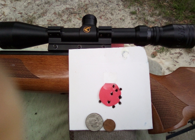

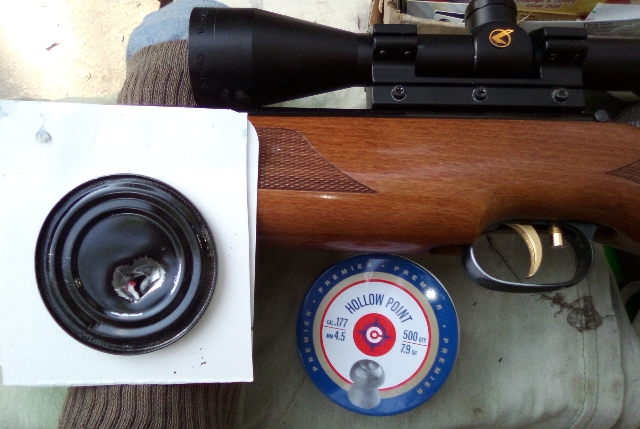

I got one good gamo package scope . Lol
It does fine.
View attachment 360129View attachment 360130
It does fine.
Does it like JSB exacts or you're only shooting these Crosmans through it?
My Big Cat/Varmint sure does, but poorly stabilizes JSB heavies, that's why I want to replace the barrel - and I'm going with a .22 this time, because I've got a bulk of .22 ammo, which was intended for that Hatsan 125 that I got last year. But the 125 only likes pellets that seal the bore well, pellets like the Baracuda 18, Norica Prometeus, H&N 21gr slugs in .218... but JSBs just don't give much power, and so I've got a bulk of .22 JSBs left, however I am surprised that they group rather well at 30 yards. Can't wait to try out some JSB heavies in .218, when I get them from a friend.
All i shoot 99.4276% of the time is cphp .177&.22. You could check my gamo group posts on the wfm1 irons and scoped using cphp .22. I post for the heck of it to post somthing here. I think thete post from 10m to 100y with it. Nothing spectacular just backyard fun shooting
