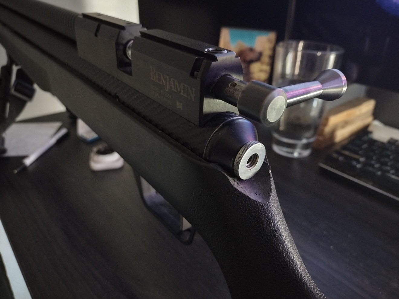

Hammer springs are strong in those rifles i am used to it is set up 70fpe so i added this to it so i can pull it back lol
This makes cocking easier:

I here you my friend i totally customized my hammer valve any everything out of 7075 aircraft aluminum but i chose to keep the bolt handle because i wanted the rifle look just added this now super easy lol

Trust try this super easy now

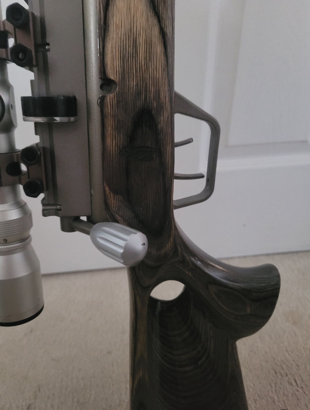

I find that gripping the bolt handle in as close to the axis of the bolt and resting my thumb on the AGR thumb rest is the best (other than a side lever conversion) and easiest way to cock. Thumb on the rest, two or three fingers on the bolt in as close as possible, squeeze my hand (like squeezing a rubber ball), no need to pull and honk back at all, just squeeze my hand until I hear the hammer and sear engage with a click.

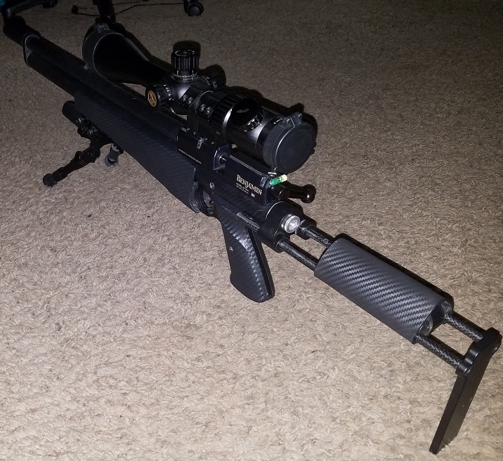

The best alternative to the above mentions in the thread to reduce cocking force in pcp's are side levers, which is something you may want to consider in your next gun. However with my mods, my marauder cocks even easier than a side lever gun, which is...extremely rare and a lot of work to obtain. Side levers reduce the cocking force generally at a 3:1 ratio, so a 9 lb/in spring would take 3 lbs of force to cock back 1 inch with a side lever, where as with bolt action it takes all 9 lbs.
-Matt

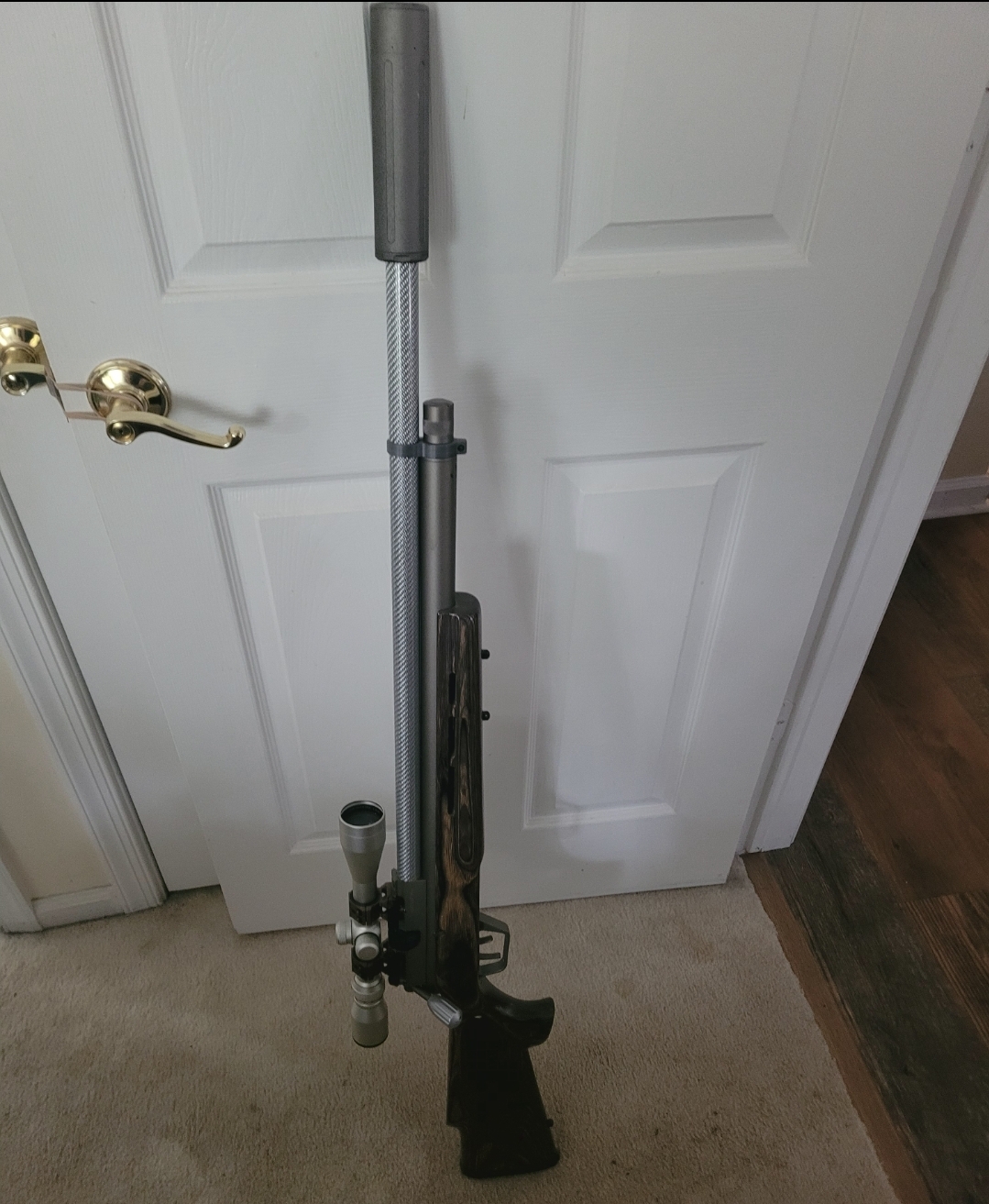

This is how I cock mine, I have a 5/8-18 plug installed in the rear plug that doubles as a thumb rest (on both the above gun and my marauder that uses a stock rear plug), I place my thumb on it and 1-2 fingers on the bolt, and squeeze, and with my gun only needing 2-3 lb hammer springs, this can be done with your pinky finger nail alone.

Might as well show the stock version plug too, just had to snap a picture. This plug provides quick access to the hammer spring/ssg without having to remove the breech bolts and stock. I wouldn't have it any other way personally hence why both guns are setup this way. Really convenient for changing calibers/tunes. The 5/8 plug has an internal hex that sets the gap for the ssg/spring.
