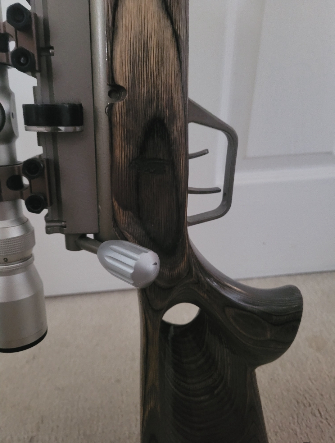

Not to harp on how much I like the AGR thumb rest, but what makes it so nice is that it sticks out behind the end cap about 3/4 of an inch and beyond the curve of the grip to allow my thumb to sit solidly on the rest. May or may not like the look but looks are not everything and the protruding rest works great!
That the rest protrudes rearward of the end cap and stock is what makes the grip length perfect for wrapping one or two fingers around the bolt handle in close to the bolt and the thumb on the rest and then just squeeze your hand, again, like squeezing a rubber ball.
