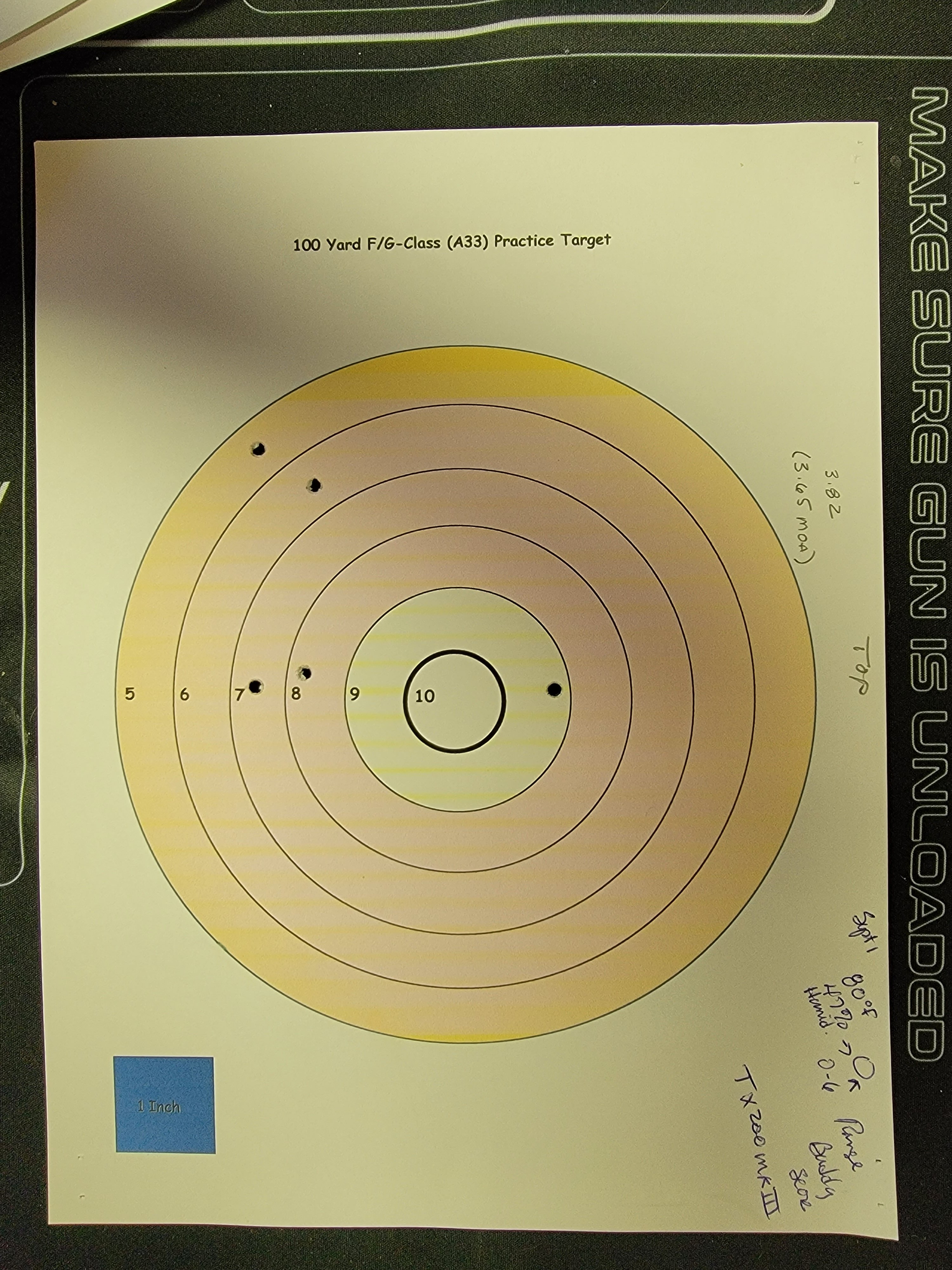

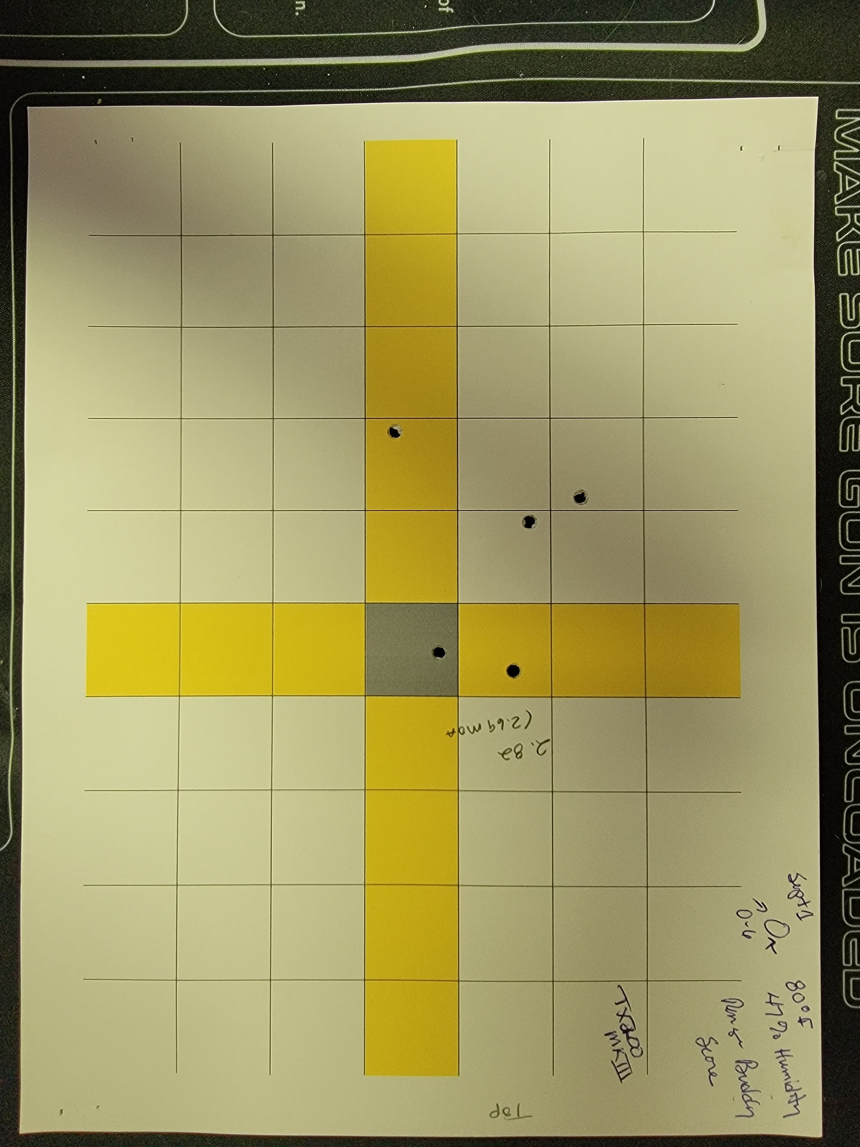

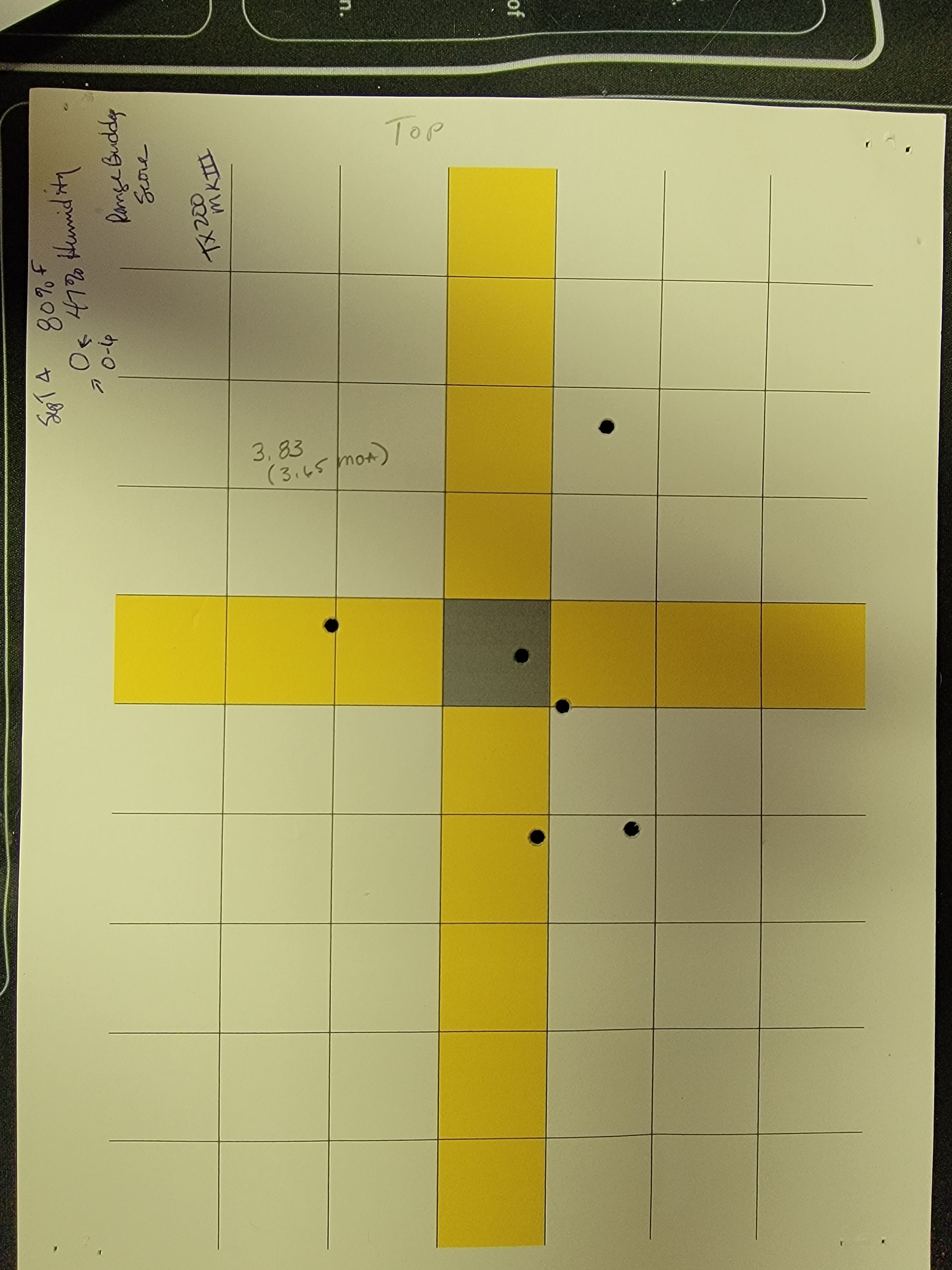

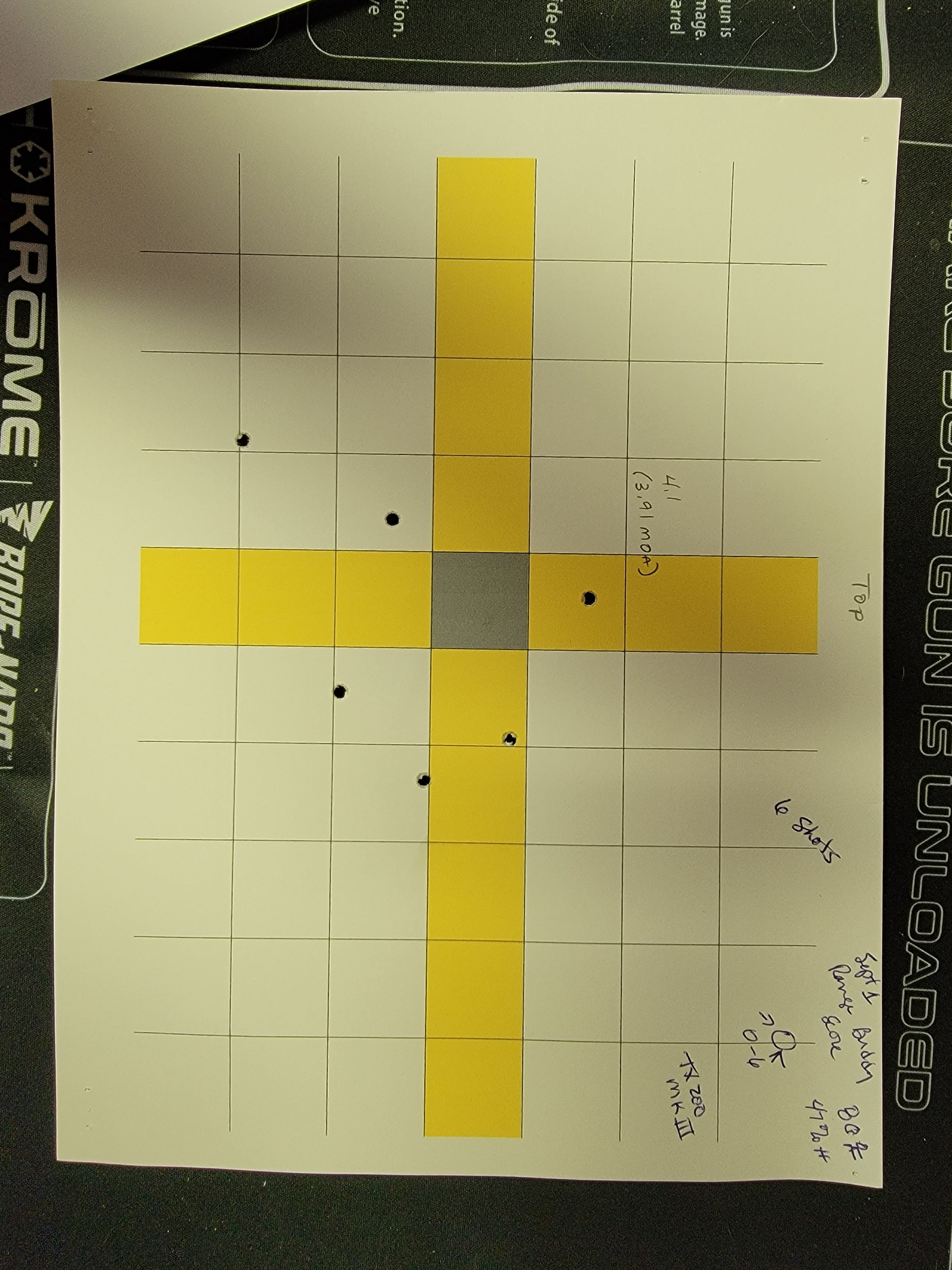

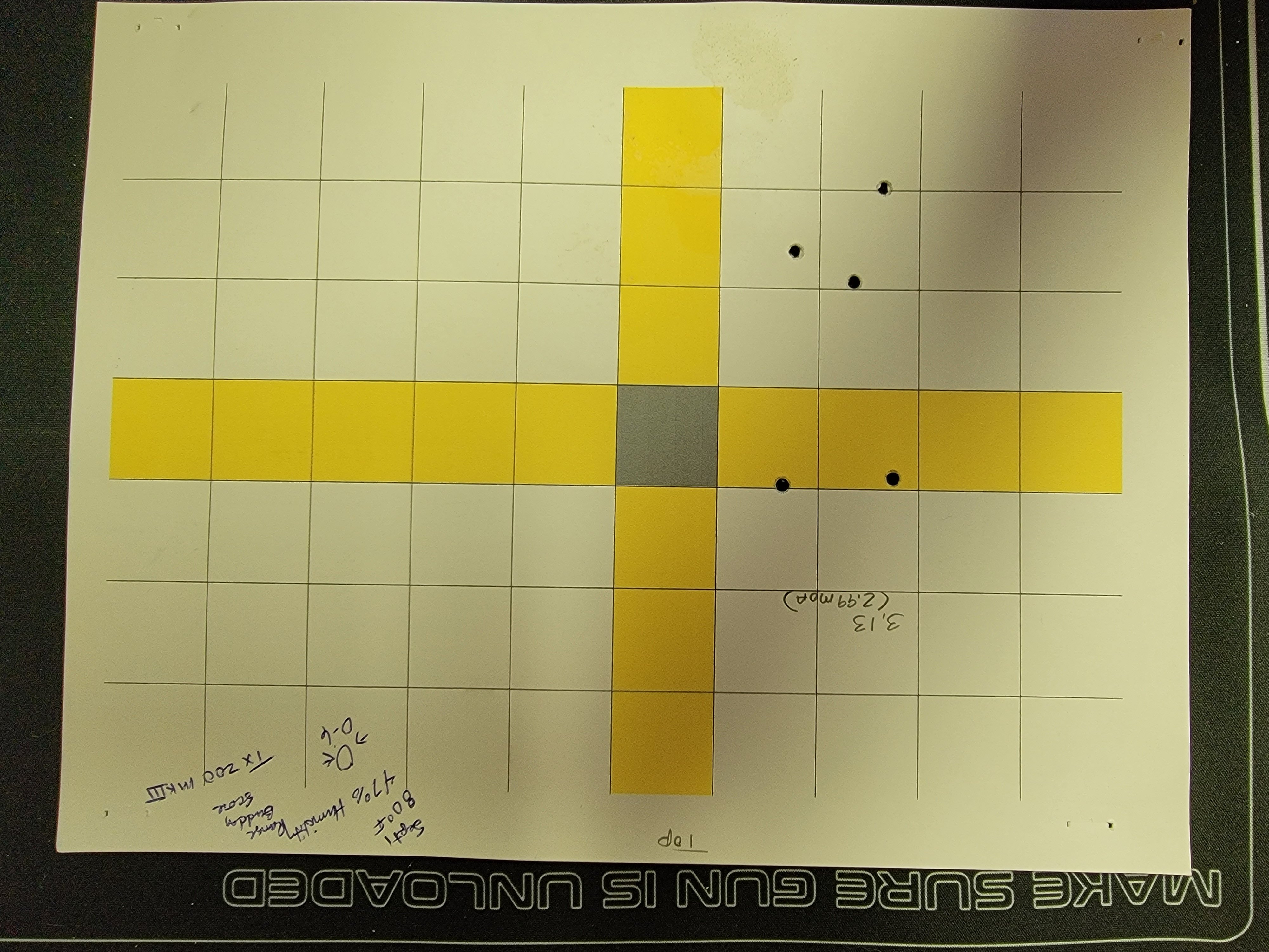

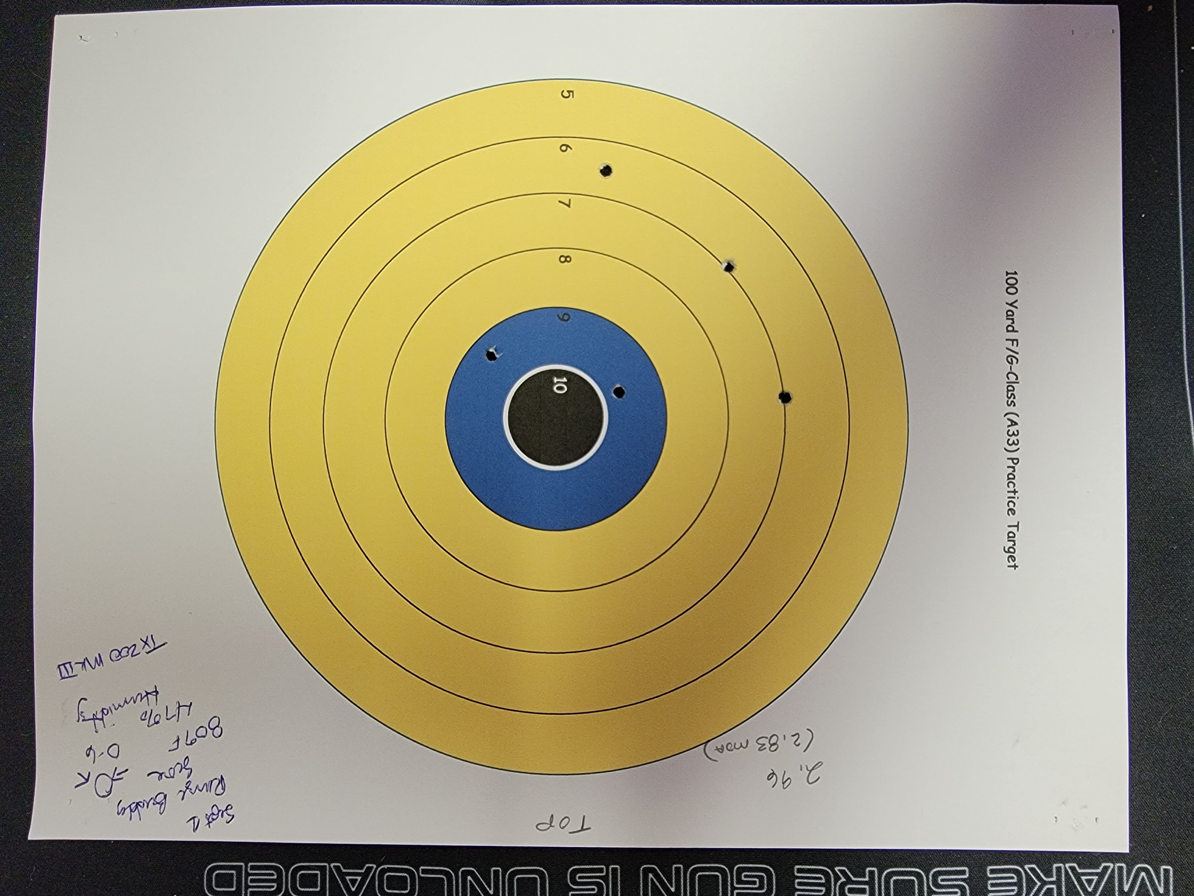

I had time to run to the range today so I shot the TX200 MKIII at 100 yards. As this was not a new thing for us, I set up and shot video of it as well. I knew the Zan 10gr slugs had consistently done well at 100 yards, staying around 3", so those were the main focus today. I shot 8 targets with 5 shots each from 100 yards. One of the 8 targets had 6 shots as I can’t count.
Groups ranges from 2.31" to 4.10" (6 shots). The average was 3.29 inches.
2.31
2.82
2.96
3.13
3.45
3.82
3.83
4.10
The video is being edited so should be ready in a few days.
